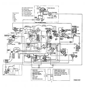

I have a vaccuum line that goes from my breather to ?
I'm not sure where it is supposed to go. Could you tell me where I am supposed to hook it up to and how to do it. I believe it is supposed to hook to the thermal switch but there seems to be no place to hook it to that. Please help me if you can. Thank You very much.

Hi There are two hoses on bottom of air cleaner one goes to hot air actuator on top snorkle the other goes to underside intake to a multi vacumn port. will attach diagram but will be small transfer to photo soph or similar and enlagre
https://images.2carpros.com/forum/automotive_pictures/198357_Graphic_518.jpg
Hope this helps Thanks for donate
