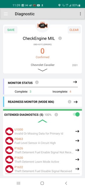

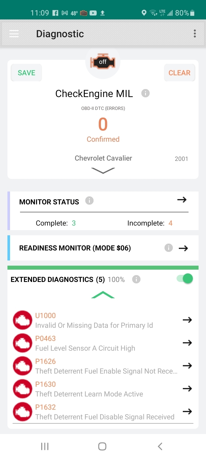

Codes u1000, p1630, p1626, p1632
151,834 MILES • 2.2L • 4 CYL • 2WD • AUTOMATIC
WOODBOB690
  • 28 POSTS

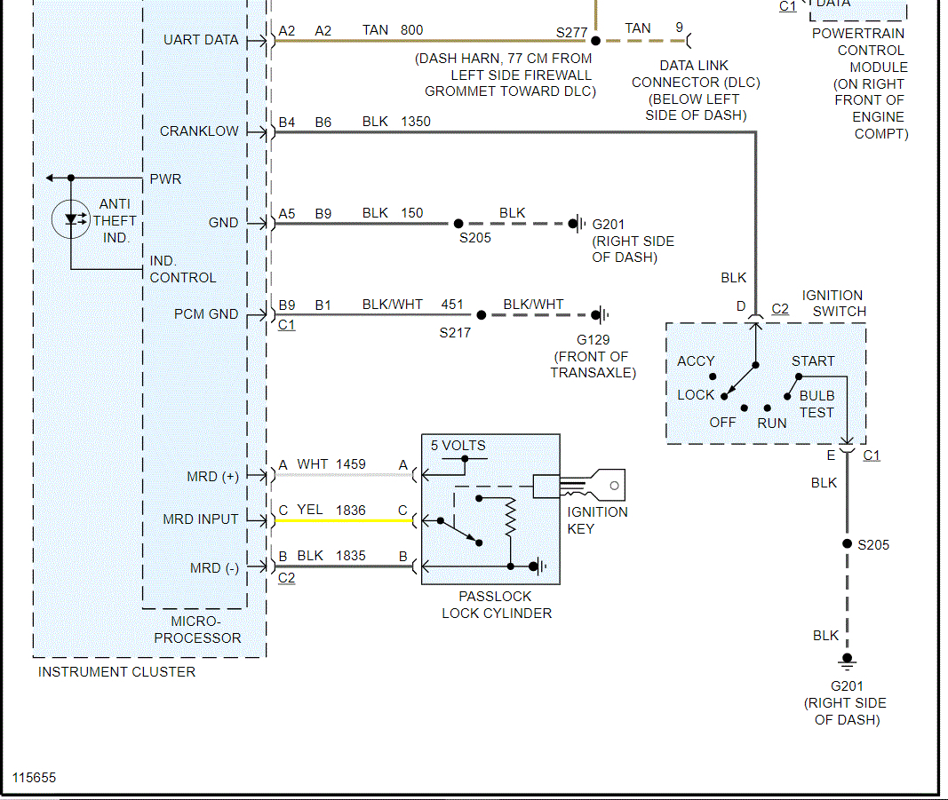

So I am having a problem with the theft deterrent system. I have tried to reset it with no good result. Here's the thing I swapped engine from a 3 speed to a 4 speed with the wiring harness for under the hood the system was bypassed on my computer but this one is not. How would I bypass it again when I have already bypassed it once?

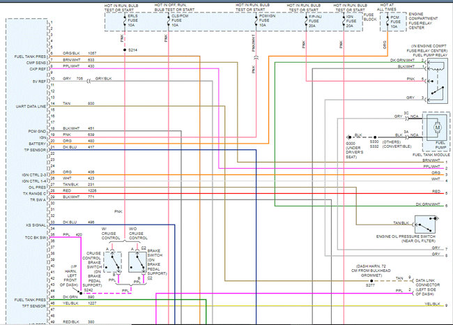

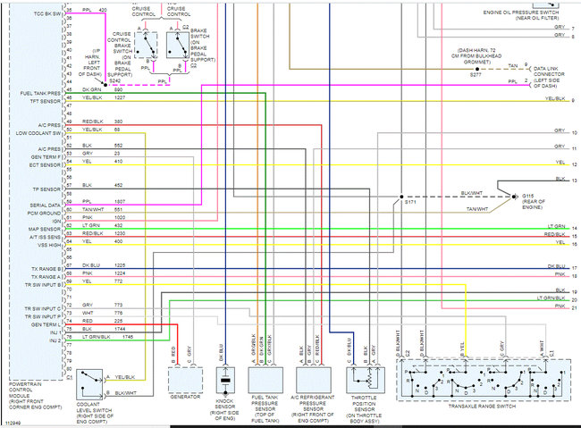

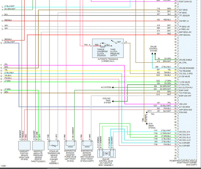

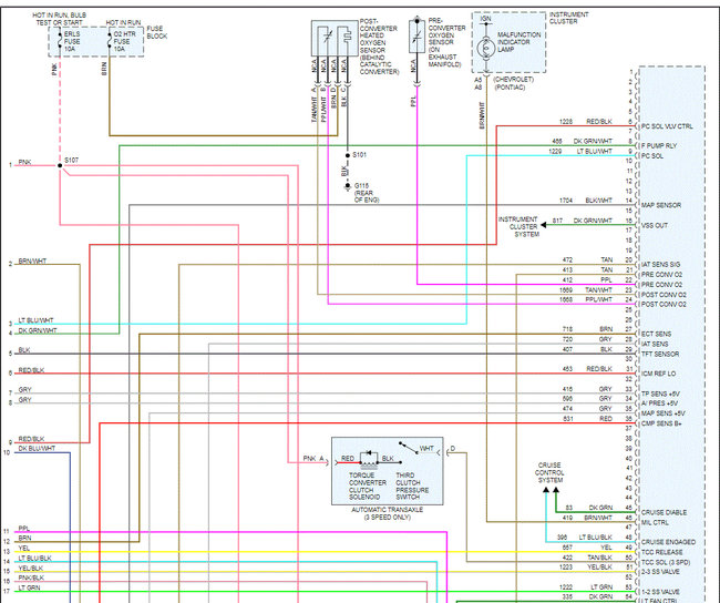

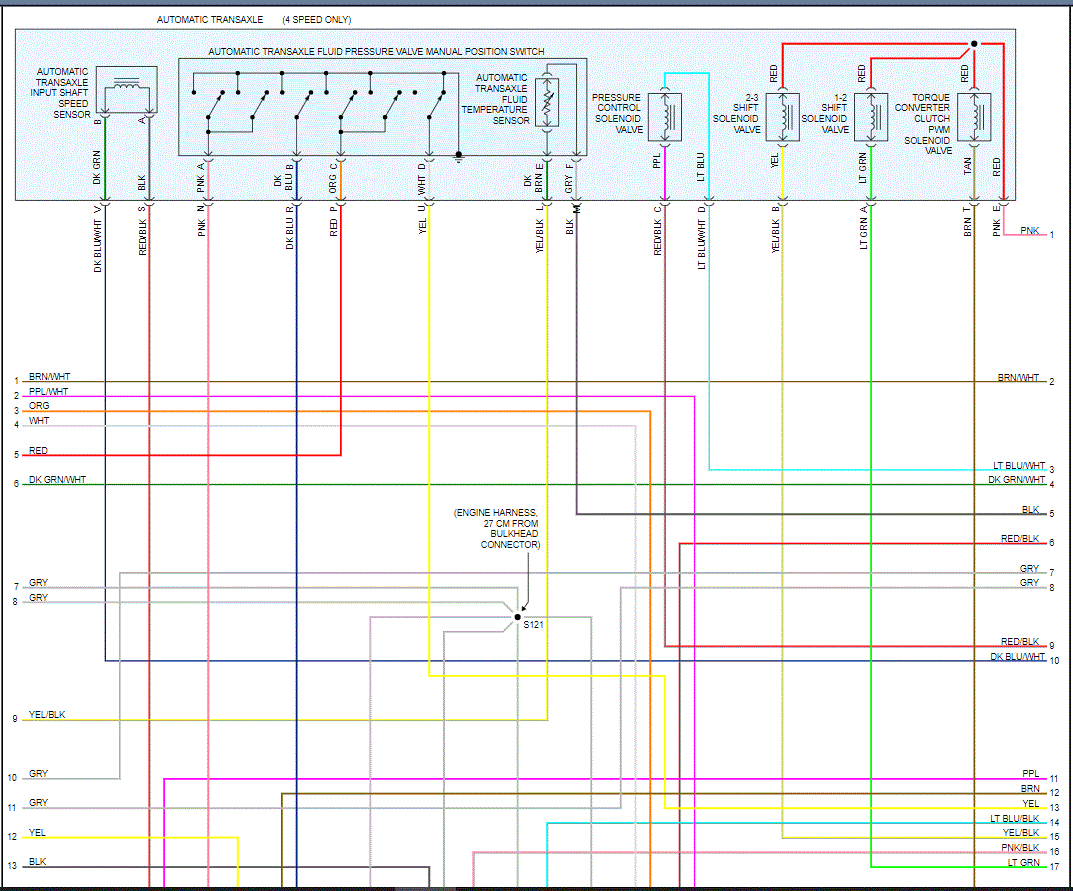

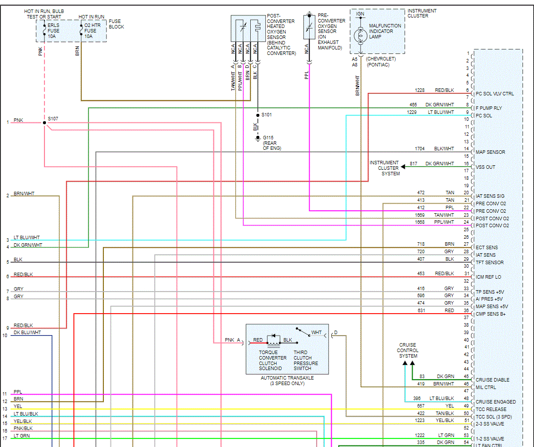

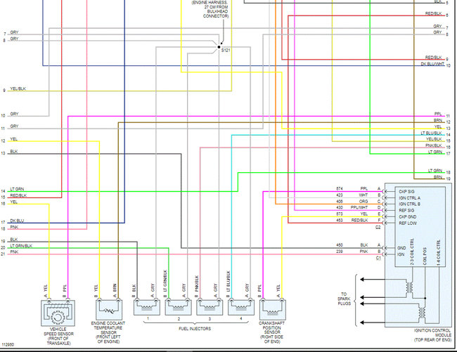

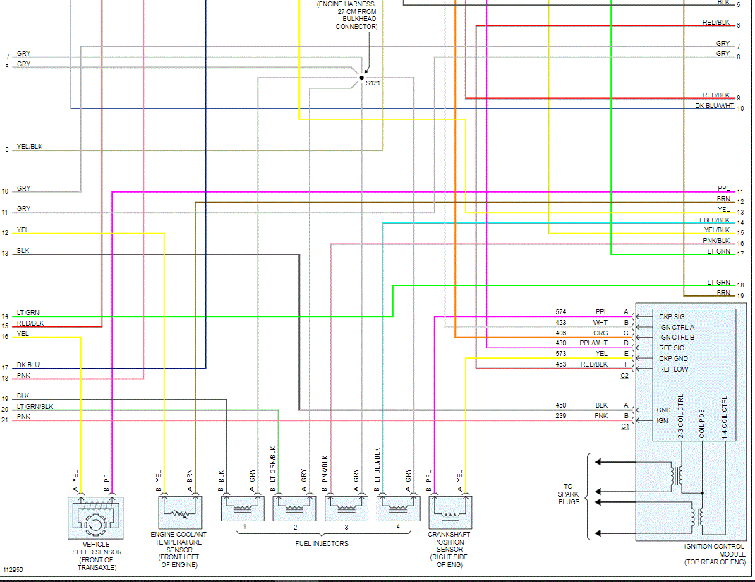

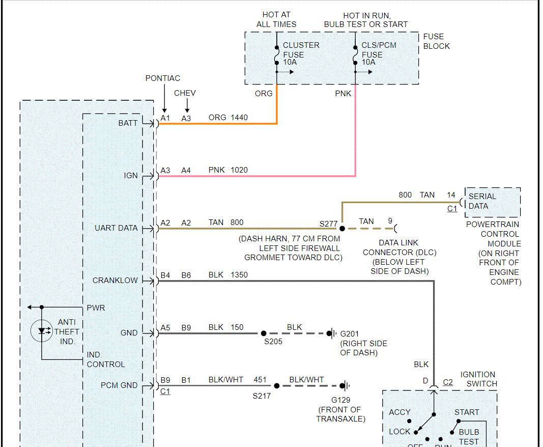

Okay. The best I'm going to be able to do is provide the wiring schematic for the entire powertrain management. Since you changed the type of transmission and the harness, I have nothing to reference here.
First, here is a link you may find helpful:
If you look at the attachments, I included the wiring schematics for the powertrain management. I had to cut the pics in half to make them readable. However, I did overlap them so you can follow from one to the next.
I hope this helps. Honestly, not being there and not seeing what was changed and done makes this difficult. Plus, I have no specific reference tools for what was done.

I had a 2.2, 3 speed automatic in my 1999 Cavalier I took that out and put a 2.2 4 speed automatic from a 2001 Cavalier in it had to take the wiring harness because it has a plug that plugs into the front of the engine everything is hooked up. I just can't get passed the theft deterrent. Thank you for your help it is very much appreciated.

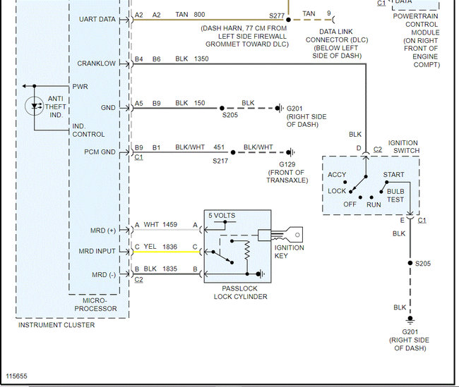

I attached the anti-theft schematics below. Is there any reason that the key wouldn't be recognized by the passlock? Also, check to see if there is a 5v reference to the passlock cylinder via the white wire. Also, confirm continuity to ground via the black wire.
Explain what procedure you used to reset the anti-theft.

A couple of years ago I replaced the ignition but I bypassed it by cutting the yellow wire and it ran fine. Then I changed everything I am pretty sure that the car I got the engine out of it wasn't bypassed not sure if that makes a difference. The white wire only read 2.8 volts. I have turn the key on 10 minutes then off turn back on for 10 more minutes back off then back on for 10 more minutes.

It didn't work. I clear the codes and the first time I turn the key off to on the check engine light comes on I'm assuming the u1000 code is popping up whatever that is.
Apr 17, 2021 at 7:02 AM
  • 110,248 POSTS

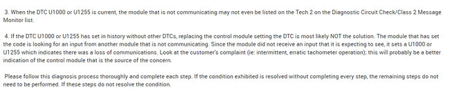

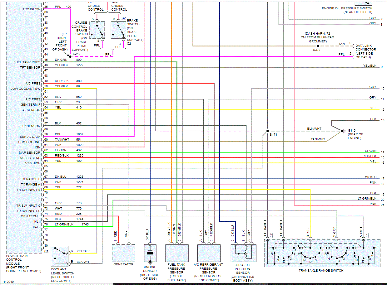

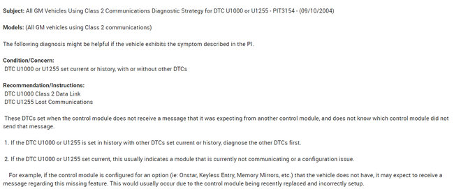

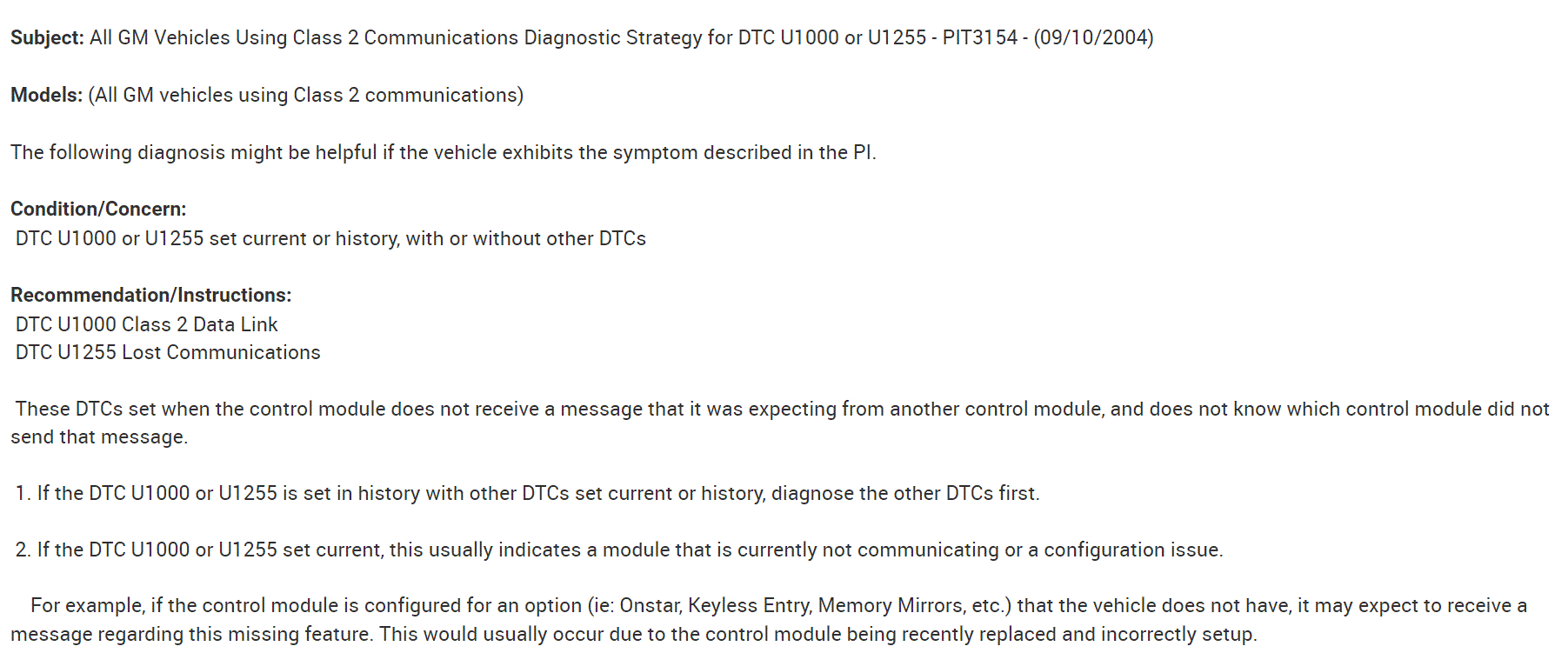

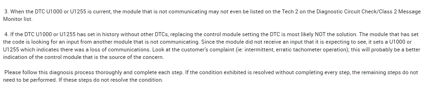

The U1000 basically indicates the control module is not receiving signals from other modules. Take a look through the two pics I attached. Let me know if that helps you or if you have other questions.

Yes, it could actually, the code will be set by any module that isn't communicating with the control module. Since this is related to the anti-theft, the problem is likely related to the theft deterrent module. A signal from it isn't being received by the control module.

The yellow wire is for the Magnetic Resonance Device (MRD). That is the input for it. If you have that wire cut, the pass lock is not signaling the control module which is likely the cause of the U1000. What happens if you reconnect that wire?

Did you change the ignition lock or anything? The 1626 indicates the body control module isn't enabling the fuel circuit (anti-theft/key not recognized) 1630 indicates the PCM is in the password learn mode, and 1632 indicates the PCM has received a fuel cut-off password from the BCM or an undecided password which could mean there is no communication.
The problem could be the switch/passkey, something different in the new harness, a faulty body control module, faulty PCM, and so on.

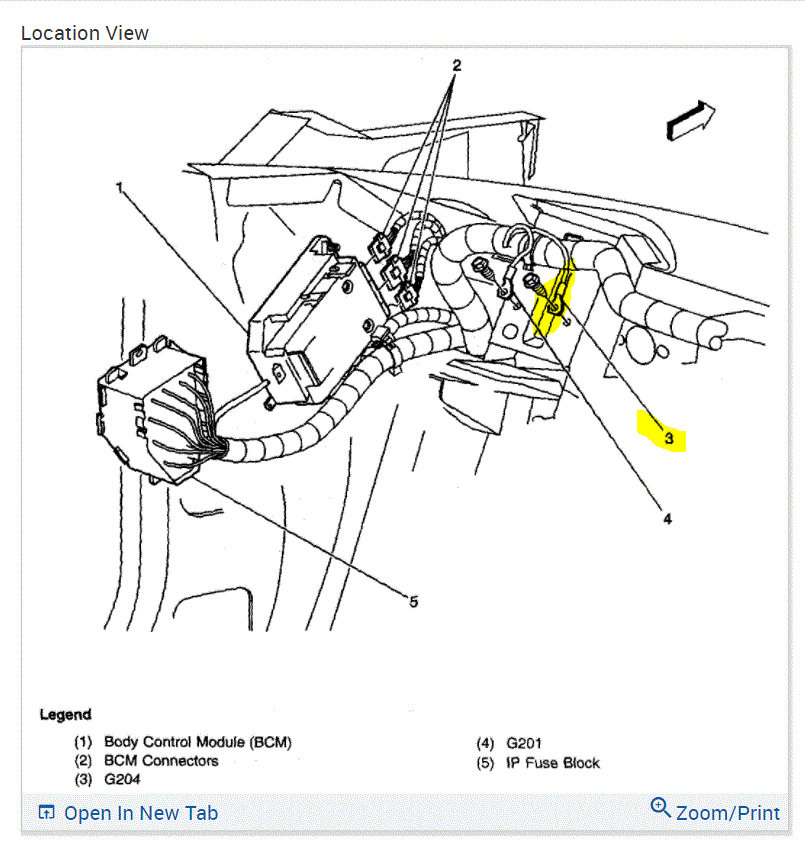

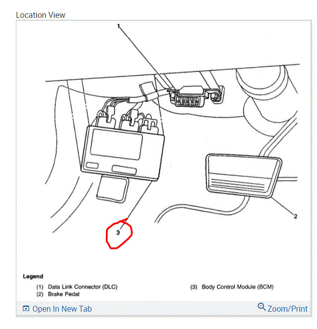

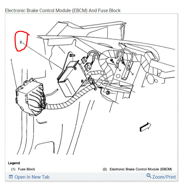

When you remove it, make sure to inspect connections and the ground. See the pic below for ground location.

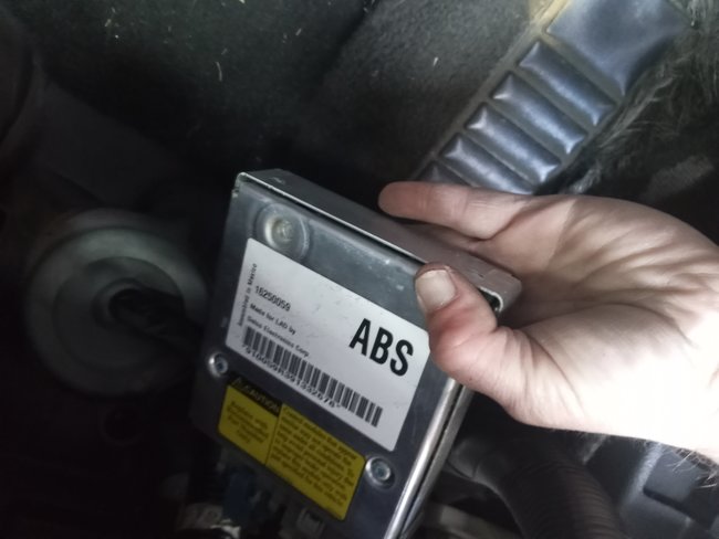

So I found this (see attachment) but it says ABS and the plugs are different so I don't think it's it.
Apr 19, 2021 at 10:30 AM
  • 110,248 POSTS
No, that isn't it. It should be under the dash on the left side.

So every video I watch and everything I read shows me that the BCM is behind the fuse box and back a little bit. That ABS thing I showed you is where the BCM should be, so I am a little bit confused about that.

Could it be in the ABS thing? I think I read somewhere that it's a EBCM the ABS is built into it.
Apr 20, 2021 at 3:37 AM
  • 110,248 POSTS
That is possible. I attached two pics below from the manual. One indicates the BCM and the other the EBCM. They look like they are in the same place.
