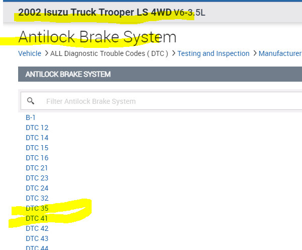

The interesting thing about what you have been told related to the ABS, from what I see is that isn't a code for this year and model. See pic below. Maybe they made a mistake.

I spoke with the shop on Friday. Mentioned there is no code 40...they looked up the record and it is code "43". I do not have access to a code reader, and the shop says that's the only code it throws. I will update you after they have it in this week. It sounds to me like the issues you mention should be remedied by the shop. I will update soon. Thank you again, Joe!
Apr 30, 2023 at 9:45 PM
  • 110,241 POSTS
Code 43 is an ABS code. There is an issue with the electronic hydraulic control unit (EHCU). I don't feel this would cause you to have power issues.
