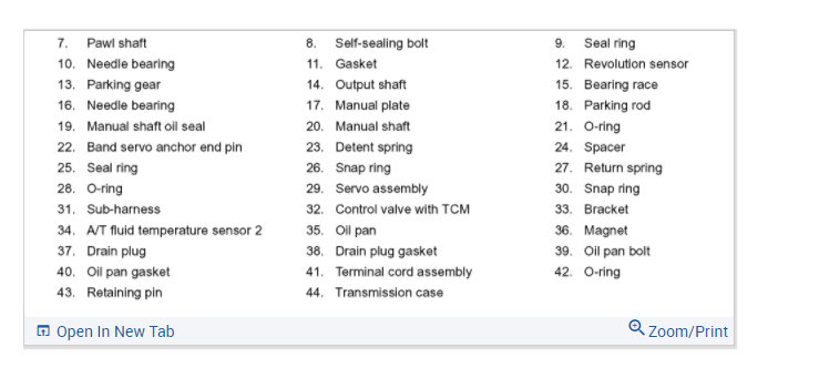

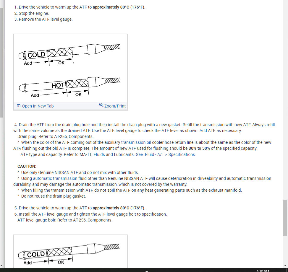

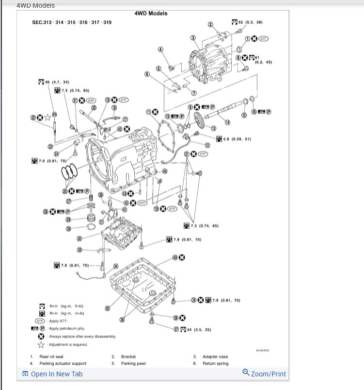

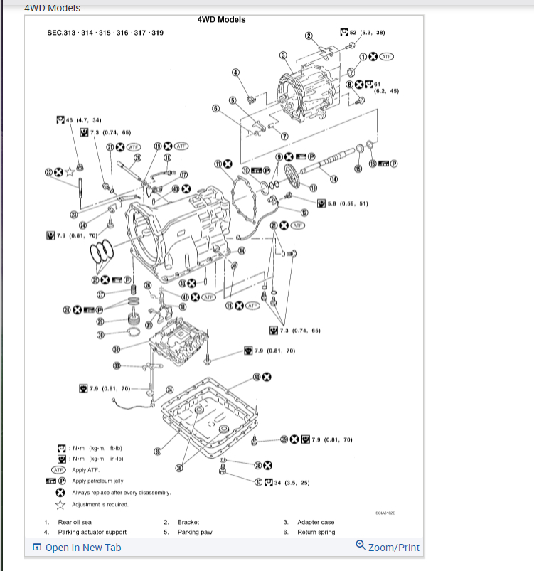

Here are a couple videos that will give the detail that you need to complete this:
https://youtu.be/pHPkHP4m0SM
https://www.youtube.com/watch?v=2jSHRjk7mSM
Below is the info from the manual that provides the process of checking and changing the fluid as well. Please run through this material and let us know if you have other questions. Thanks
