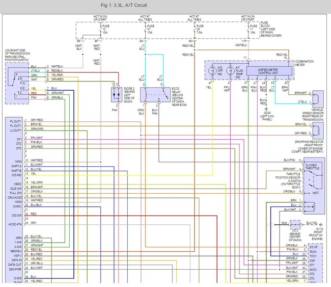

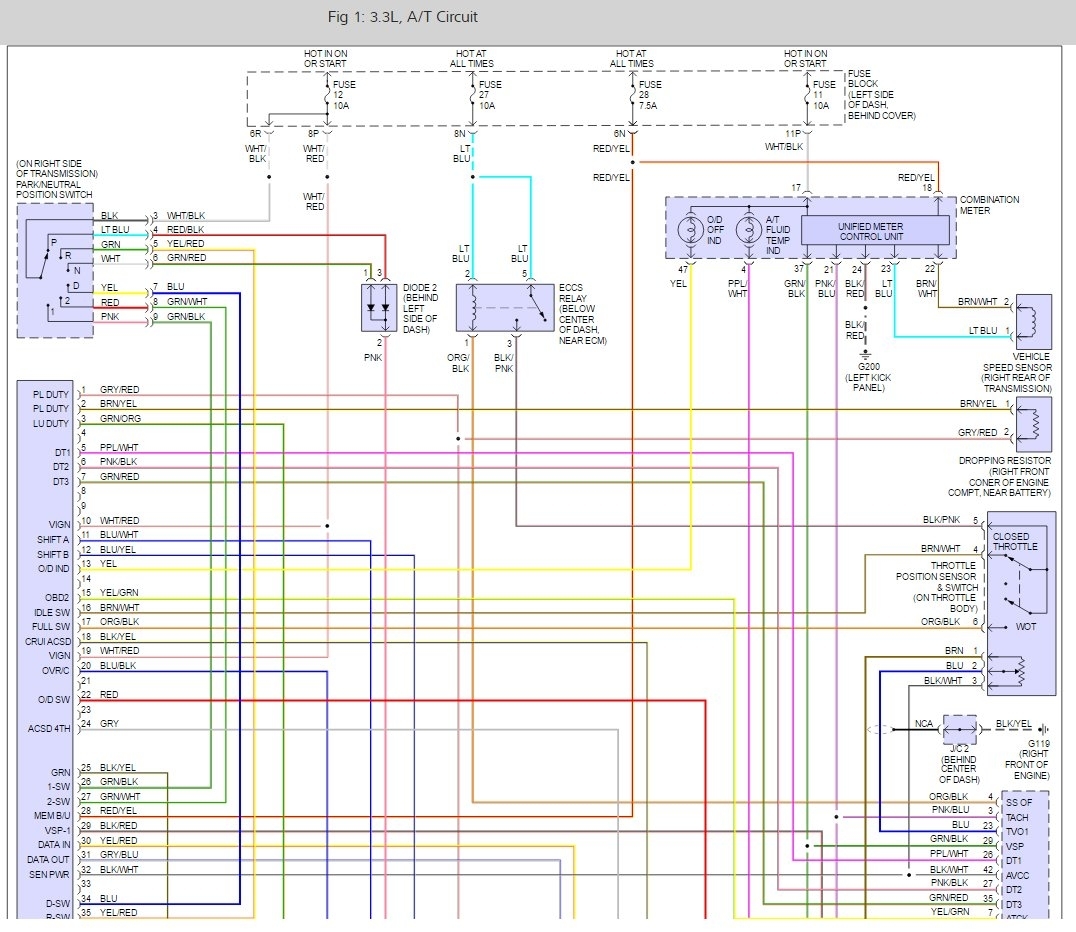

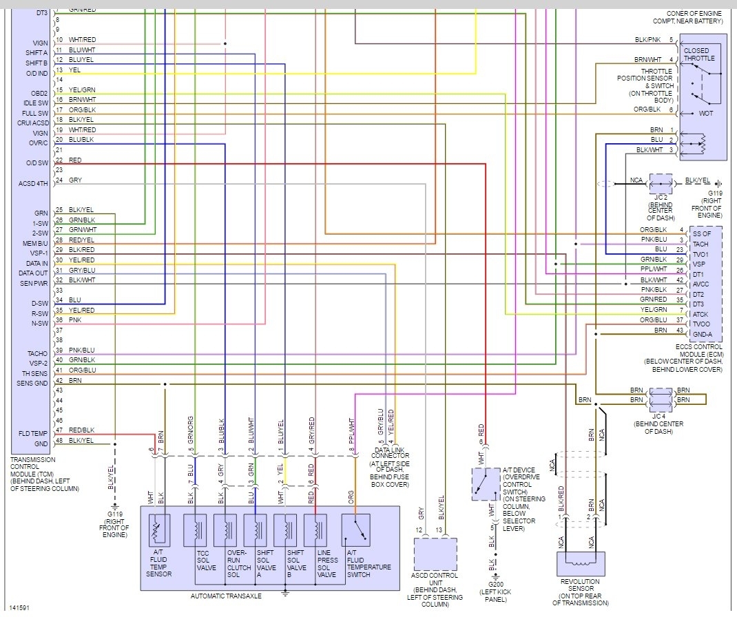

Park ,reverse, drive 1, and 2 work fine. But in drive the transmission stays in first gear. shifts if I start in drive 1 (first gear) then drive 2 (second gear) .
Jan 14, 2017 at 9:23 AM
  • 55,423 POSTS
There is a eccs relay I would check first, then test the fuses, next move onto the park neutral switch here is a guide and a wiring diagram so you can get started. Check out the diagrams (Below). Please let us know if you need anything else to get the problem fixed.
