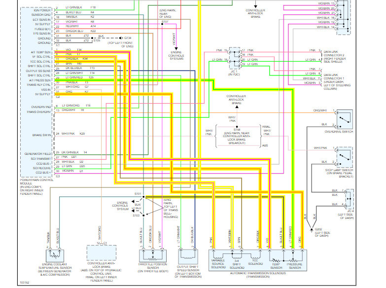

Transmission will not shift?
STARLORD1976
  • 173 POSTS
I have checked the wire harness and it all seems okay.

Did you verify power to the solenoids?

Do you know if this truck has a transmission relay and where it would be located?
Friday, December 18th, 2020 AT 10:36 AM (Merged)
  • 52,797 POSTS

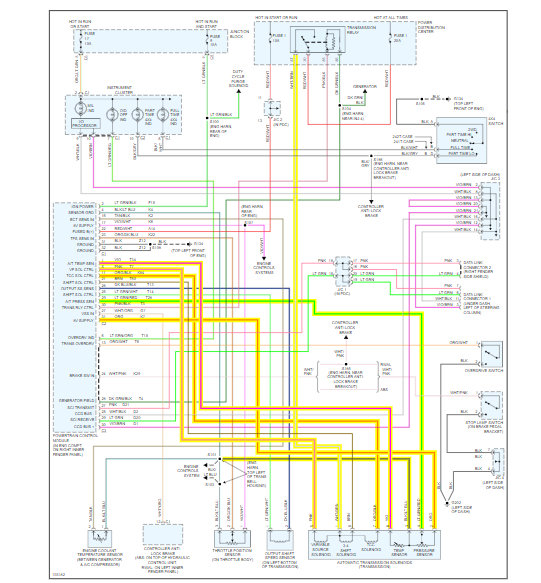

You need a voltmeter and need to test for power to one terminal on the solenoid with the key on.
You said you checked the harness. what and how did you check it?
STARLORD1976
  • 173 POSTS
I just checked it for damage and make sure it was connected.
  • 52,797 POSTS
Okay, you need to test for voltages at the solenoids as shown in the diagrams.

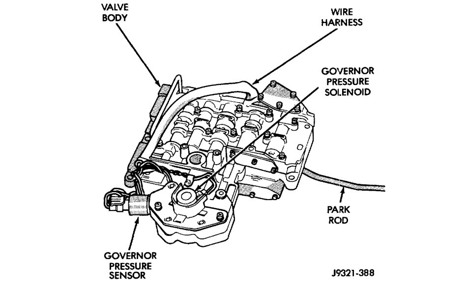

Can you send me real pictures of all the solenoids and how many should there be? Thanks
  • 52,797 POSTS
I attached pictures for you.

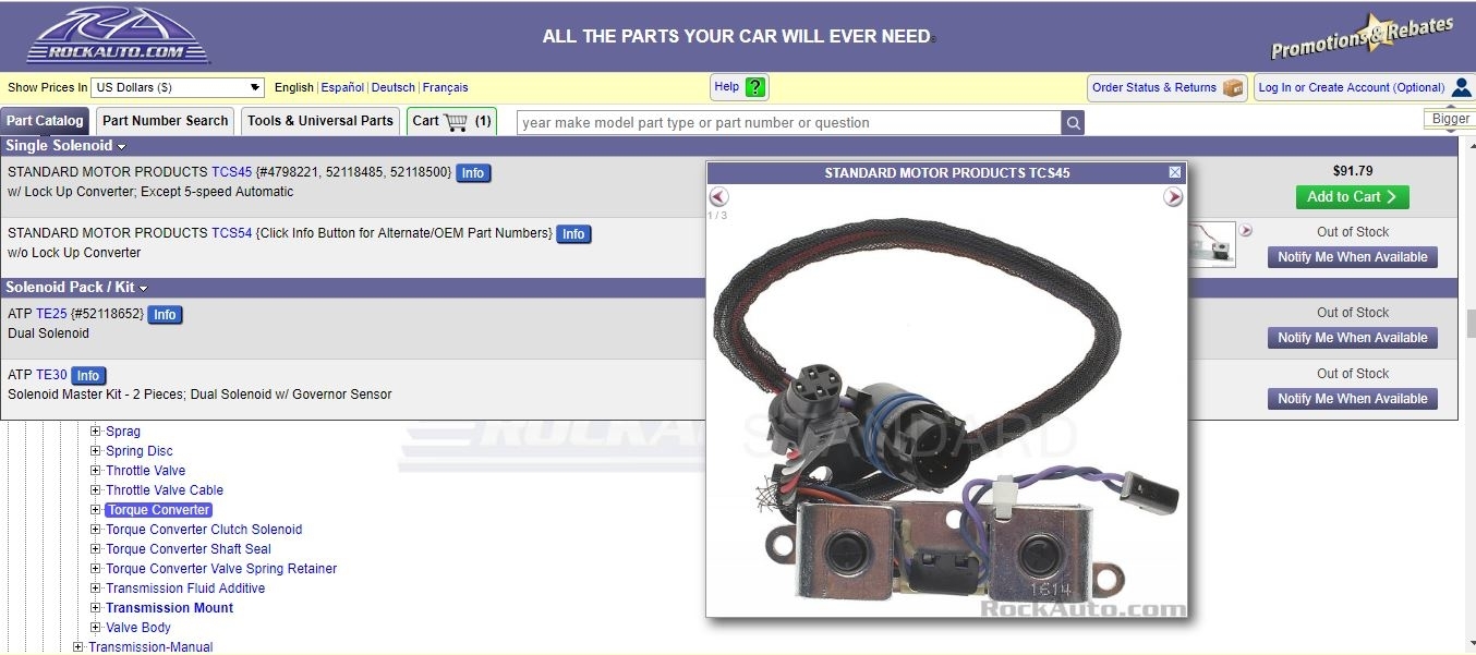

I can’t find online what the shift solenoid a looks like or can’t find one for sale can you help?
  • 52,797 POSTS
I attached a picture for you from the part at rock auto.

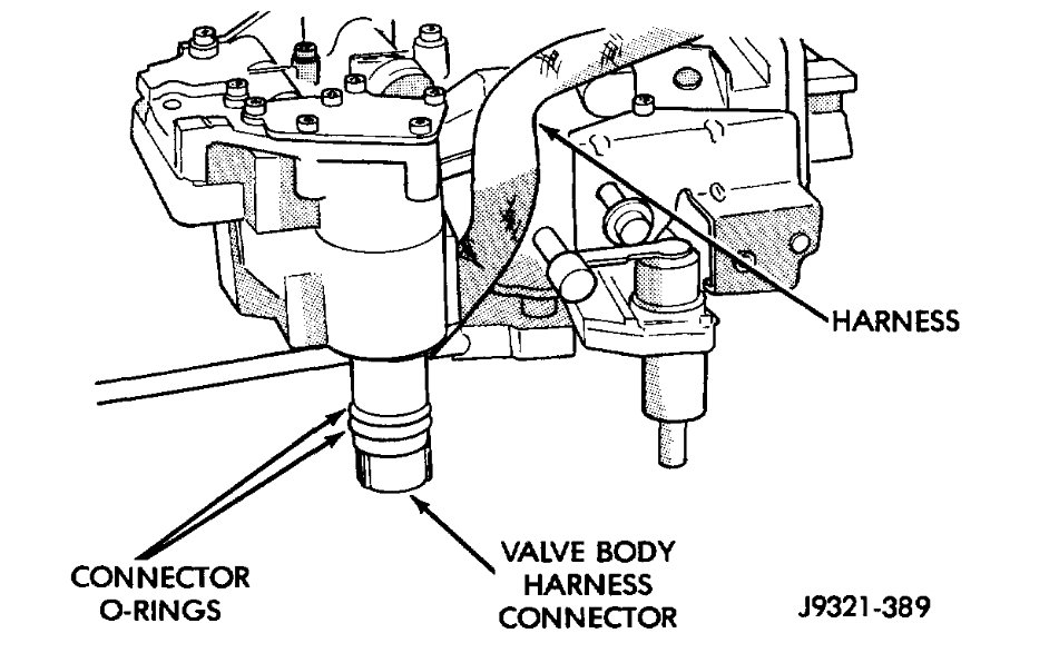

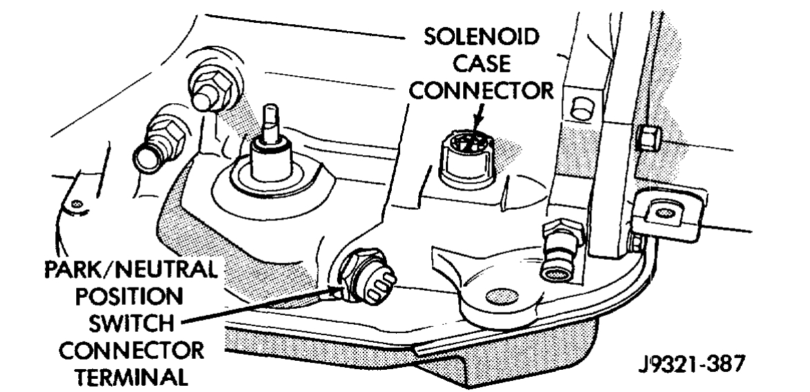

On the image you sent me I bought it and trying to replace it. But the connector that’s hooked to it. I can’t find where it goes to disconnect it. It goes upwards and then I can’t see where it goes.
  • 52,797 POSTS
Do you have a picture of what you see?
Do you have the pan down?

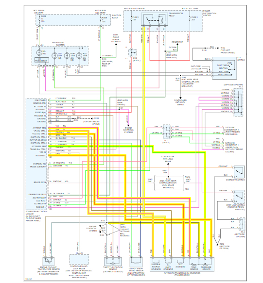

Okay, going way back, I suggested you check voltage to the solenoids as part of the test.
Did you test the voltages from all the charts I sent you?
STARLORD1976
  • 173 POSTS
No, I just thought if I put all new solenoids in it would work.
  • 52,797 POSTS
No, as I stated before, you need to verify voltage to the solenoids first. The code indicates a power issue.
You need to check the actual voltage to the solenoids.
