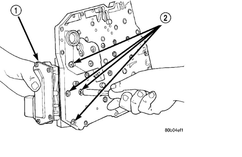

Hello I was wondering if you could help diagnose an issue I'm having with the transmission. I'm experience a very hard shift into 2nd Gear. I've checked my transmission fluid and the levels are right. I'm not sure what I should try next.

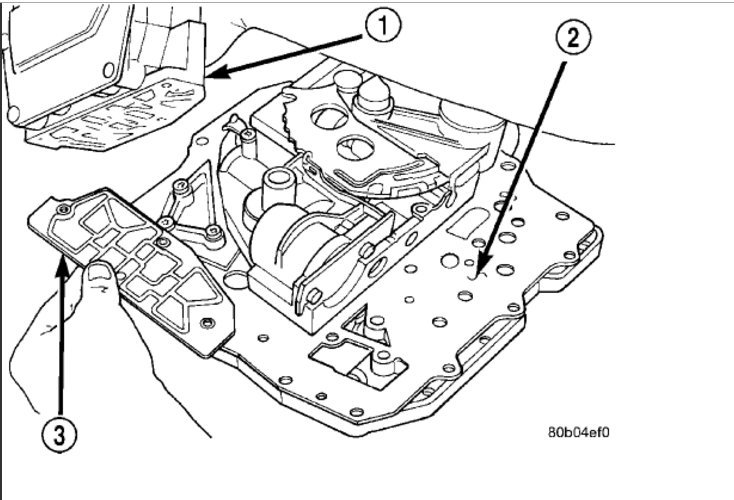

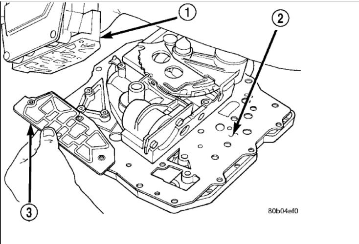

It sounds like you have a broken pressure regulating solenoid which slows down the shift engagement. This mean the transmission will need to come apart to replace the solenoid. The pan must be removed, here are some guides to help you get the job done.
to pull the pan
Detailed diagrams (BELOW)
Raise vehicle on hoist.
Remove valve body assembly from transmission.
Remove Solenoid/Pressure Switch Assembly retaining screws (2) from solenoid.
