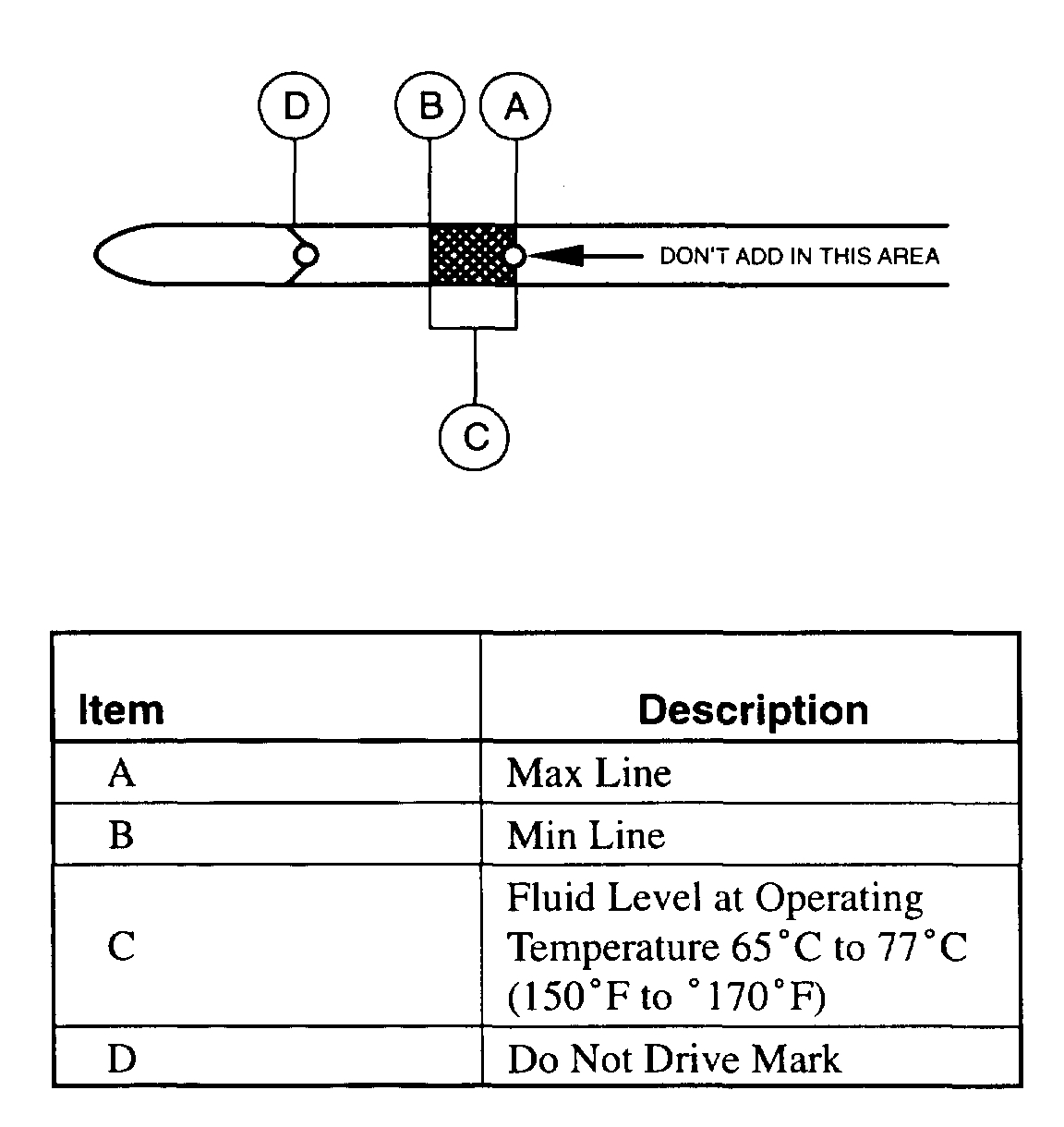

The first thing to check is the transmission fluid. Make sure it is clean and full.
Here are the directions for checking fluid. The attached picture correlates with the directions.

With the vehicle on a level surface, start the engine and move the transaxle range selector lever through all of the gear ranges, allowing sufficient time for each position to engage. Securely engage the transaxle range selector lever in the PARK position, fully set the parking brake, and leave the engine running.
Wipe off the fluid level indicator cap, pull the fluid level indicator out and wipe clean. Put the fluid level indicator back into the filler tube and make sure it is seated properly. Pull out the fluid level indicator and read the fluid level.
When checking fluid at normal operating temperature, the fluid level should be within the crosshatched area on the fluid level indicator. When the vehicle has not been driven, and the outside temperature is above 10° C (50° F), the fluid level should be between the hole and the lower edge of the crosshatched area on the fluid level indicator.
