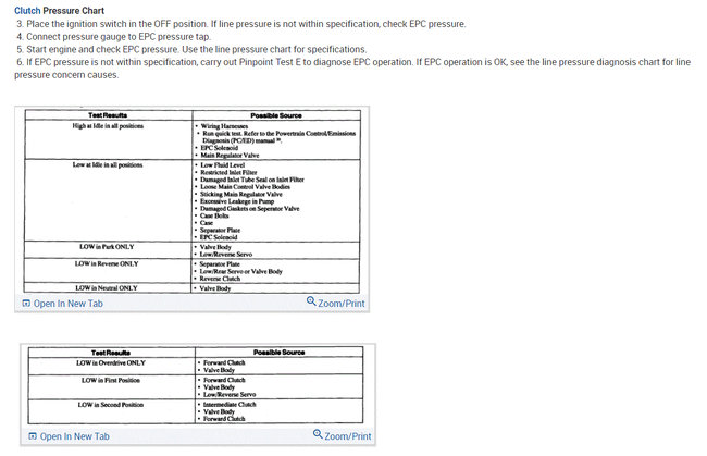

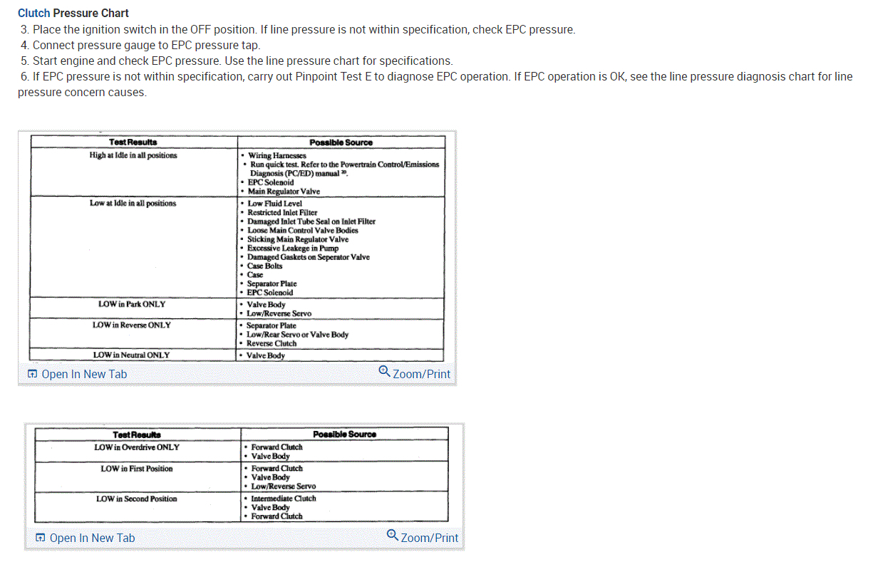

I have seen that happen on vehicles with a plugged filter. When the engine is turned off, the debris drops into the pan, and the transmission works for a short time until it sucks the dirt back into the filter, but you already replaced the filter. I feel it is something to do with line pressure. The only part I'm not sure of at this point is this. Reverse takes the most pressure to operate and functions from the same clutch pack as first gear. It's referred to as the low/reverse clutch.
If I had your vehicle, I feel the first thing I would check is the line pressure. If it's low, we need to determine where the problem is.
Do me a favor. Please confirm if this has a 4.6V8 or a 5.4V8. Also, let me know the condition of the fluid and filter when you changed it.

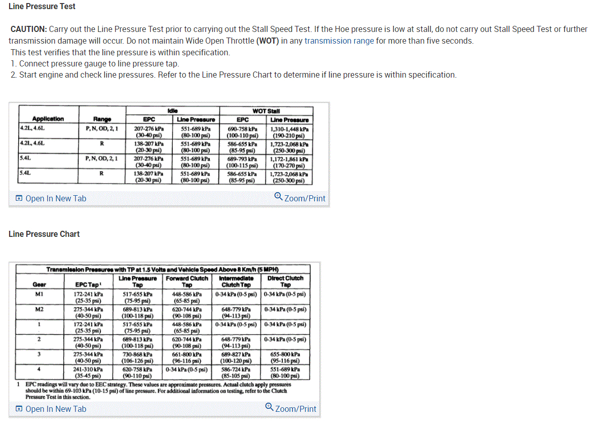

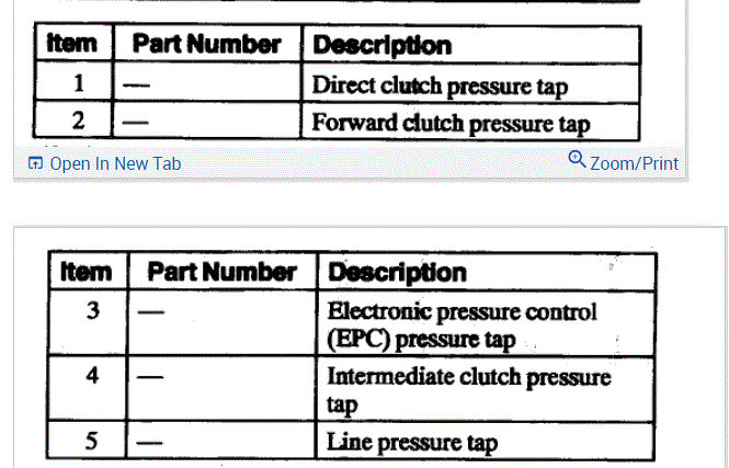

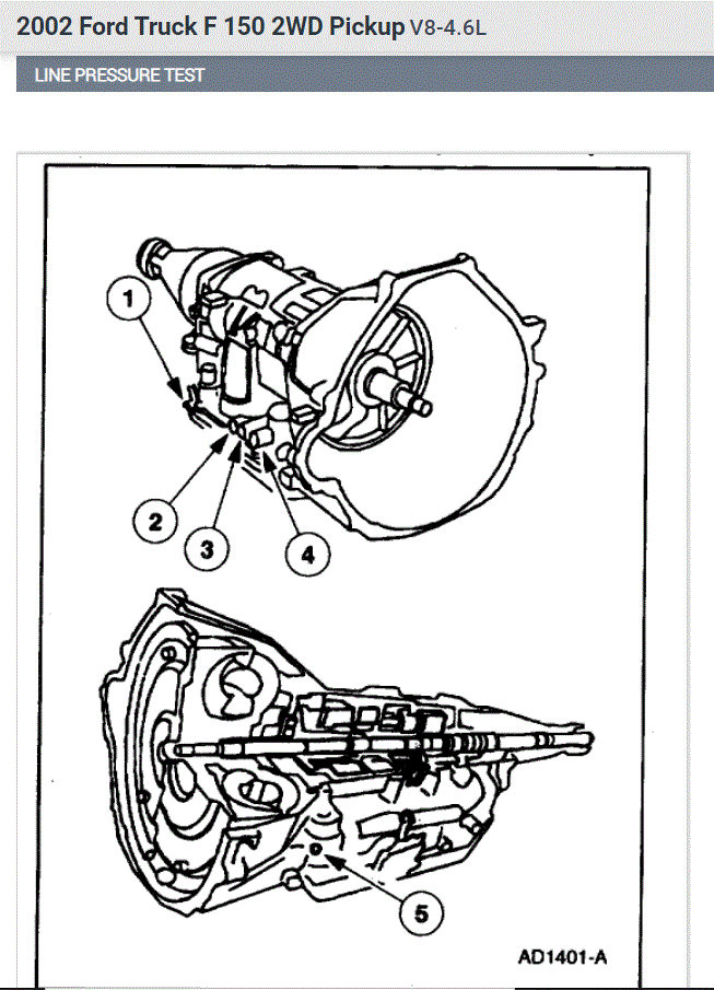

If you look below, the attachments are the directions and pressures for testing line pressure. They are for the 4.6L V8. If that isn't the correct engine, let me know. The pressures appear to be different.
Let me know your thoughts and if you feel comfortable performing the test below. Hang in there. We'll figure this out together.
Oct 10, 2021 at 11:52 AM
JCPHILLIPS21
  • 12 POSTS
Checked line pressure all was good there. Before I changed the filter it was pretty bad took a while for fluids to come out the other side tried cleaning with gas but still didn't work. It's the 5.4l.. my dad saying it could be the clutches for those gears are stripped out.

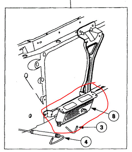

If I had the truck for diagnostics, found good line pressure, the next thing I would do is flush the cooler. If the transmission fluid was extremely dirty, it could have been clutch material. So, your father is certainly thinking in the right direction. However, before I would pull the unit, I would flush the cooler.
Does this truck have an auxiliary cooler or is it just one through the radiator? I attached a pic below of the auxiliary cooler's location.
Oct 10, 2021 at 1:10 PM
JCPHILLIPS21
  • 12 POSTS
Believe it's just the one through the radiator. Where i put the water in there a hose going to the radiator and another going down into the motor though it has a bad leak sitting on empty now. I'll look into that to make sure we are talking about the same thing.
Oct 10, 2021 at 1:41 PM
  • 110,251 POSTS
It is very possible that the cooler is integral with the radiator, and you don't have the auxiliary cooler.
