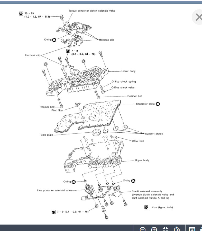

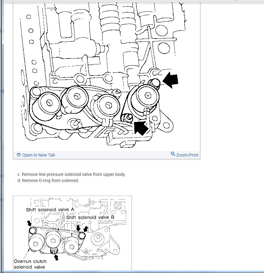

I have never had any issues with the transmission but one day while driving perfectly fine, drive no longer caught the gears and behaved just like neutral. All other gears still work, including 1, 2, reverse and park. But drive will just rev without moving whatsoever. The transmission fluid was a little low so I replaced it and added some anti slip. The old fluid looked fine but alas the transmission behaved the same. Any help on this would be greatly appreciated.
Apr 5, 2021 at 11:25 AM
  • CAR REPAIR CONTRIBUTOR

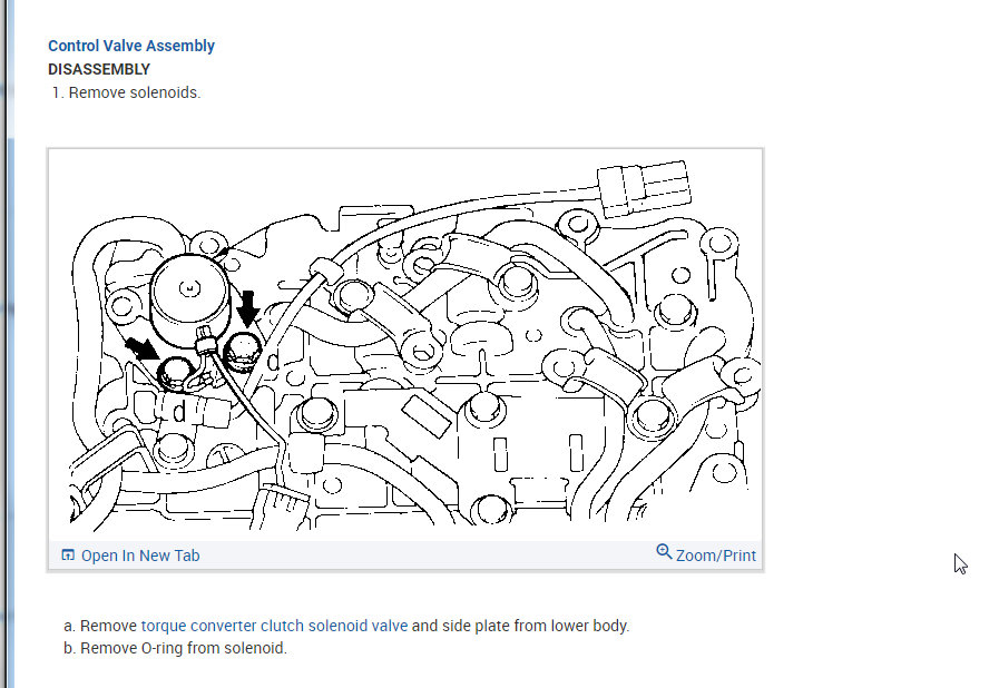

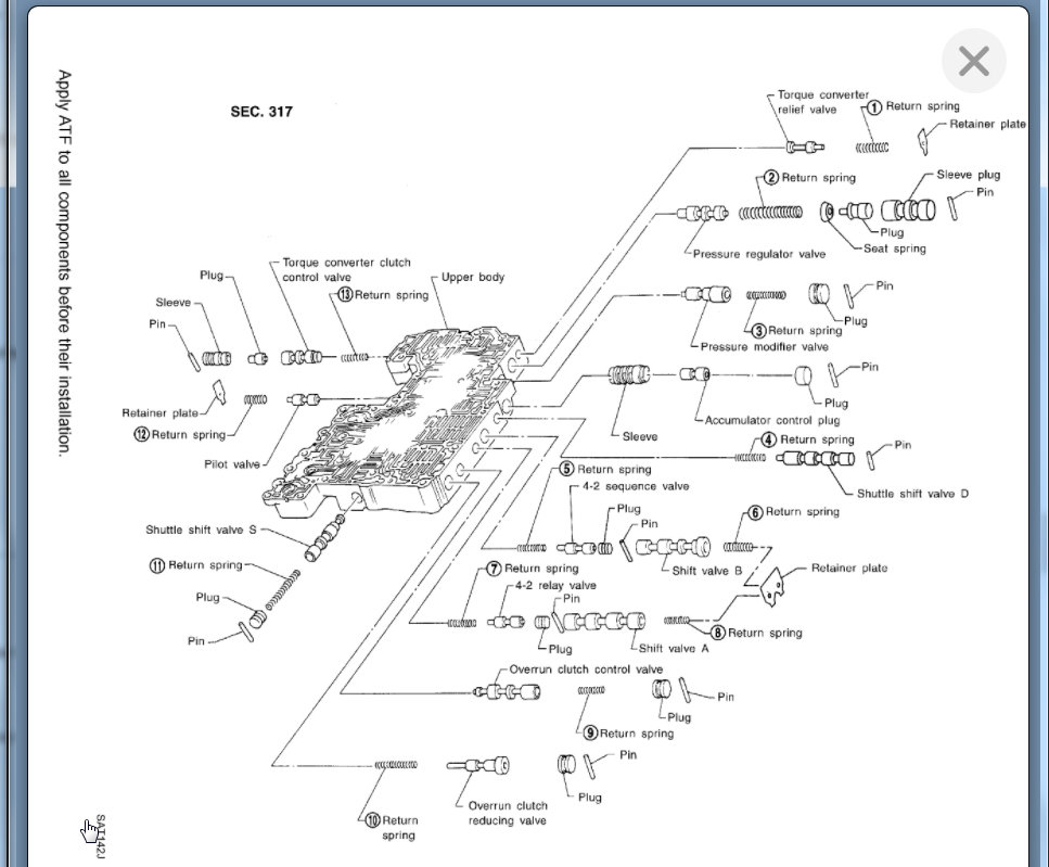

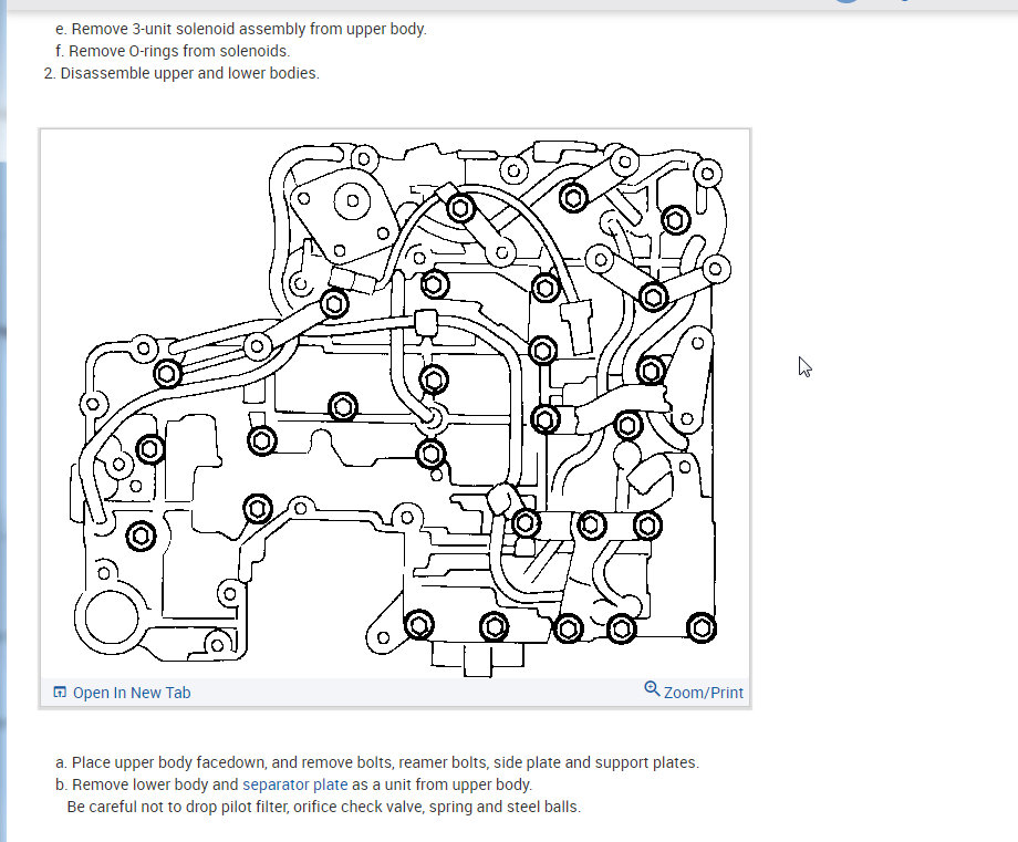

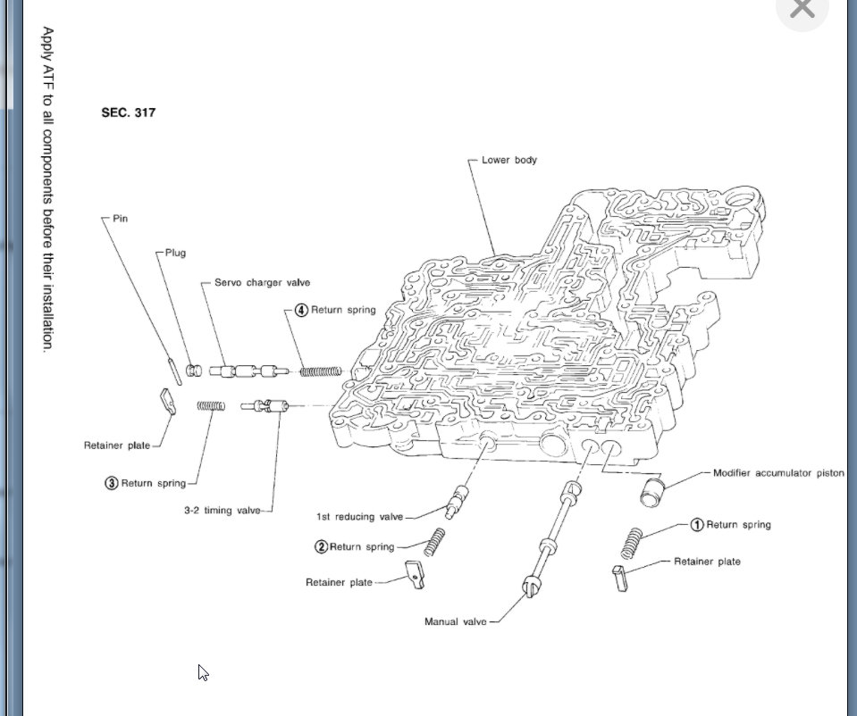

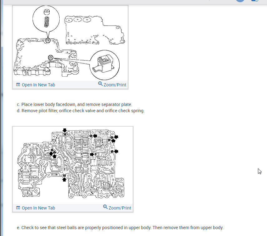

More than likely you have a cut seal in the transmission or a valve body issue.
However, based on the fact that it still works using the manual valve and shifting to 1 or 2 then that shows the seals are most likely just fine.
So that leaves a valve in the valve body being stuck.
Below is all the info on the valve body and how to disassemble it. Basically we need to pull it out and either replace it or pull the valves out to find the one that is sticking.
Let me know if you have questions and we can go from there. Thanks
