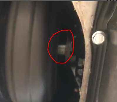

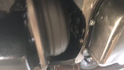

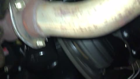

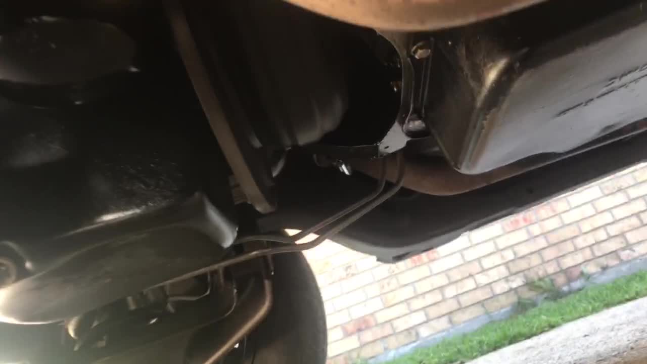

Brand new engine brand new FTI performance th400 and torque converter When it’s cold it whines in all gears but when it warms up it doesn’t make a sound it shifts well just whines when cold. Added video of cold start. Any advice?

This video is before I checked fluid. However, after adding more fluid noise stopped for awhile after I shifted through all gears and let it warm up took it for a spin around a block noticed smoke coming from under car. Upon further inspection transmission fluid leaked out from what looks like gasket by toque converter. I did call Summit Racing and they will warranty it out I’m just trying to pinpoint this problem so it won’t happen when I get my new converter and transmission.

That sure seems to have a lot converter hub sticking out from the pump seal. You might want to ask Summit why. What stall converter is it? I've attached your picture below. Just adding my 2 cents. Thanks again for using 2CarPros.

It’s an Fti performance 2800 stall. I asked and all I got was it could’ve been faulty as I had a shop do the work but I’m reconsidering as I paid $1,615.00 plus fluids and I’m not inclined to do the same thing over less than 2 weeks later.

So after putting in a different shop to get a second opinion I was told the torque converter was not fully engaged as Danny pointed out which is why i hear a whine sound and missing 1 of 3 bolts on my torque converter. Of course the shop that did the work denied responsibility saying they did everything correctly and the torque converter basically rocked out of place because I have a broken passenger side motor mount and it sheered off one ARP torque converter bolts. Good eye Danny would’ve never noticed if it wasn’t for you.
Nov 7, 2020 at 2:28 AM
Great catch Danny. Sorry to hear the shop denied responsibility. However, converters don't walk out. Once fully seated they are bolted in place to the flex plate so if not fully seated they will stick out.
