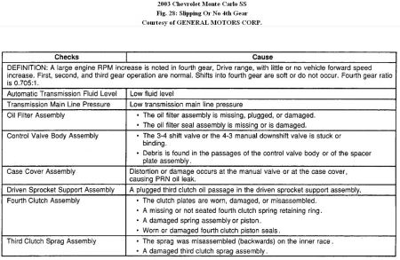

Hello, I have the car listed above SS model that has had absolutely no problems until lately. It first began when the 'service traction/ABS' alarm/light came on ans then about two days later the car would not shift into fourth/overdrive. I changed the transmission speed sensor and the alarms went away and have not seen them since but the car still will not shift into fourth. I have put a code scanner on it numerous times with nothing thrown back, changed the transmission fluid and filter but still have no luck with anything. Can anyone please help me figure out what this issue is? I am seriously desperate to save my baby, but do not have the money (or desire) to take it to a shop if it is something that I can most likely fix myself. Thanks in advanced -Korey.

Hi KOREY, Thank you for the donation. What was the trouble codes when the ABS indicator came on? Here is a table for possible causes of not shifting to fourth speed, (OD):
https://images.2carpros.com/forum/automotive_pictures/192750_No4thgear_1.jpg
