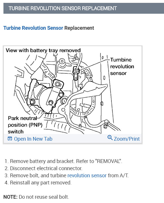

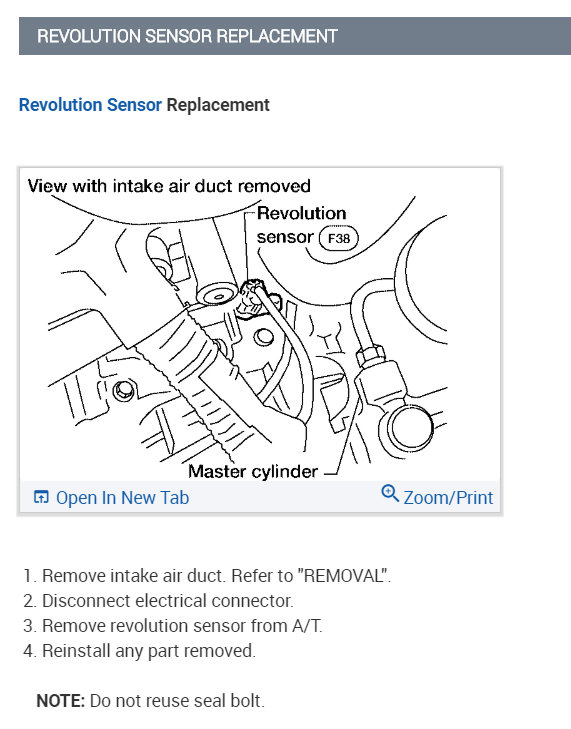

When warm the shift from d1 to d2 "catches", (lurches?). Also, after a few miles of warm up, the shift from park to R or to D is met with a pause, and then a lurch. Very severe when shift to D.
There are no DTC's
Jun 5, 2020 at 11:25 PM
  • 55,456 POSTS

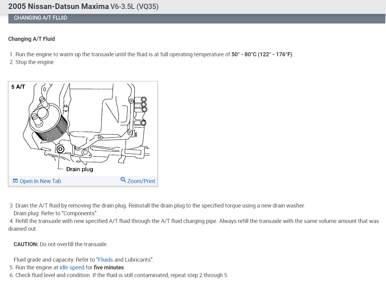

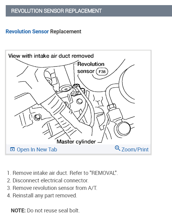

The first thing is to check the transmission fluid level. If okay I would change out the input shaft sensor. here is how in the diagrams below:
Fluid Types
Recommended fluid .................... Nissan Matic "K"
NOTE:Using Automatic Transmission fluid other than Genuine Nissan Matic K ATF will cause deterioration in driveability and automatic transmission durability, and may damage the automatic transmission, which is not covered by the NISSAN new vehicle limited warranty.
Capacities
Fluid Capacity .................... 7.3 L (7 3/4 US qt. 6 3/8 Imp qt)

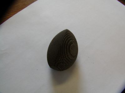

When in slow traffric the transmission often will not shift out of first until you park it and let it sit for a while then it will most likely shift. Transmission has been completely rebuilt and the transmission shop says its the catalyic converter locking it into first gear at times. It may run well for a number of days and do it again. Whats up.

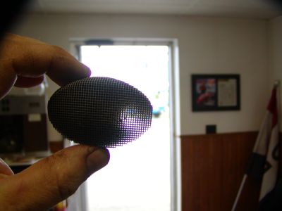

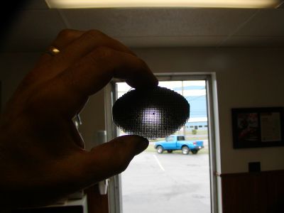

What codes are in the computer. I would expect the CEL to come on with this and have a po420 code. IF the converter is plugged it can be from a piece that has turned into a position that does not allow flow. You can rap on the converter and listen for broken pieces rattling around if this is happening. This is a piece from a converter we replaced.
https://images.2carpros.com/forum/automotive_pictures/30961_converter1_2.jpg
https://images.2carpros.com/forum/automotive_pictures/30961_converter4_1.jpg
https://images.2carpros.com/forum/automotive_pictures/30961_converter2_2.jpg
IT is a honeycomb like configuration. IF a piece flips there is too much backpressure.

PO420 is the code for a bad cat typically, but there may be transmission codes or others.
Most of the time a plugged cat acts like a governor and limits the engine RPM to a fast idle. Combustion must have a release which is the exhaust. If the engine can not gain momentum because it can not exhaust, the transmission will have no reason to shift.
There are two ways that you may be able to check this besides what I already mentioned. Remove the front oxygen sensor so there is less restriction or better yet disconnect and support the front pipe. Therefore no restriction. If it runs good at that point you verified the cat....or plugged exhaust of somesort.
Jun 8, 2020 at 3:18 AM (Merged)
JDS7345
Thank you very much. My daughter has since found some diagnostic paperwork The code is po420 low bank one and calls to rplacing the "y" pipe (Cat I guess) Your information certainly confirms the likely problem and thanks for the help.
