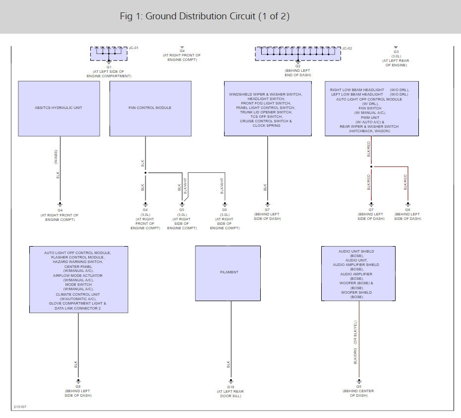

I have the vehicle listed above it is the 6 Wagon S. I performed transmission filter and transmission fluid replacement service, aftermarket headers installed and replacing oil pressure sensor . After all of the work was completed, my car would not shift into any other gear as selected with the exception of reverse, neutral and third gear.
The manual gear selection did nothing to move vehicle out of third gear. The check engine light would lit up as soon as the engine is started even after the CEL have been erased and cleared many times before the start up .
Mass airflow sensor and camshaft position sensor were replaced with the same test result, original mass airflow sensor was installed back for testing and still getting the same check engine code and still stuck in third gear with reverse gear being hard shifting/aggressive shifting into reverse.
These are CEL codes below . Battery voltage reading at the battery terminal after start up 14.30 volts.
1 . Mass airflow sensor low input.
2 . Camshaft position sensor left and right side .

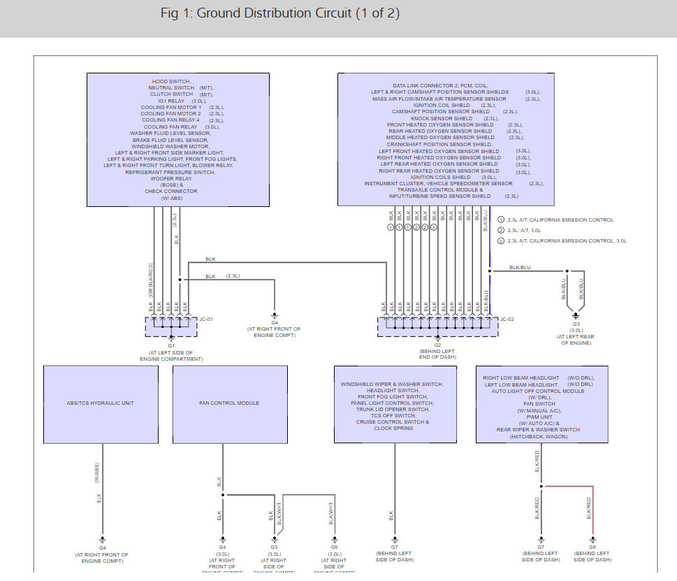

Problem seems to be a wiring fault.
Check all wiring harness connectors for proper connections. Ensure all grounding points are clean and secured. If it is a ground wire fault, it should be related to the MAF and CMP sensor wiring.

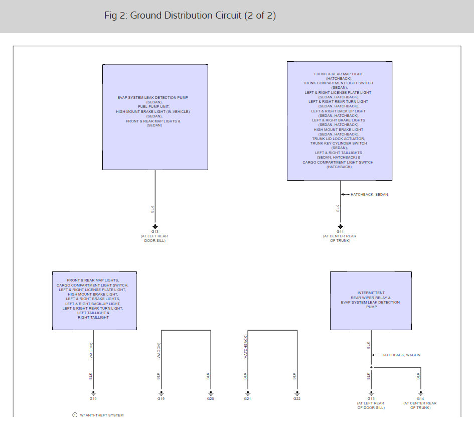

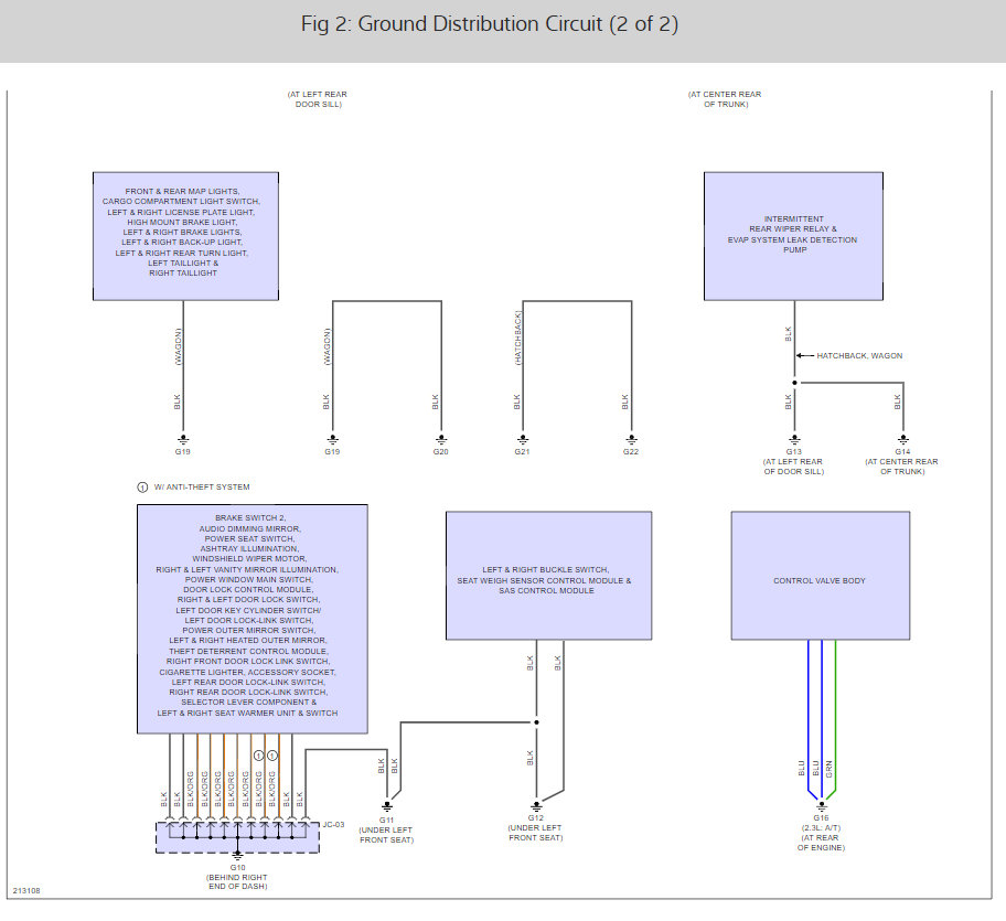

Yep it sounds like one of two things could have happened. First is they left a ground wiring off of the engine somewhere or they bumped the transmission wiring connector which is where I would look first. The next thing is did they put the correct transmission fluid because Mazda takes a special fluid and if you don't use it the transmission will not work.
Here are the ground location and ground wiring diagrams
