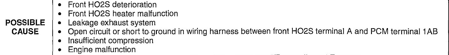

See pic for causes, check fuel pressure with a gauge and for the 300 code is amisfire so it may be from low fuel pressure or basic engine or any sensor. You may have an exhaust leak as well ad make sure all duct work has noholes in it prior to engine. 300 codes are a bitch to find so normally I tell people to go to apro so he can check everything, check compression as well. 55-65 psi for fp. We only list a 3.0L for this car so these are the specs i'm using.

Youpic didn't come through, check for cracks around it on intake and throttle body. If it isjust a gasket you might try using 2 or 3 and see if that cures it. If it's an Oring you can't so you'll have to see why it's leaking there.
