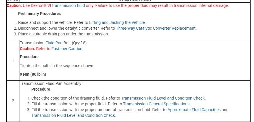

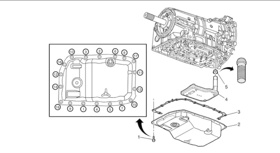

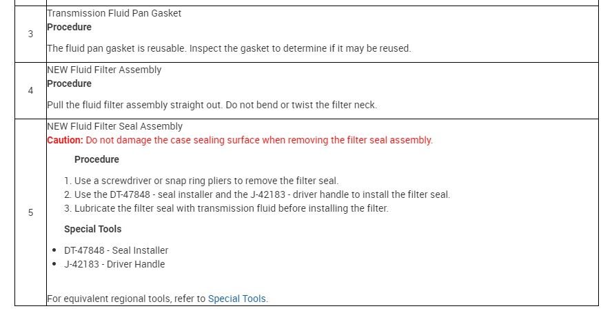

Good evening,
Is the check engine light on? If it is, do you know the code?
It could be a clogged filter in the transmission. How long since you had the fluid and filter changed.
