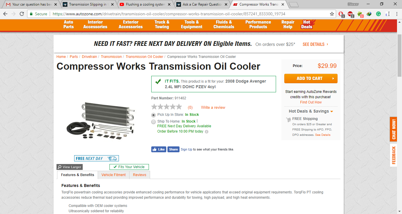

My automatic transmission shifts first and second gear properly, but the third gear which is supposed to shift at thirty mph with lower rpm. It does not shift until it reaches over forty mph and the fourth gear only shifts when it reaches over fifty eight mph in cold weather which is usually shifted at forty five mph. These shifting only happens when the temperature outside (weather) is higher, usually when it is over eighty degrees Fahrenheit. This problem only happens in summer or in hot weather. I deliver pizza on this car so I drive it all day and the problem never happens in winter. The engine coolant is always at operating temperature and it has never been overheated. When I spray a lot of water on the radiator and transmission cooler in the hot weather then It starts shifting regularly but it only lasts for about thirty minutes, then again it goes back to irregular shifting. If I Spray water again It would shift normally. To diagnose this problem I flushed my radiator properly and added a brand new coolant. The transmission fluid is in good condition. It does not smell burned and it is at the proper level. I recently brought an external transmission oil cooler which you can see in the photo below. I installed this oil cooler but the problem still continues.
I believe the cooler I Installed might be too small and it is very cheap and it is not cooling the fluid enough. It only cost me about $40.00. Should I Install a better cooler or do you have any other suggestions?

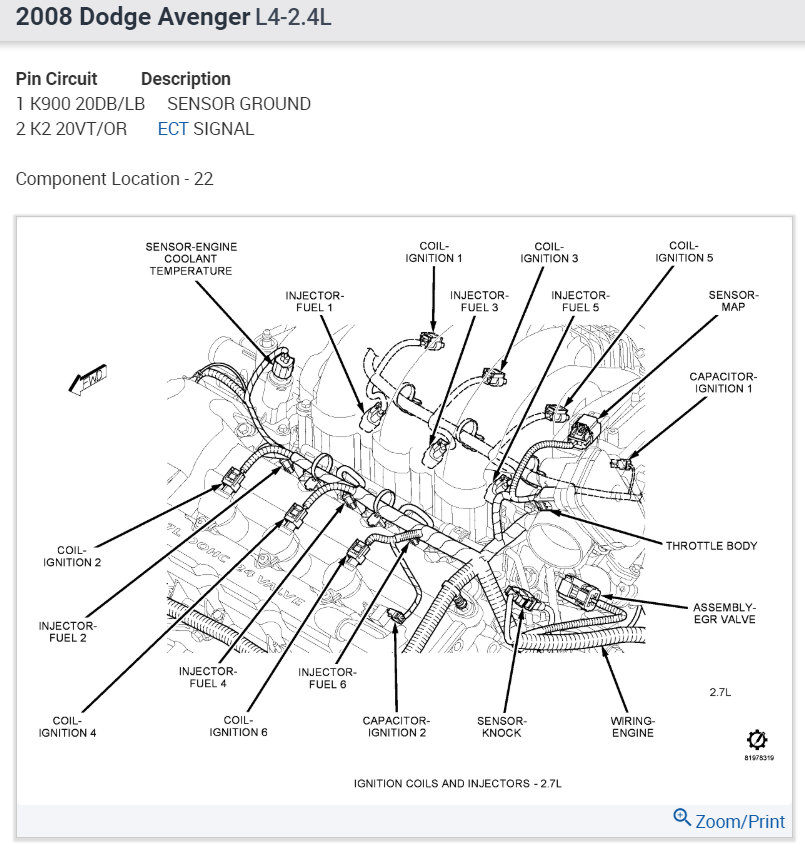

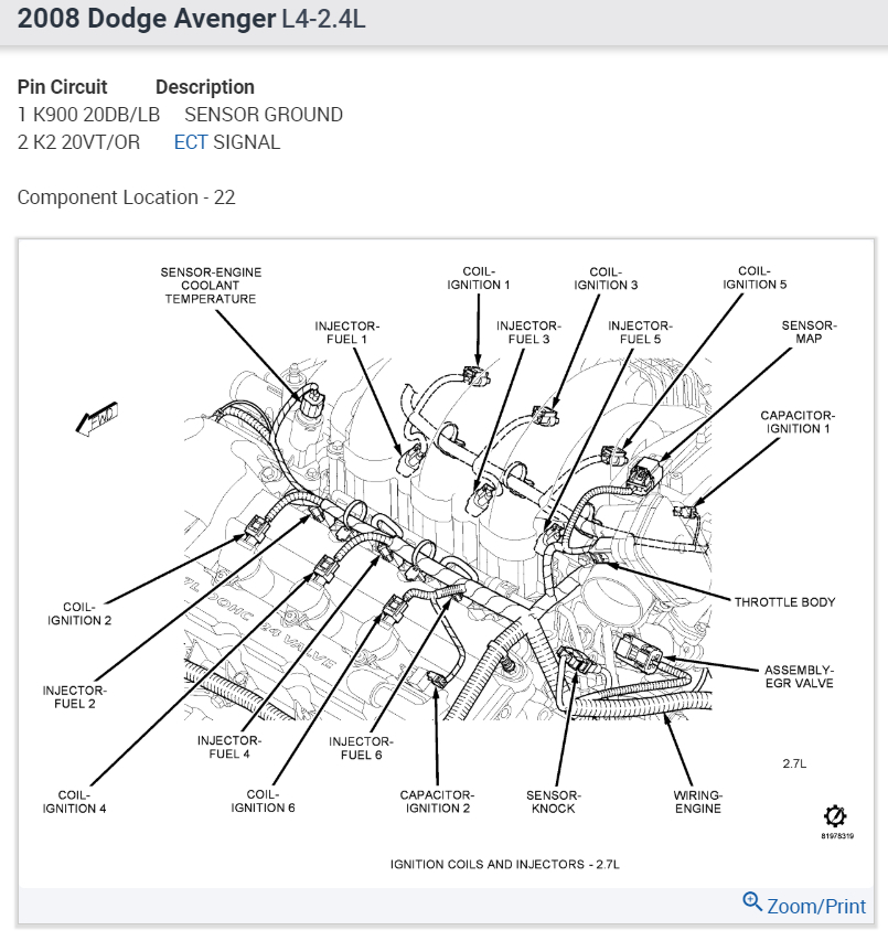

It sounds to me like the engine coolant temperature sensor may be giving you problems telling the computer to lower line pressure inside the transmission. To confirm the issue scan the PCM to read the value of the ECT or replace it with a new part. Here are guides and the location of the sensor:
https://www.2carpros.com/articles/coolant-temperature-sensor-cts-replacement

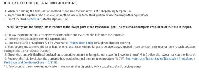

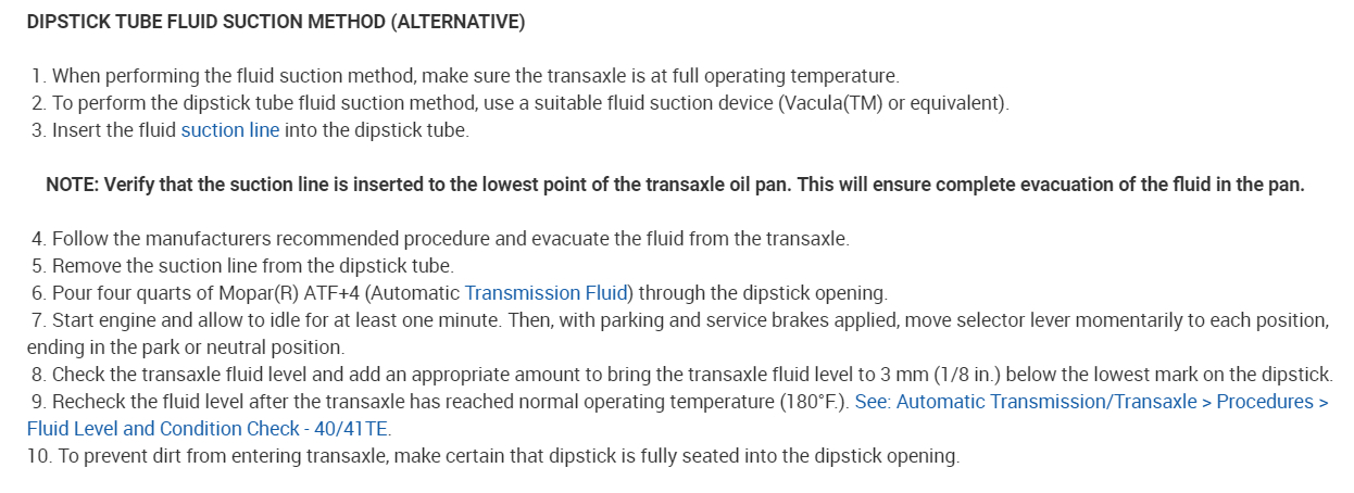

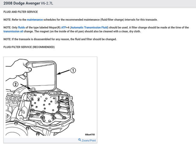

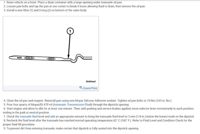

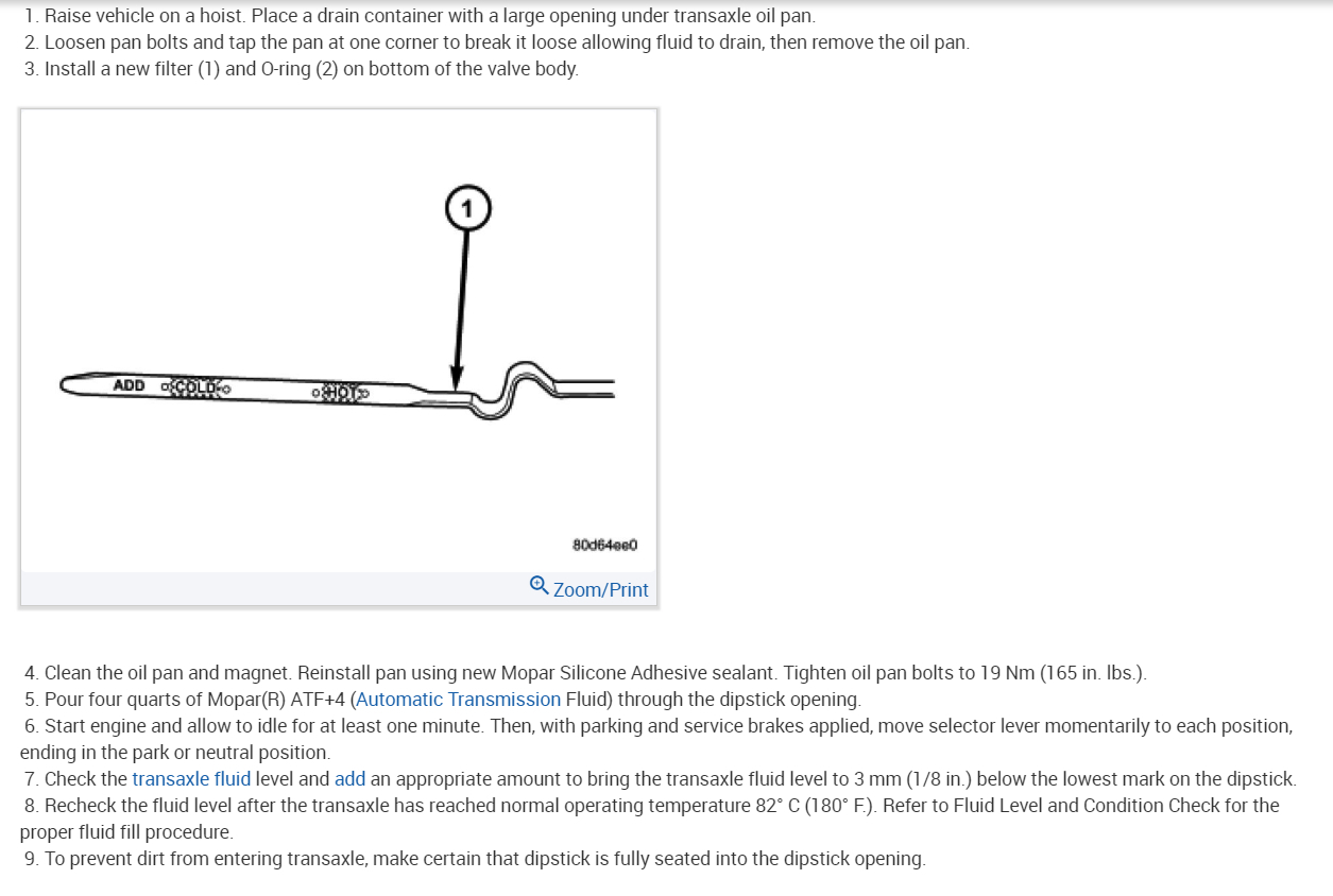

The difference in fluid temperature sounds correct is the line super hot? A cooler will help but I think we should service the transmission and see what happens. Here is a guide and diagrams below to help you get the job done. Let me know the condition of the fluid by uploading a video if you can. Use your phone and upload it in your response.
Check out the diagrams (below). Please let us know what you find.

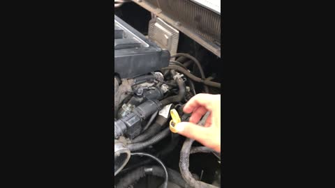

I uploaded the video. It shows the transmission fluid color and condition.

You have the cooler connected correctly and you will not be able to tell a big difference in temperature which is normal. The fluid color is good does the transmissions till slip when warm with the cooler?

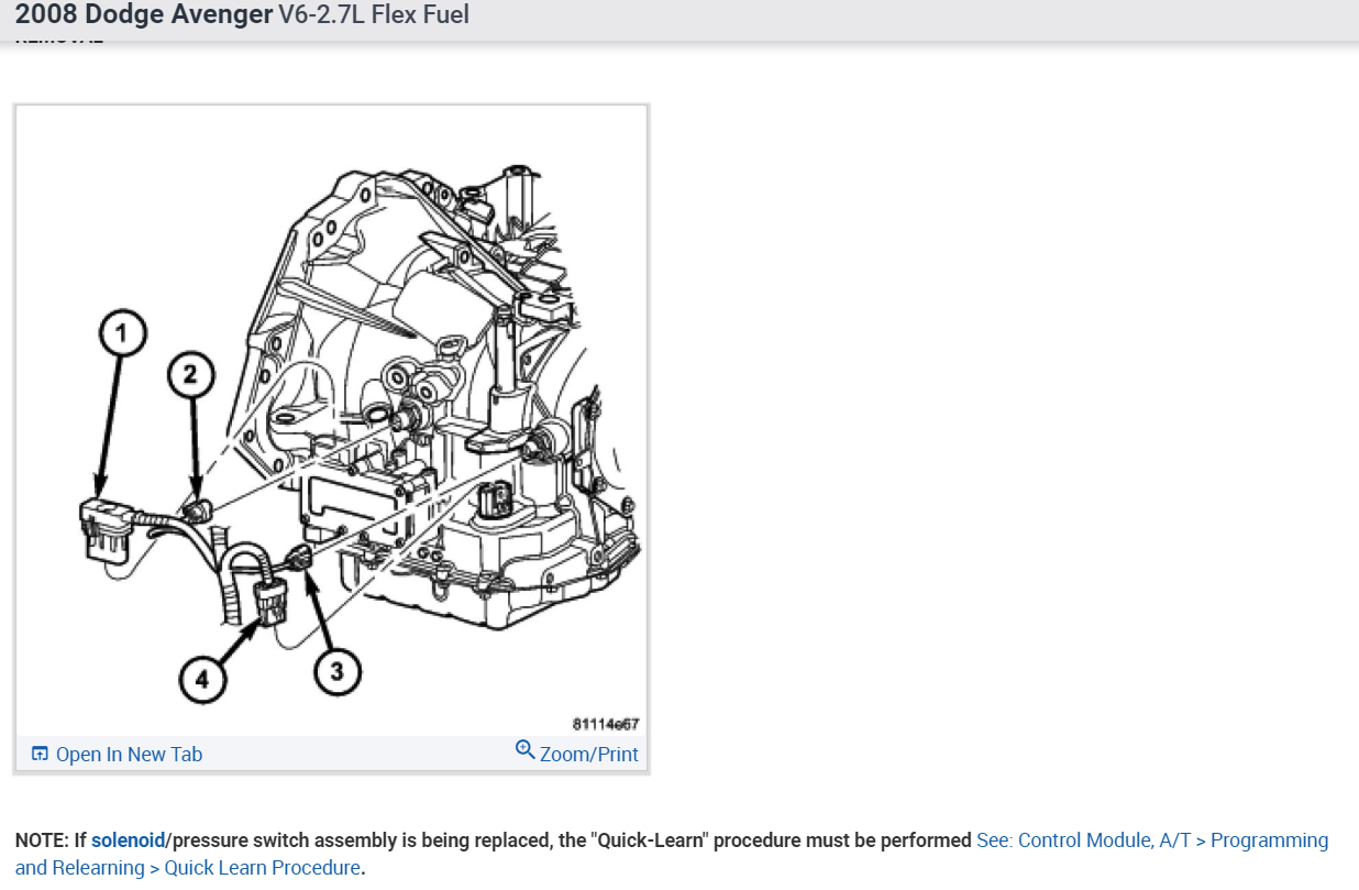

  • 55,433 POSTS

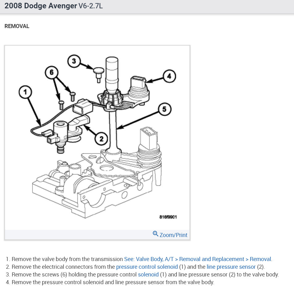

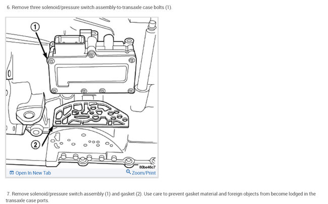

To me it sounds like you have a transmission pressure control solenoid that is going out. Here is a diagram to show you what to replace. But before you do can we run the codes to see what come up?

If the pressure control solenoid is bad will it put check engine light on? Because when I scan the PCM I do not see any codes. Can you also show picture how to change solenoid?
Aug 18, 2018 at 11:28 AM
  • 55,433 POSTS
If the pressure control solenoid is out it may or may not trigger a code depending on the failure. It is the only thing I can think of that would cause this problem. That is all the diagrams they give for the repair.

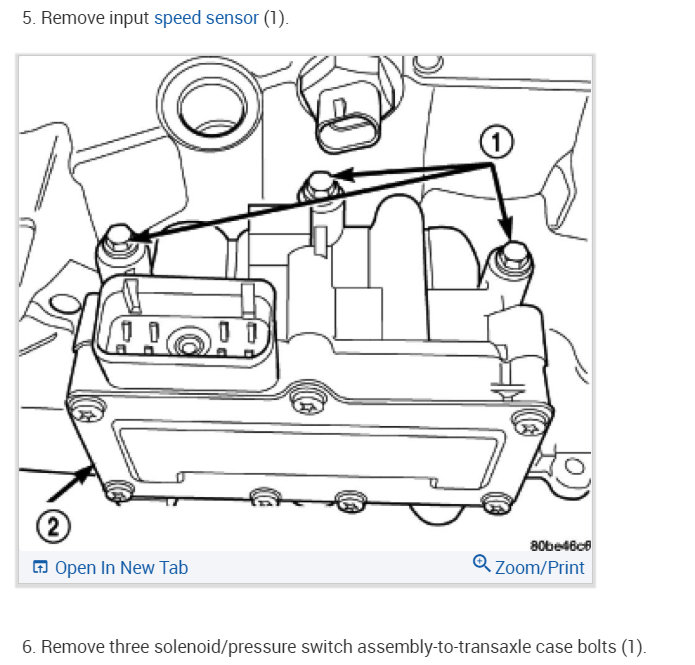

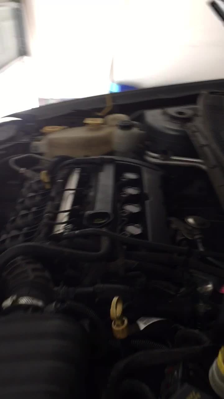

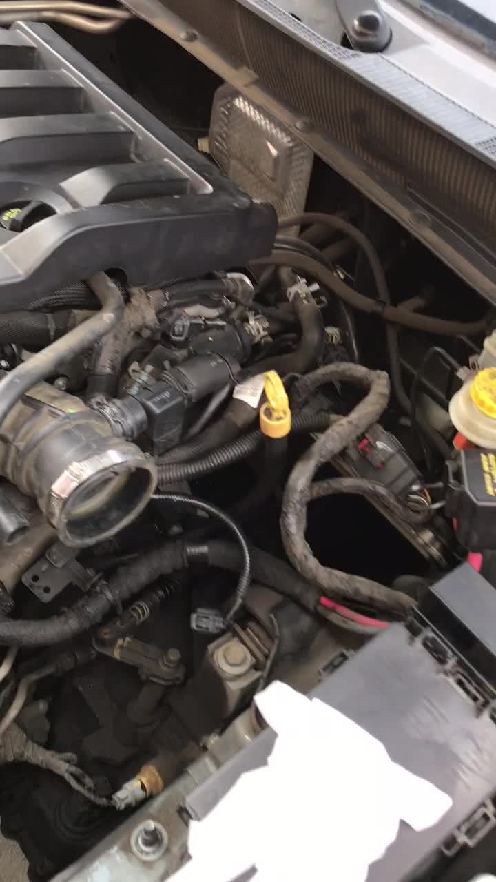

The PO700 is a general transmission malfunction which could be caused by a bad valve body or solenoids. I would remove each solenoid and test them manually using a simple 12 volt power source, They should click solid when voltage is applied, here are diagrams for the locations. Also I have seen the computer cause this issue as well. Can you please shoot a quick video with your phone so we can see what's going on, that would be great. You can upload it here with your response.
Apr 27, 2019 at 3:44 AM
DILLI
  • 24 POSTS

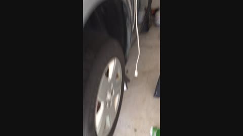

I checked the solenoid they do click when volatage is applied. I think there is something wrong with the valve body. Here is the video showing that it does move in the reverse gear and it moved in the drive too but just for couple seconds and it stalled. And then it just doesn’t move but the engines sound like it’s under load but the wheel doesn’t move

Yep, I updated the post above this one to show you how to remove the valve body which contains the solenoids so you can get the problem fixed. Please let us know what you find. We are interested to see what it is.

Your post above shows the solenoid shift control not the valve body.
May 2, 2019 at 6:58 AM
  • 55,433 POSTS
Correct, the shift control is what I would replace they had problems with them.

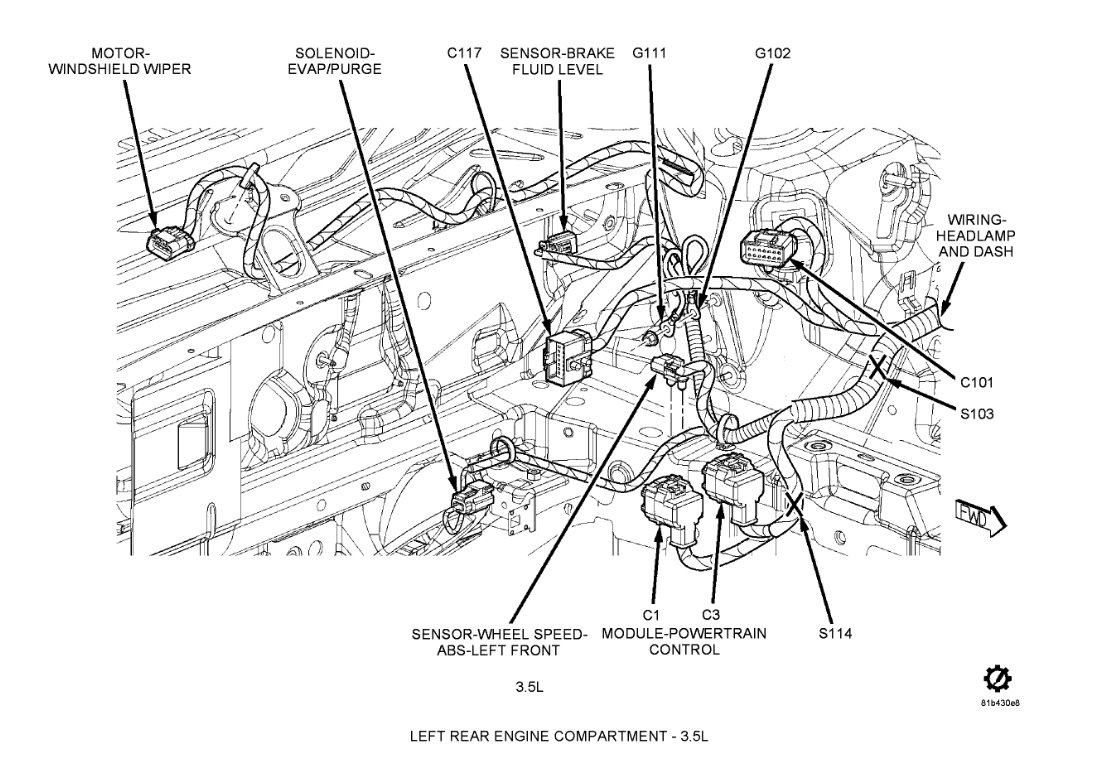

  • 55,433 POSTS

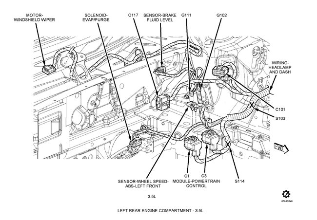

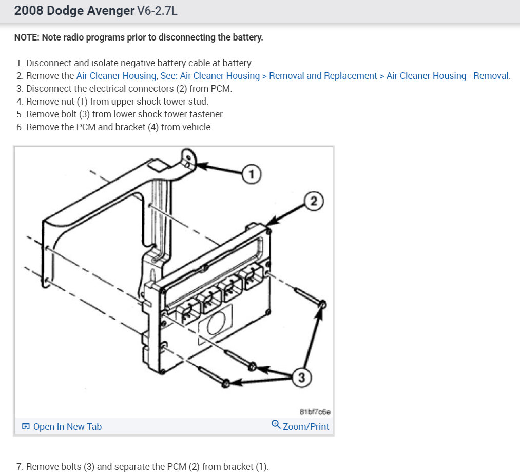

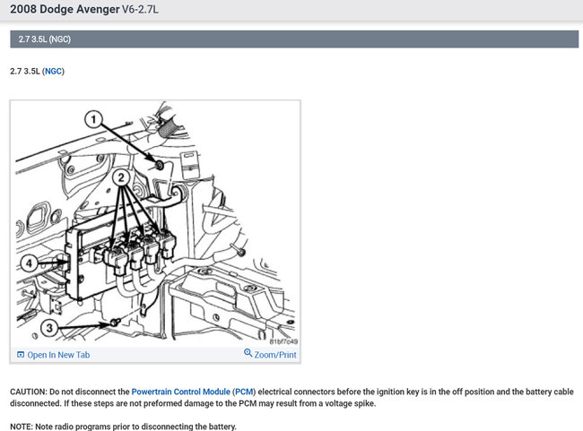

Transmission Control functions are built into PCM. PCM is mounted to bulkhead in left rear of Engine compartment. Check out the diagrams (below). Please let us know what you find.

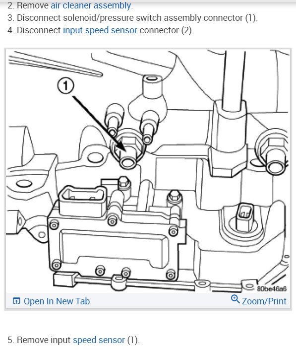

I have changed the Valve body and shift control block and all the sensor. Now the car moves in first gear but It does not shift into second gear. After first gear when It try to shift into second it feels like in neutral. I am getting three codes P1607 P0700 and P0732. I think it is maybe because of bad PCM.

  • 55,433 POSTS
Yep, that would be the next place to go, can you remove the electrical connector and check for corrosion first. Here is the location. Check out the diagrams (below). Please let us know what happens.

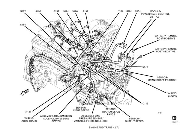

  • 55,433 POSTS
It sounds like the turbine sensor has gone bad or there is a bad connection at the in the input shaft sensor. here is the location. Check out the diagrams (below). Please get back to us.
