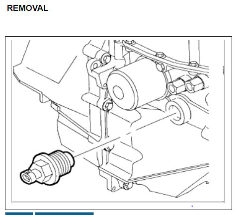

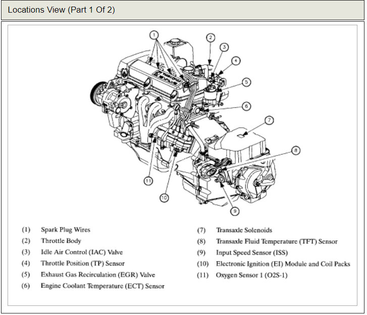

  • 55,399 POSTS
Did you try the input shaft speed sensor? This will cause the problem you are having. Here is the location. Check out the diagrams (below). Please let us know what you find.
May 7, 2018 at 6:08 AM

The output speed sensor and input sensor are the same exact sensor used for both and they very rarely fail and set other codes then gear ratio codes. It is common for the input speed sensor harness to get damaged because it is right by the transmission filter. But when they get damaged they set a code for the input speed sensor.

  • 55,399 POSTS
The problem with trying to test the sensor is you need to watch it with an oscilloscope to watch the wave form. It might test good through the winding's but perform incorrectly. It should have very little resistance.
