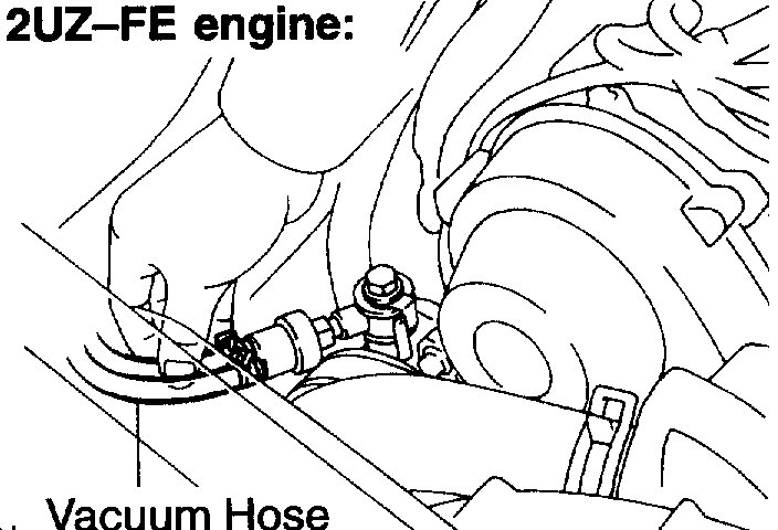

Before you think transmission overhaul check your idle air
2. Check idle-up
a. Start the engine and run it at idle.
B. Fully turn the steering wheel.
C. Check that the engine rotations decrease when the vacuum hose of the air control valve is pinched.
D. Check that the engine rotations increase when the hose is released.
This can also cause the transmission to shift hard
I would also recommend smoke your system to make sure you done have a broken vacuum line.
