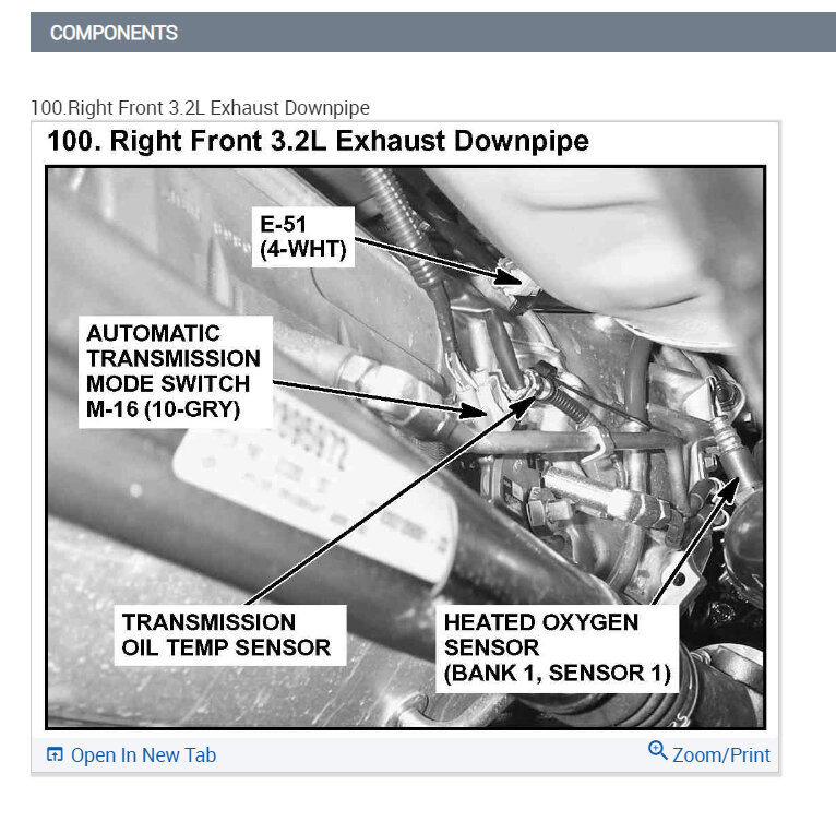

How to calibrate it when replacing?
Oct 12, 2022 at 3:38 AM
  • 55,405 POSTS

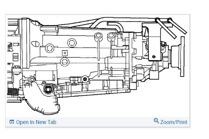

They don't show that it needs calibration, so I would put the transmission in neutral and adjust the sensor, so the engine cranks over and then tighten it down. This is what they give us. Check out the images (below). Please let us know what happens.
Oct 12, 2022 at 10:55 AM
GHOST2U
I've been trying to locate the transmission range sensor but can't find the part #. Can you help
