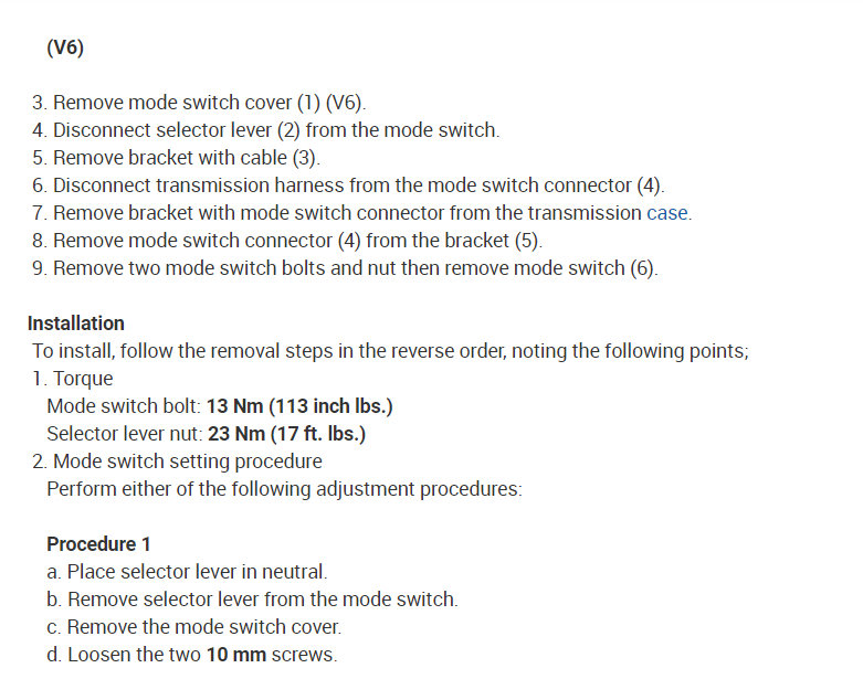

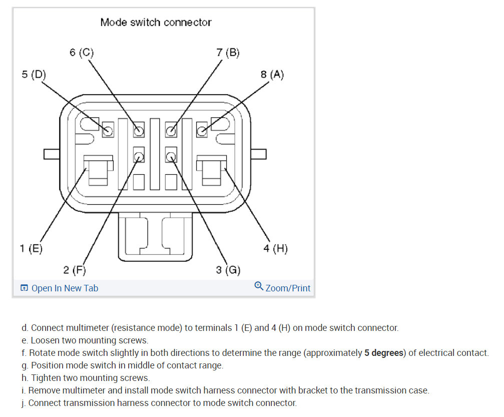

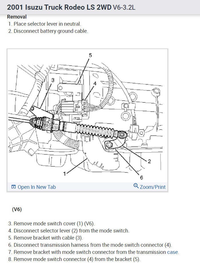

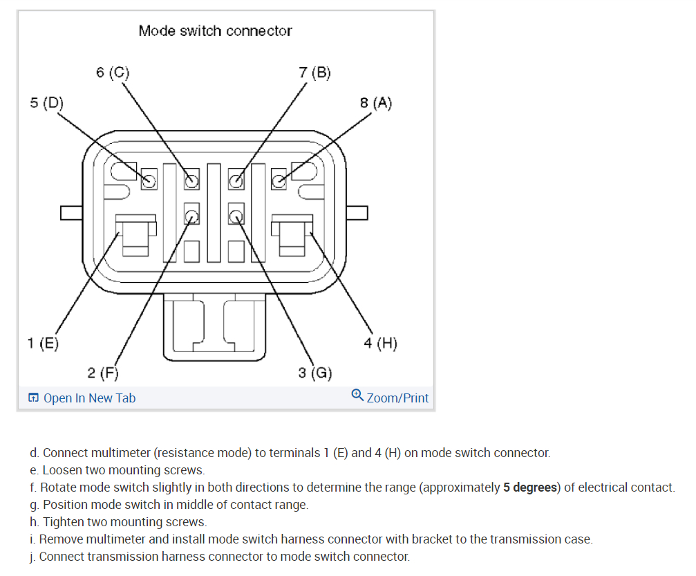

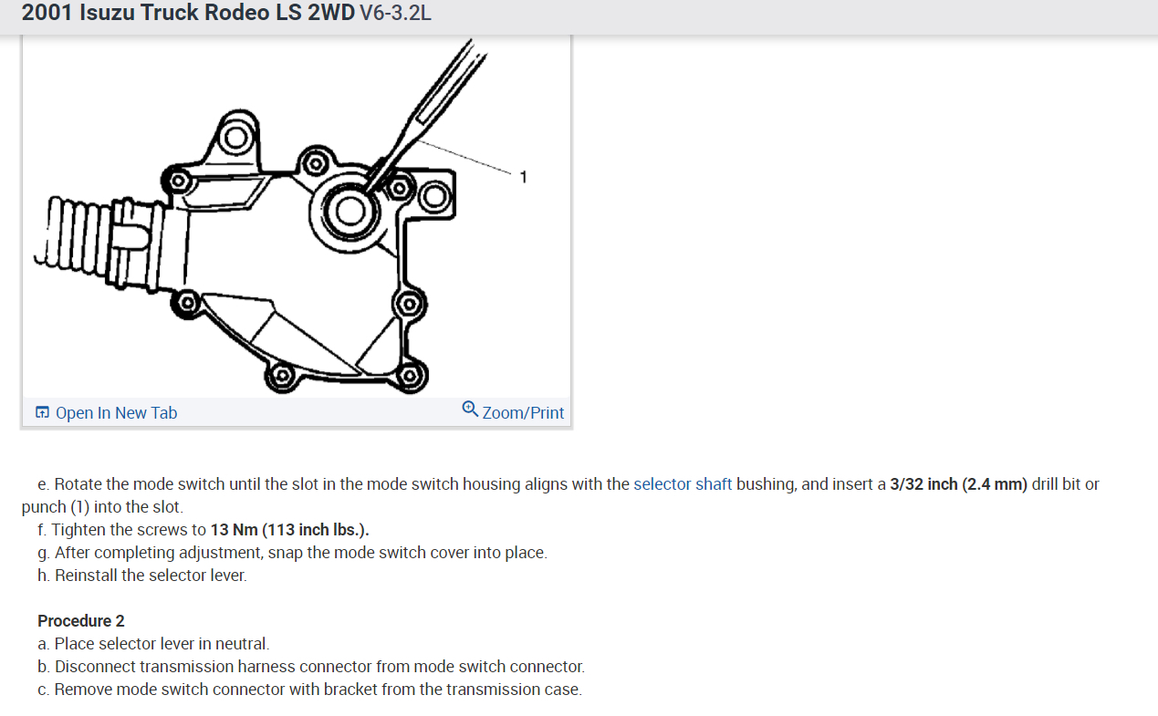

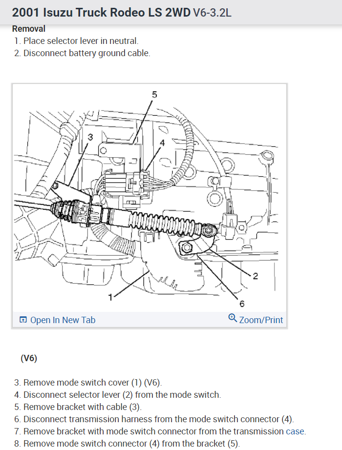

do you have a check engine light on? this doesn't sound like a neutral safety switch issue to me.it sounds like a t.c.m. issue or speed sensor issue.let me know about that light. Check out the diagrams (Below). Please let us know what you find.
