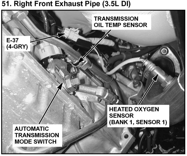

Check transmission light came on, had scanned at auto parts store. Code P0705. how do I fix. Any advice? is it where I can fix it myself?
Nov 23, 2017 at 10:48 PM
KHLOW2008
  • 41,812 POSTS
This is a transmission range switch fault code and it could possibly be due to poor or bad connections or a faulty switch. Switch is located on top of transmission and is where the gear shift cable is attached to.
This switch fails quite often due to water entry via the center seal so having a bad switch is not surprising.
It should look something like the one in the picture. Check the connector for contamination, looseness or broken wires. Ensure the cable that is attached does not have too much free play which would affect the resting position of the switch as compared to the gear shift position.
Replacing this component is not difficult but after replacement you would need to calibrate its position so that it matches the gear shift position. The two holding bolts have slots that allow the switch to be moved clockwise or anticlockwise to get the correct adjustment.
The diagram I have shown is general and if you do not see the switch on top of transmission, it could be at front. Locate the gear shift cable to trace it to its location.

P0705 = Transmission Range Sensor Circuit Malfunction (PRNDL Input)
that would be the mode switch located on the side of the transmission. The basics are that you disconnect the battery, Remove the shift linkage nut and the lever from the trans shift shaft. Then remove the two bolts and the switch, unplug the electrical connector and reverse the process to install the replacement.
