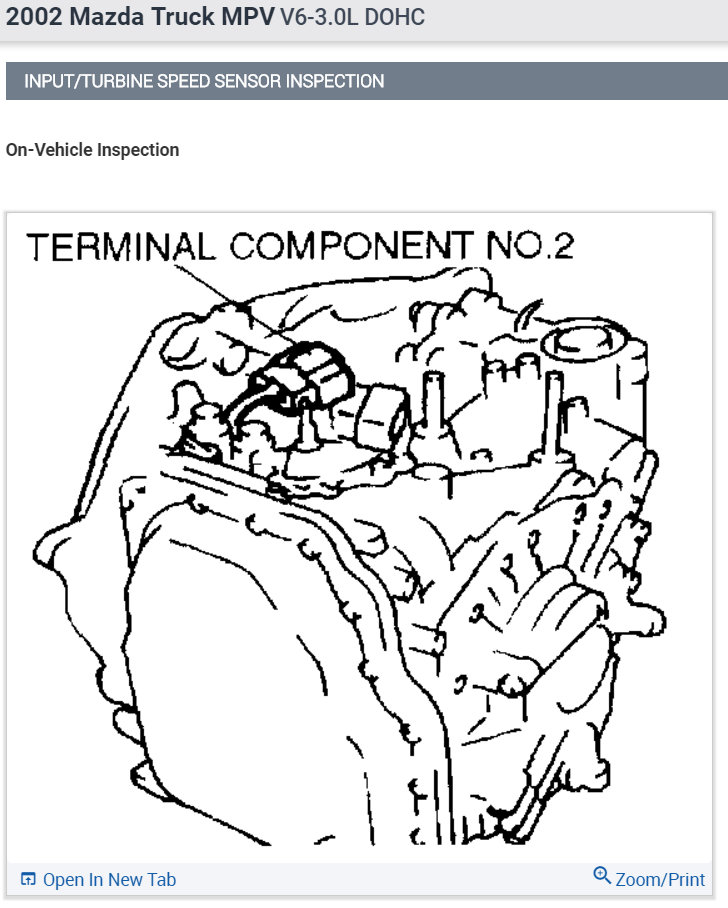

This sounds like the input shaft speed sensor is not working right but to be sure lets run the codes to see what comes up.

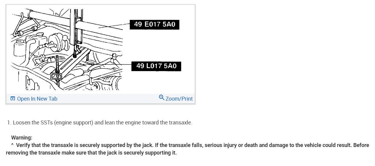

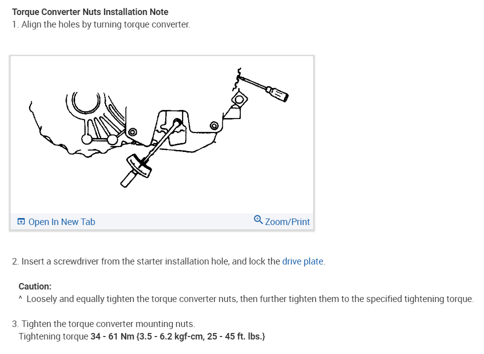

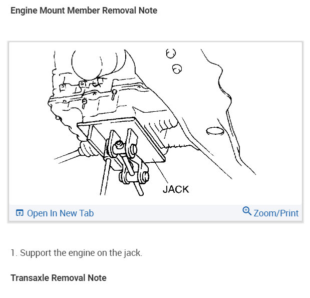

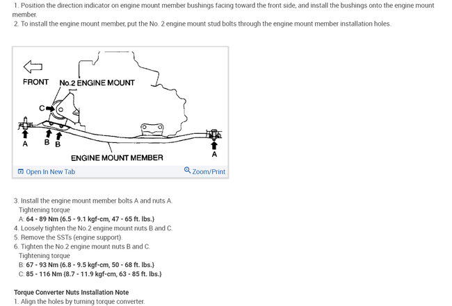

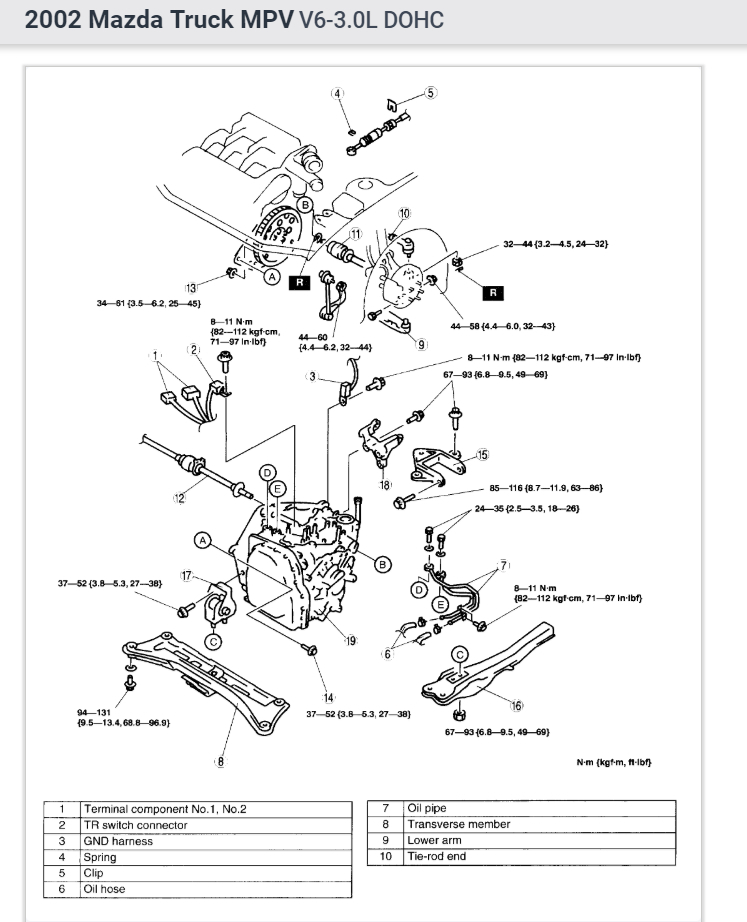

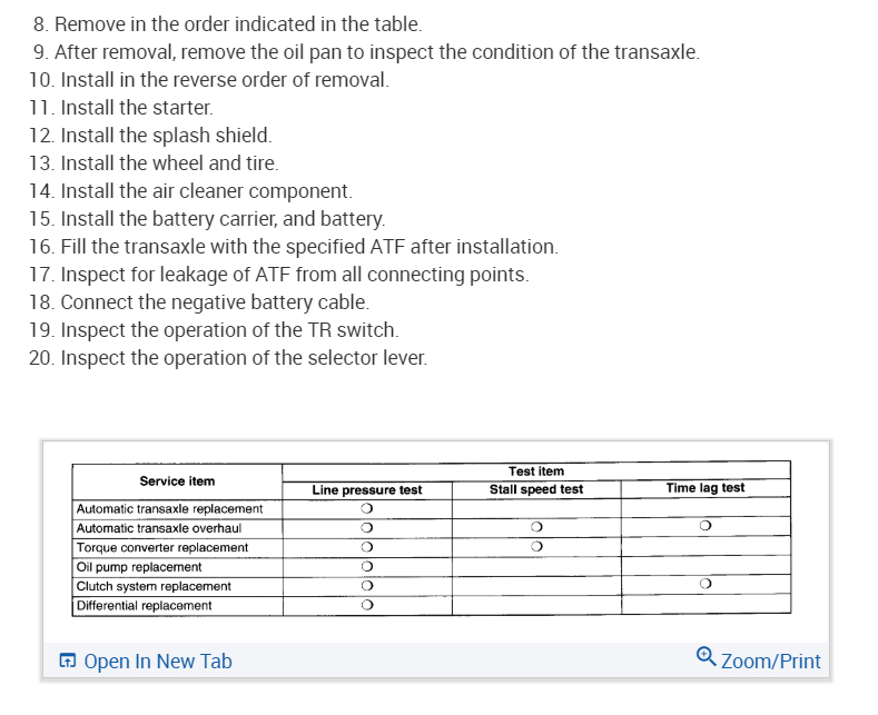

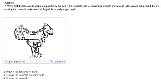

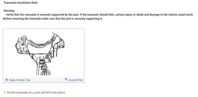

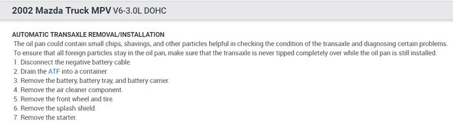

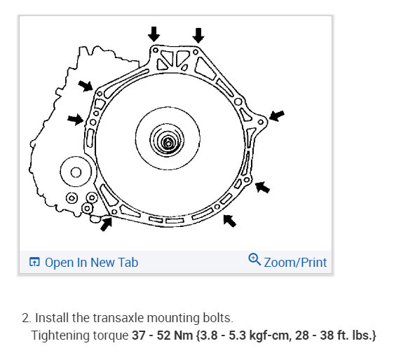

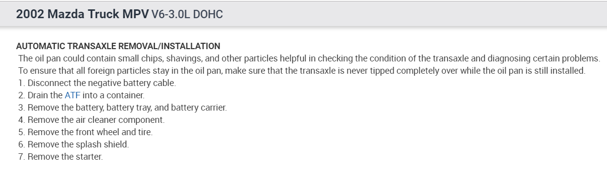

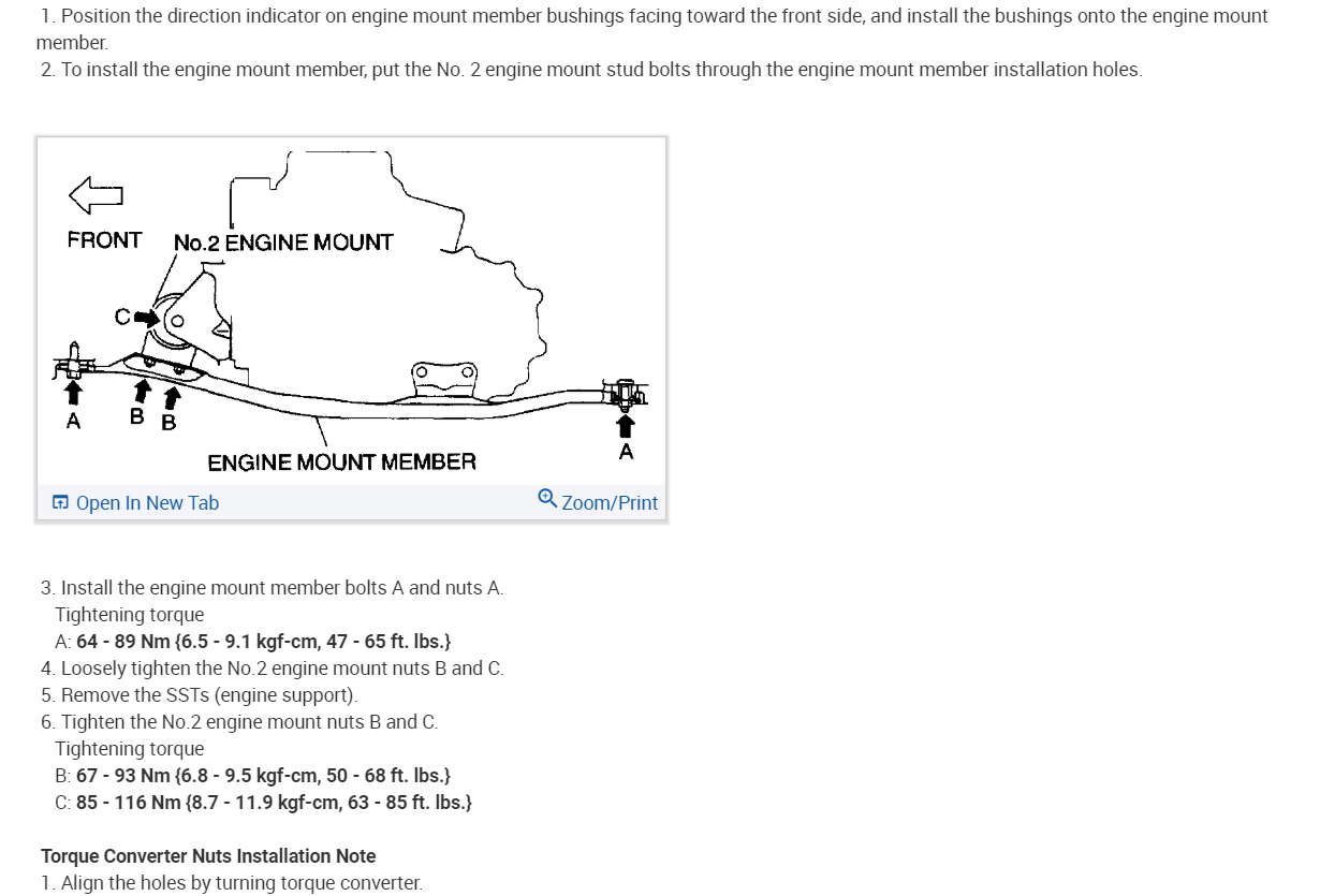

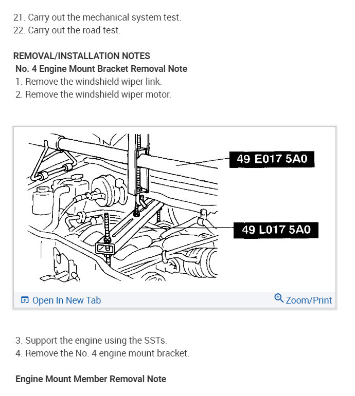

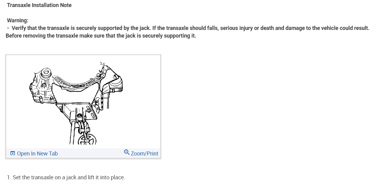

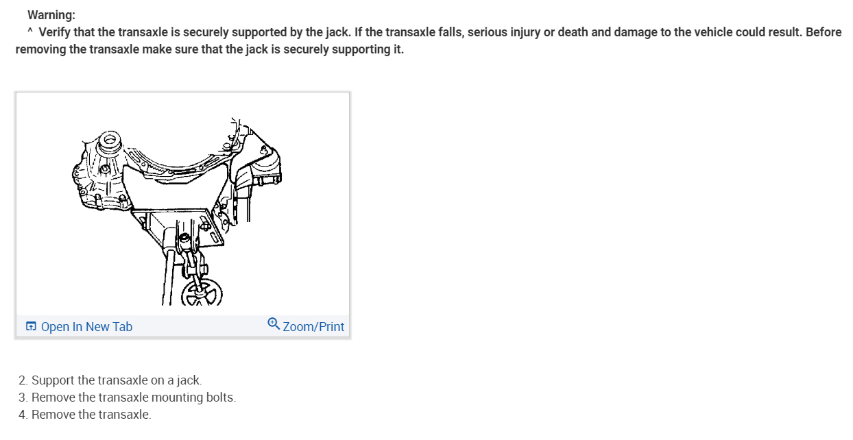

Even though you do not have a code for it I would try an input shaft speed sensor. If that does not fix it the transmission is probably bad.
Here is a video that will help you see what to do to get the transmission out (different car but the process is the same) and diagrams below to show you on your car:
