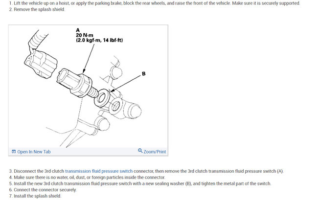

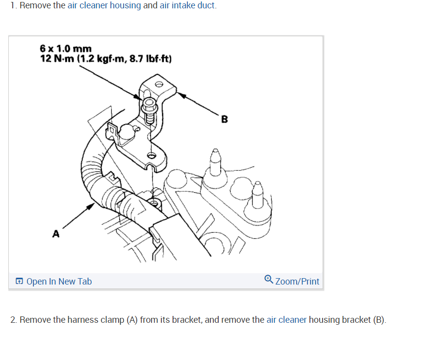

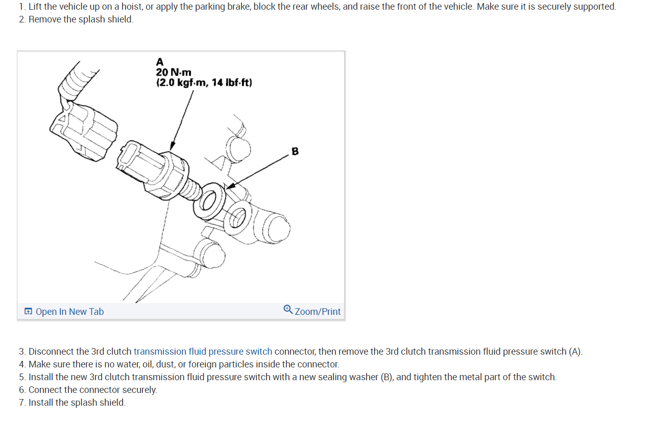

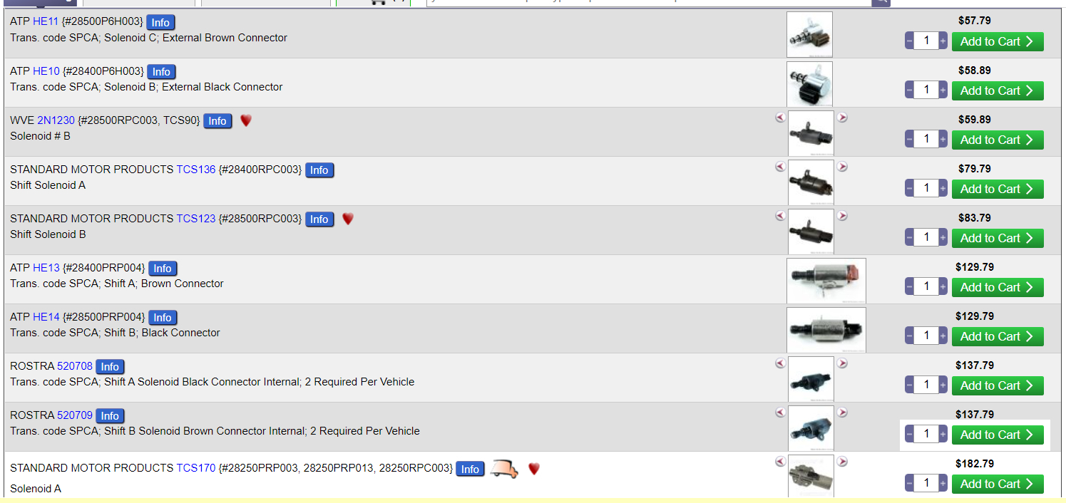

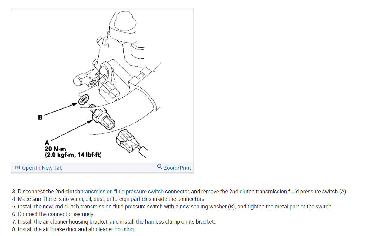

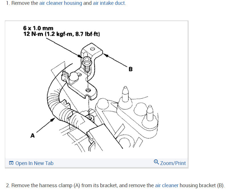

Could someone please tell me if sensor numbers 28600-P7W-003, and 28600-P7Z-003 work on my car listed above DX? If so, which one goes up front, and which one under the air filter box? If not, could someone please tell me the correct numbers to use, and in what place to install them. Also, the correct number for the chrush washer will be greatly appreciated. Thanking in advance.

Good afternoon,
No, those numbers show nowhere for your car.
I attached the list of sensors and switches from Rock Auto for you to view. The numbers for the OEM are there. You will need to remove the old sensors and match the numbers.

I received the numbers that I posted from Advance Auto, so I then called a Honda dealership and asked. Honda has their own OEM numbers, but they assured me the numbers I posted would work. I was hoping to have the correct sensors to install once I removed the old ones. Getting a bit too old to be climbing in and under cars. Thanks for your help.

The diagrams are very helpful. Thanks again.
