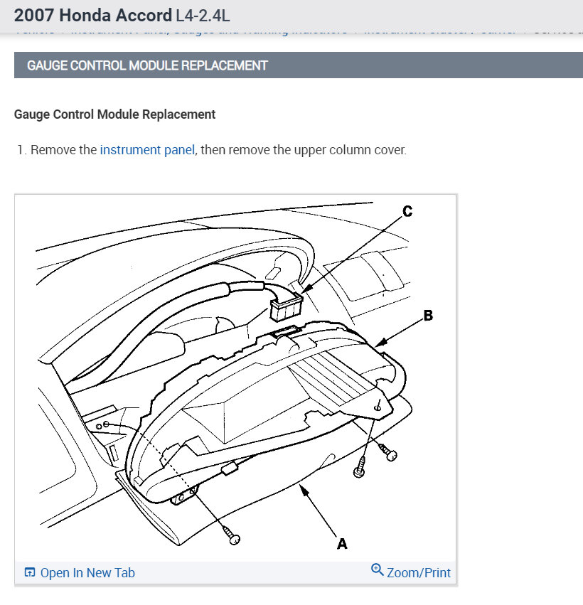

My transmission has been slipping. Some days it's okay, other days, not so good. At the same time, I'm experiencing various, intermittent electrical problems. These include the clock display, vanity lights and radio speakers. Also, sometimes my shifter won't shift out of park. Can these problems possibly be related? I sure hope so.
Jan 20, 2023 at 1:33 AM
  • 55,256 POSTS
The only thing that can tie these problems together is the gauge control module, you can confirm the failure be doing a CAN scan, you can get a CAN scanner (Controller Area Network) from Amazon.
here is a video to show you how:
https://youtu.be/u-4syLc-ifQ
and

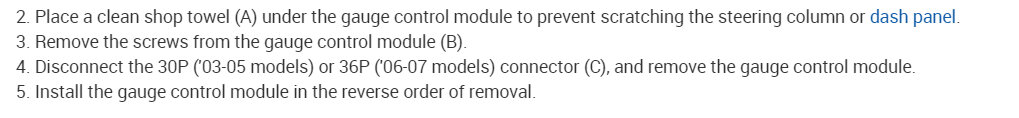

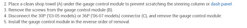

Here are the instructions for replacing the gauge module which you can get a rebuilt unit by searching google or eBay. Check out the images (below). Please let us know what happens.

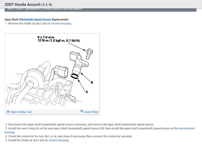

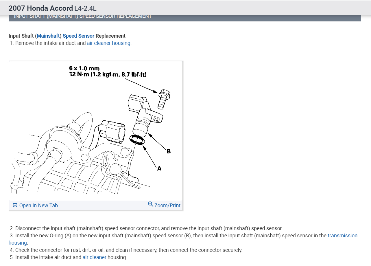

With the transmission fluid low, it could have burned up the clutches or there is a change the input shaft speed sensor is off causing the slippage. Here is the location of the sensor so you can change it out. Also, can you recheck the fluid condition and smell if it is burnt? Let me know.

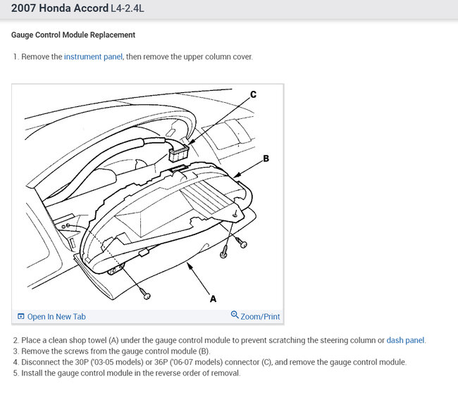

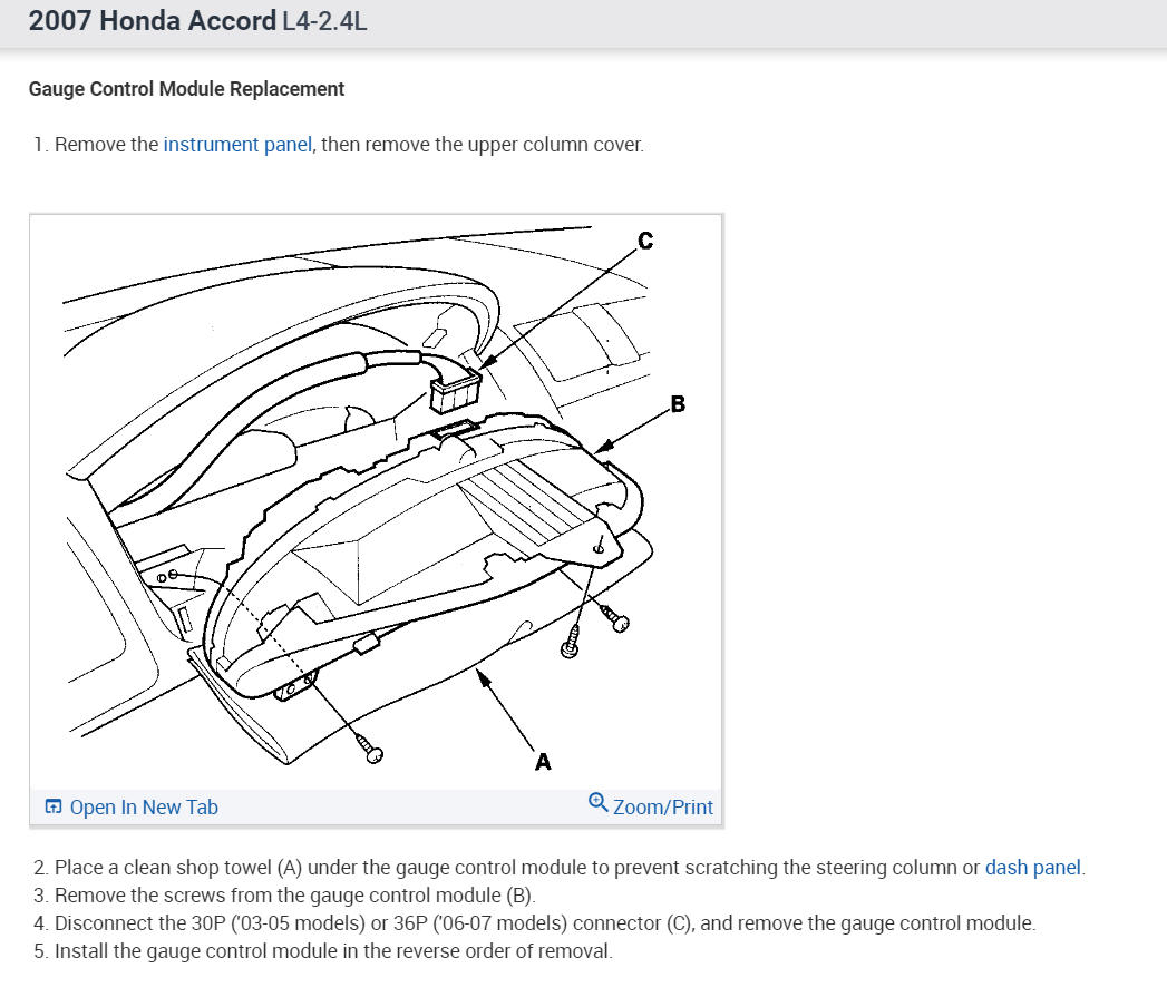

Yes, this can cause the code to come on, but I don't think it will help with the other issues such as the transmission not coming out of park, clock display, vanity lights and radio speakers. I would say the gauge control module is going out. Here is the location I would tap on it to see if anything changes while the engine is running. You can get a preprogrammed unit by searching Google or Ebay. Check out the images (below).
