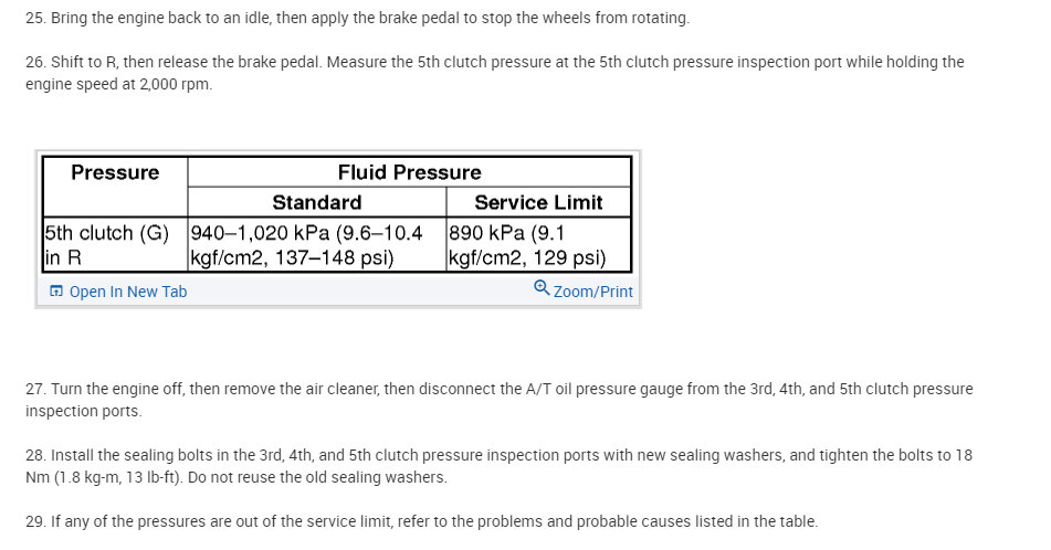

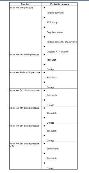

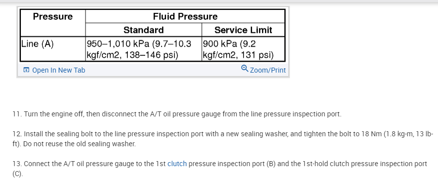

What you described sounds like it could be related to a line pressure issue. When it happens, does the gear indicator show it is still in drive?
What I would start with is to check for diagnostic trouble codes via the can-bus. CAN stands for controller area network. Basically, the computers/modules are tied together via a few wires. This type of scan will retrieve codes regardless of the module storing them.
Here is a link explaining how it's done:

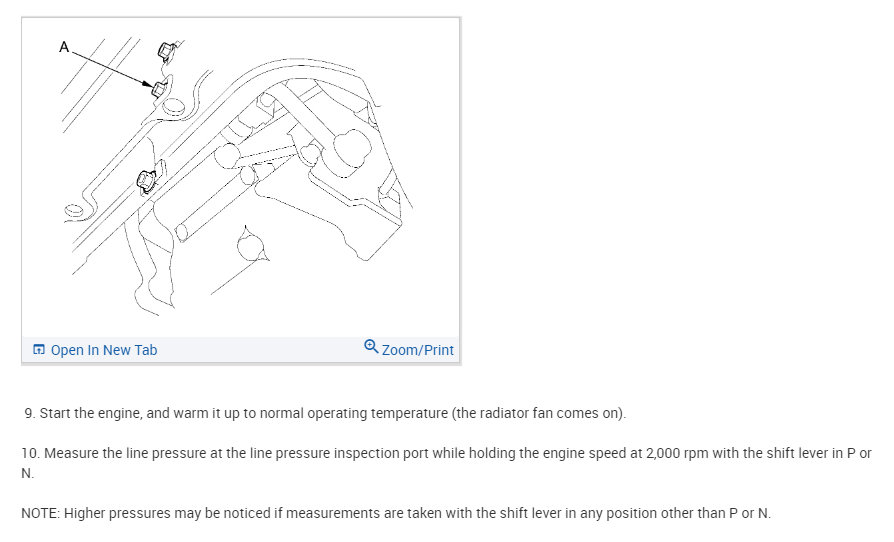

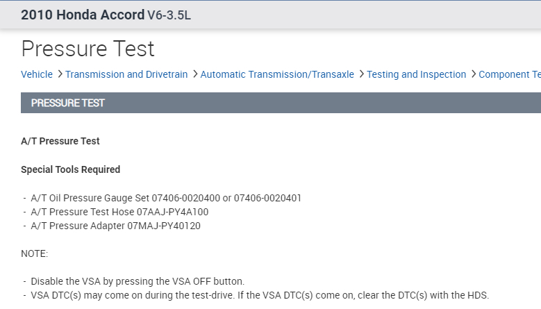

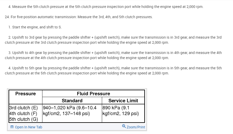

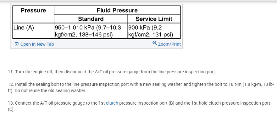

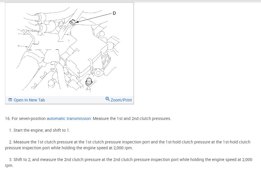

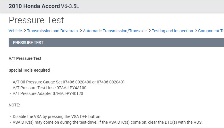

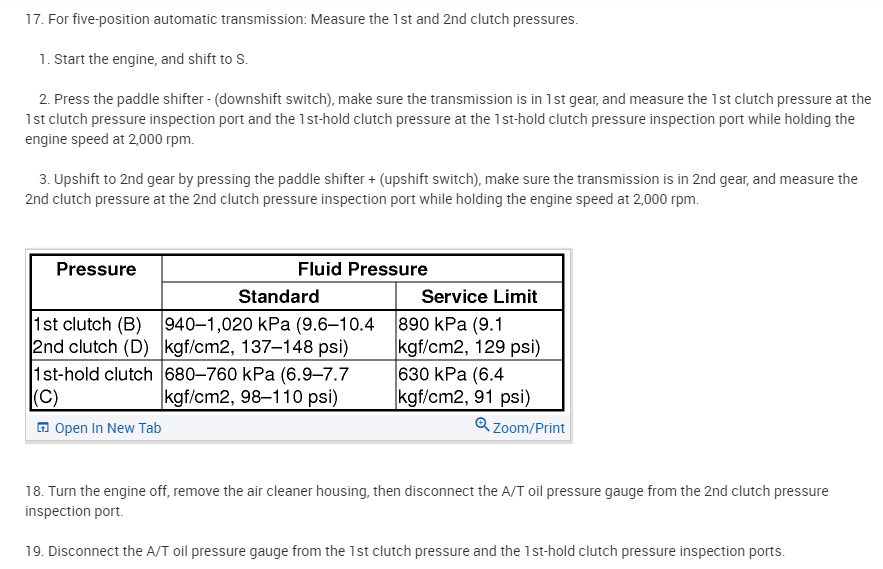

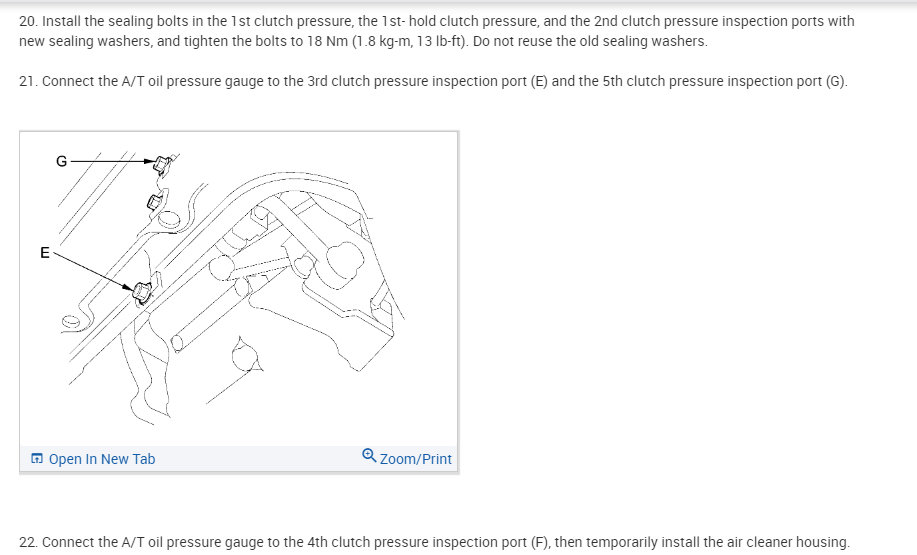

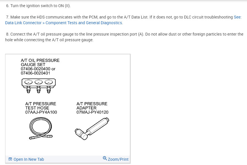

I attached the directions from the manual for testing line pressure, but it is somewhat involved. Take a look through them and let me know if it is something you feel comfortable performing. Keep in mind, scanning the CAN is likely the easier thing to do first.

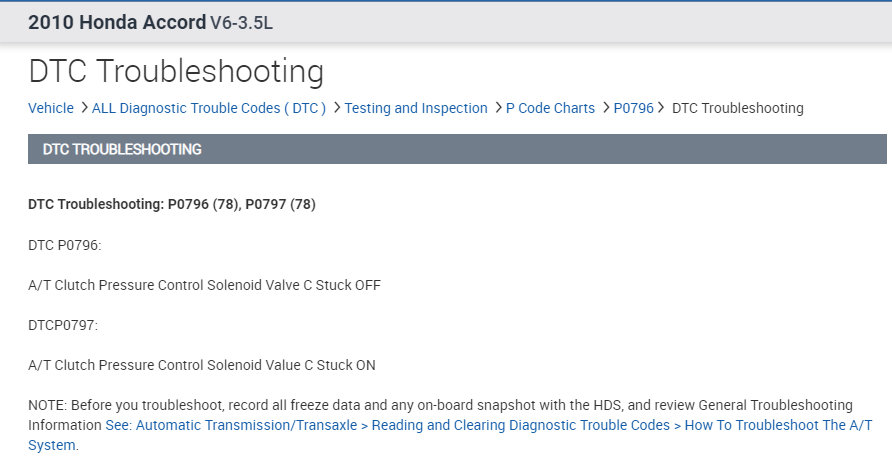

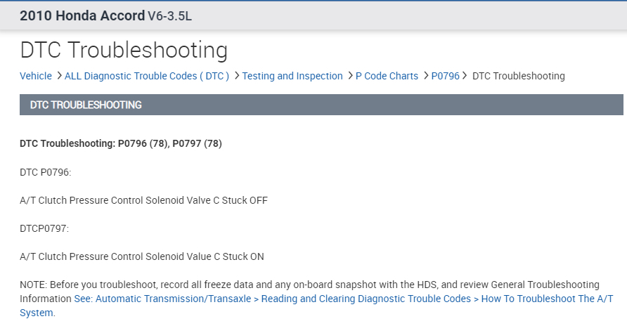

Okay, so, I just put the reader on the car and there are two codes and it would appear that you were correct because the codes are 1) pressure control solenoid C stuck off and 2) is shift solenoid stuck on. Thanks again in advance for any help!
Sep 25, 2022 at 3:35 AM
  • 110,244 POSTS

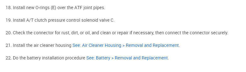

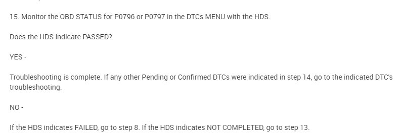

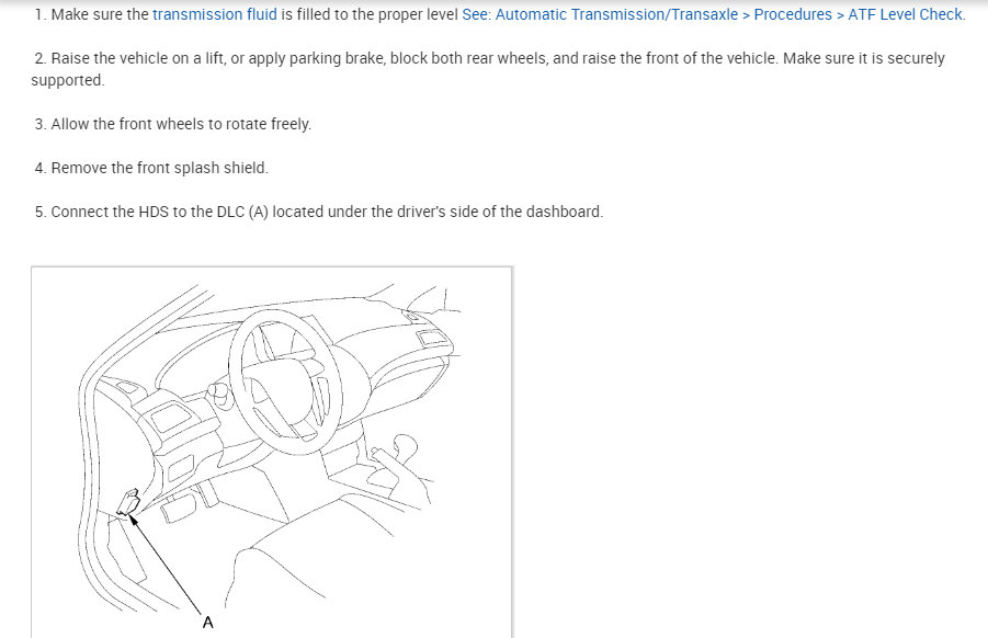

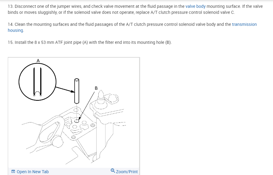

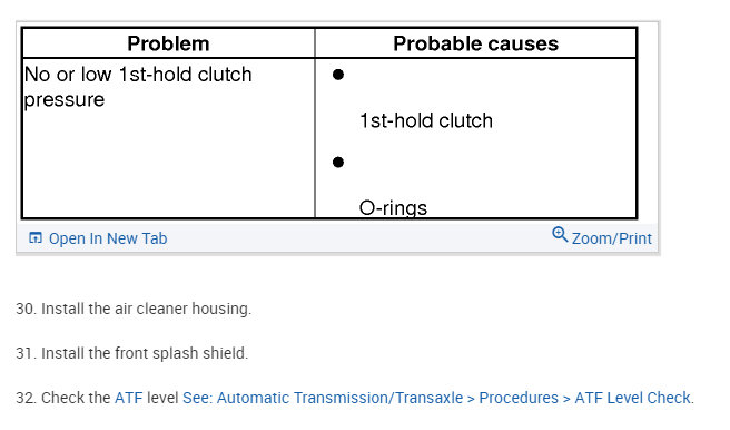

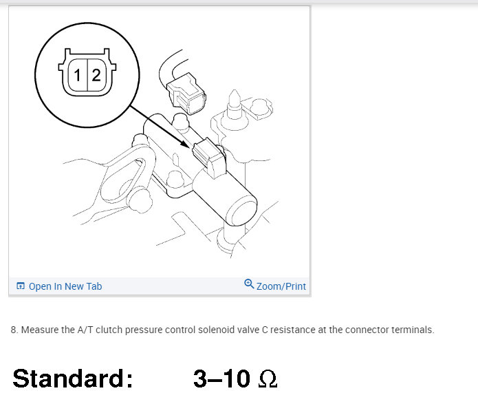

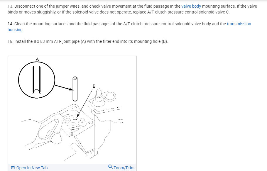

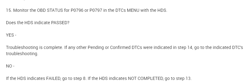

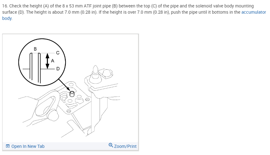

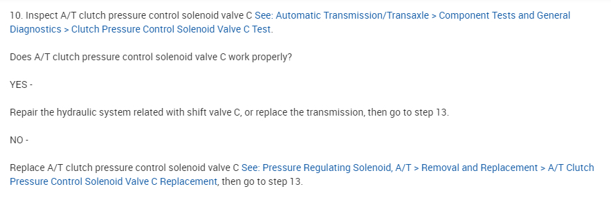

Okay, we can fix this. By chance, could you provide me with the codes that were found? I need to know the possible causes.

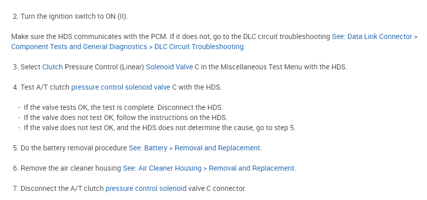

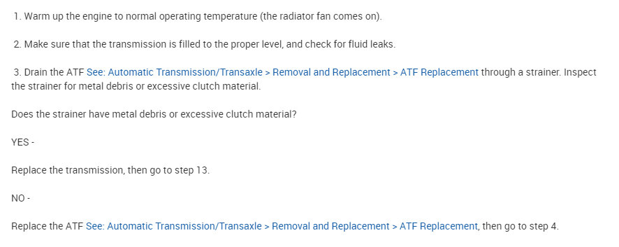

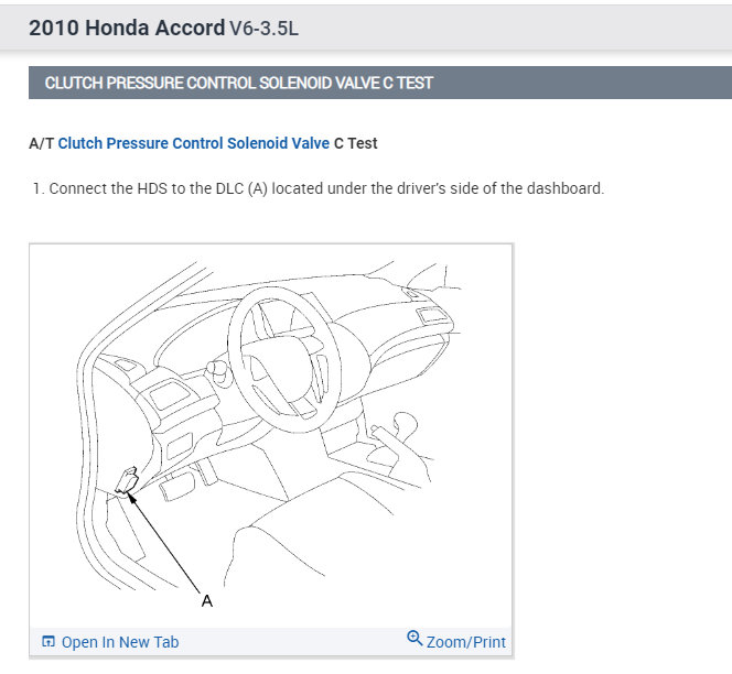

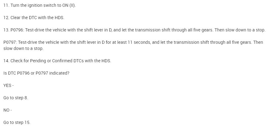

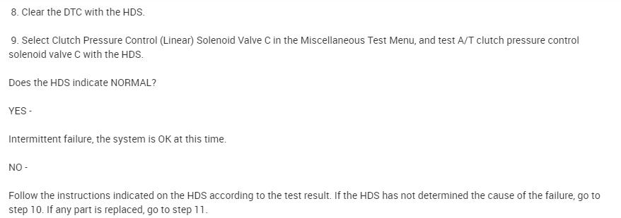

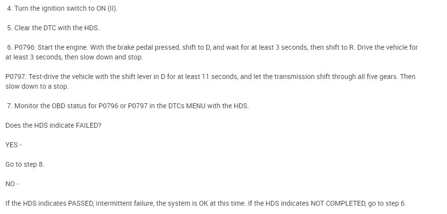

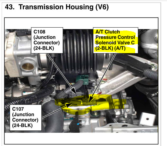

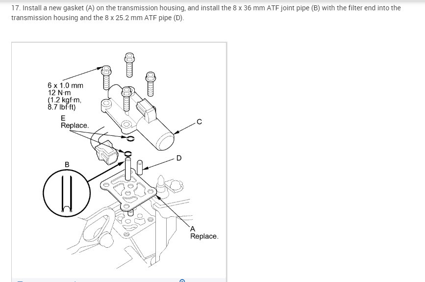

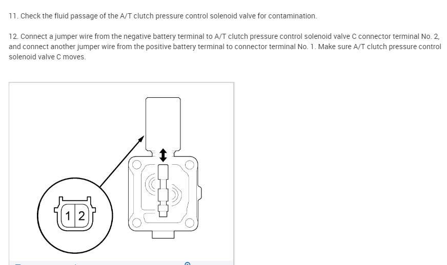

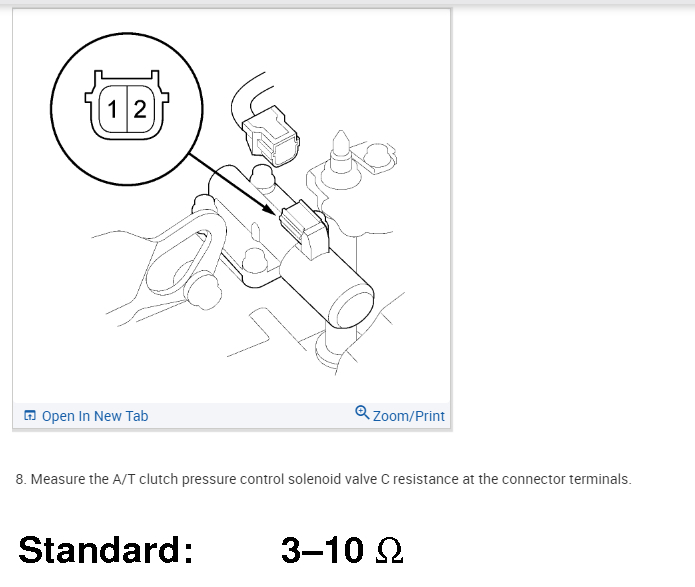

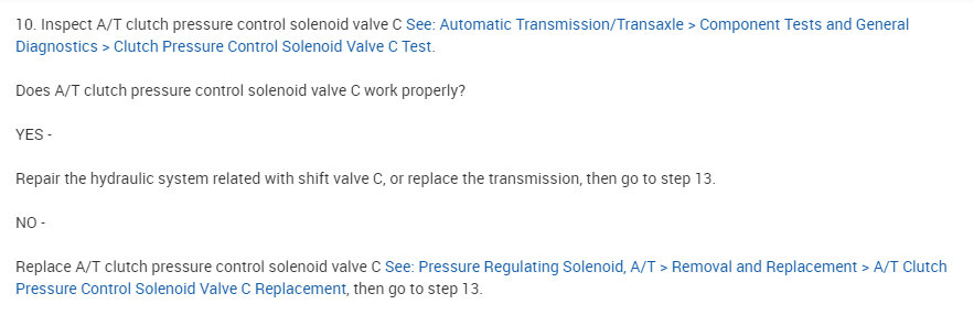

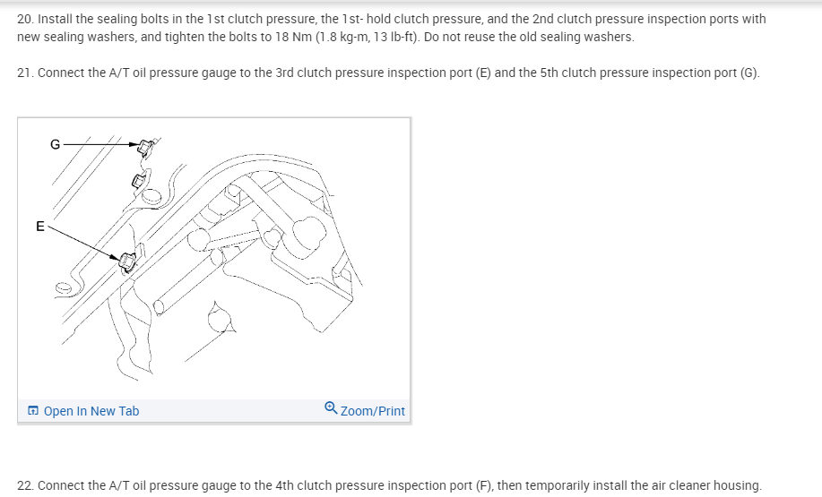

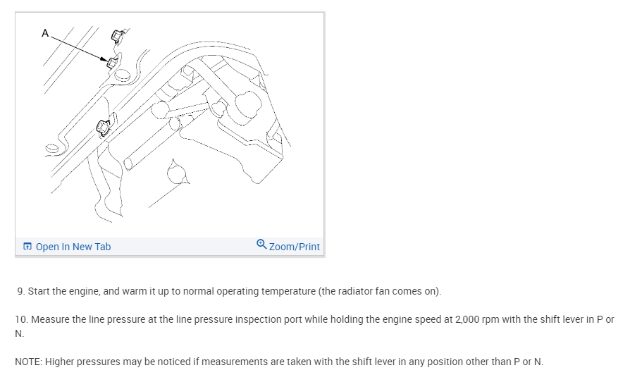

Also, I attached a general diagnostic test below related to the pressure solenoid C. Take a look through it and let me know if you are comfortable performing it. I suggest starting with this solenoid because the other code you have could be the result of this failure.

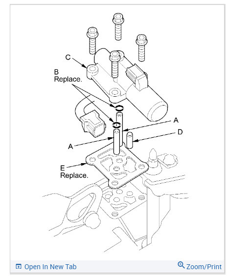

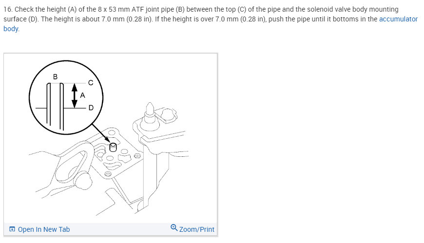

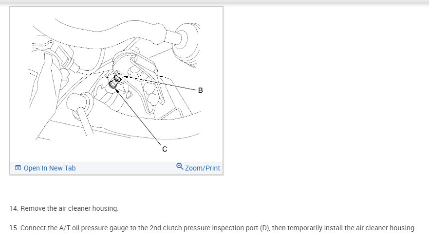

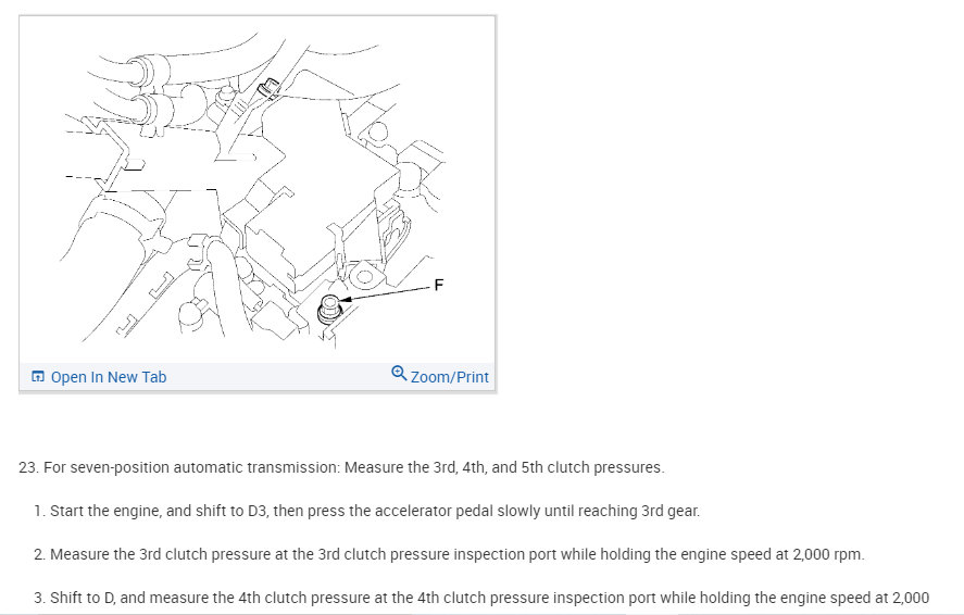

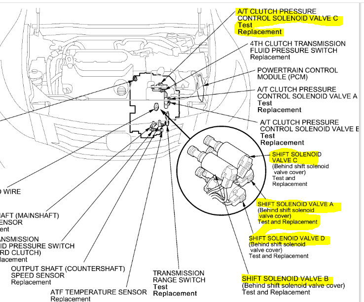

The last two pics are to help locate solenoid C.
Let me know what you find.

P0767 and p0796. thanks again.

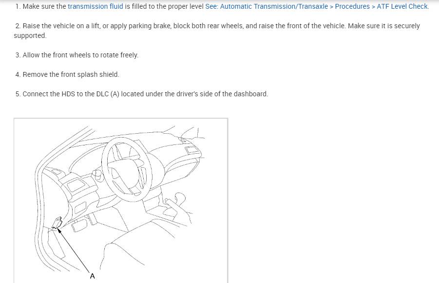

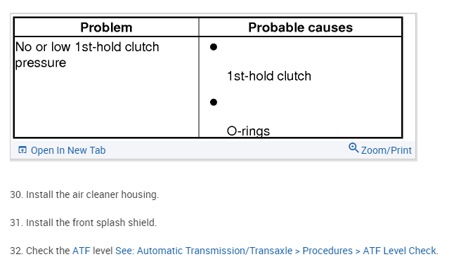

Okay. Based on the codes, I still feel the pressure solenoid is where we need to start. I attached the diagnostics below. However, they require a scan tool that can communicate with the different modules on the vehicle. I'm not sure if you have one.
Take a look through the diagnostics and let me know if you are comfortable performing them.
Take care and I'll watch for your reply.

Just an update: I changed the transmission fluid tonight and when I strained the old oil it was completely clear no debris or anything did not smell burnt was just a little darker than when new. so, I'm going move on to the solenoid testing and most likely replacing on Friday when I get paid, I will let you know what I find.
