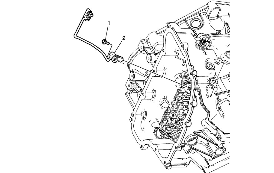

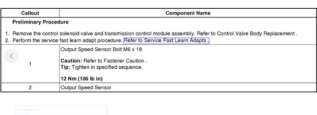

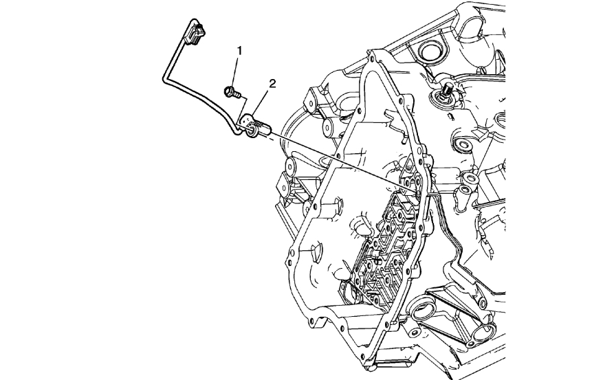

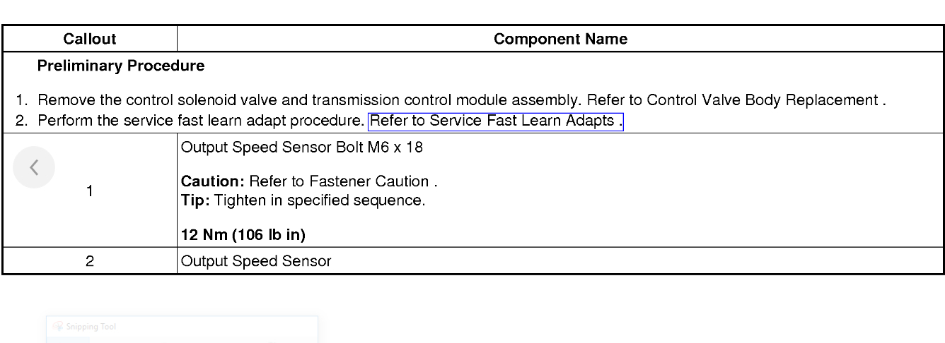

Can someone please tell me where the transmission output speed sensor is located?
Mar 1, 2018 at 9:20 PM
Good evening.
The output speed sensor is under the valve body inside the transmission. you would need to remove the cover for the valve body, remove the valve body to gain access to the sensor.
Pictures attached.
