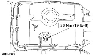

I just changed the transmission to my neighbor's truck and I need to know how much fluid I have to put in for it (the transmission) to function properly.

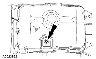

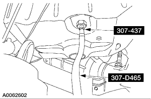

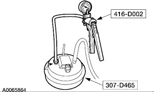

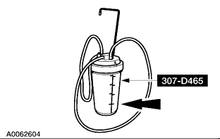

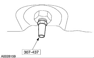

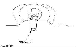

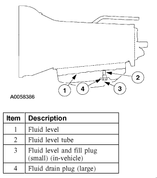

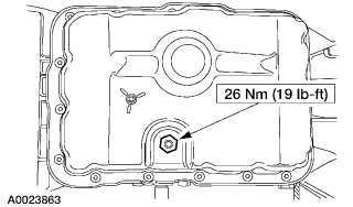

There is no specific amount given for servicing. You will need to follow the fill procedure I am posting. The pictures at the bottom are in the order as the instructions. Also, make sure you use Mercon V or you could have transmission failure. Here is the procedure:
Fluid fill reference:
Note: Left side of case is shown.
Draining:
With the vehicle in park, position it on a hoist. Set the vehicle as close to level as possible.
Remove the drain plug (large plug) and allow the fluid to drain.
Refill
Large plug

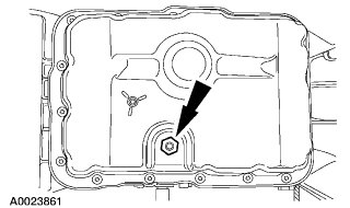

Install the fluid drain plug.

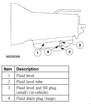

Hold the larger drain plug with a wrench and remove the small (center) fluid level indicating plug.

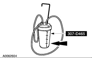

Install the special tool into the pan.
Note: Prior to filling the special tool with clean transmission fluid, make sure that the canister is clean.
Fill the special tool with clean automatic transmission fluid.
Hang the special tool under the vehicle, upright and close to the transmission.
Connect the special tools.

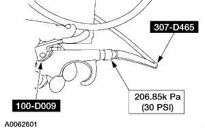

Connect the open end of the fluid hose from the Fluid Transporter/Evacuator/Injector to the, Fluid Level and Fill Plug Adapter at the bottom of the transmission fluid pan.
Apply a maximum of 206.85 kPa (30 psi) to the open end of the vacuum/pressure hose from the special tool. Fluid will immediately start flowing out of the special tool into the transmission fluid pan.
Add two or three quarts of transmission fluid into the fluid pan. Stop the process by releasing the air pressure and removing the air nozzle from the end of the hose.
NOTE: Engine idle speed is approximately 650 rpm.
Start and run the engine until the transmission fluid temperature is between 27°C - 49°C (80°F - 120°F).
Inspect the fluid level in the special tool. If the fluid drains back into the canister, the transmission is full. If no fluid drains back more fluid will need to be added. Repeat steps 9 and 10.
Once the transmission is full, place a hand vacuum pump on the open end of the vacuum pressure hose of the special tool and apply vacuum to the system. This will pull out any extra fluid trapped in the system and direct it into the container.
Allow the fluid to drain. When the fluid comes out as a thin stream or drip, the fluid is at the correct level.

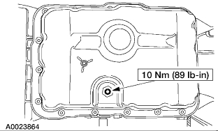

Reinstall the small (center) fluid level indicating plug.
