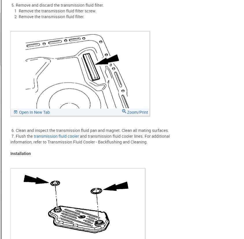

Thank you for your time and help. I'm about to do a transmission fluid change on this Car but I cannot seem to find the location for the new fluid. There isn't a separate tank visible for the new transmission fluid. How do I fill it up?
Sunday, July 4th, 2010 AT 7:23 AM

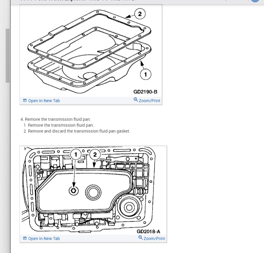

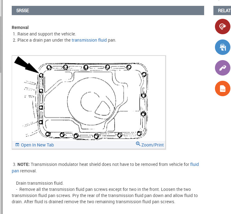

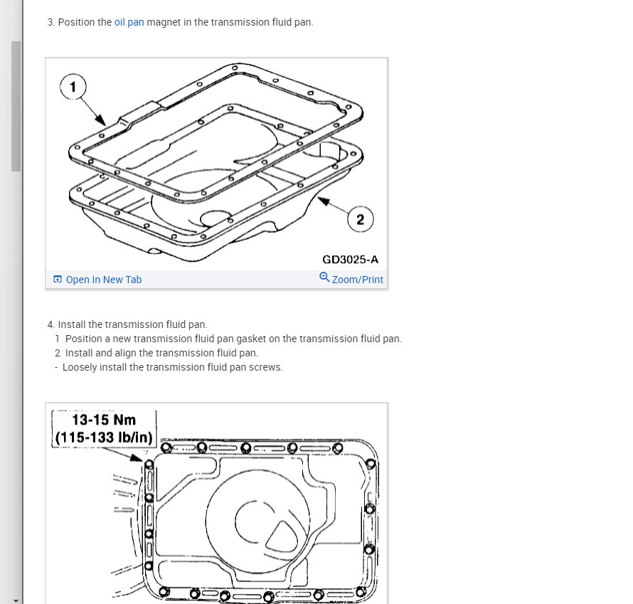

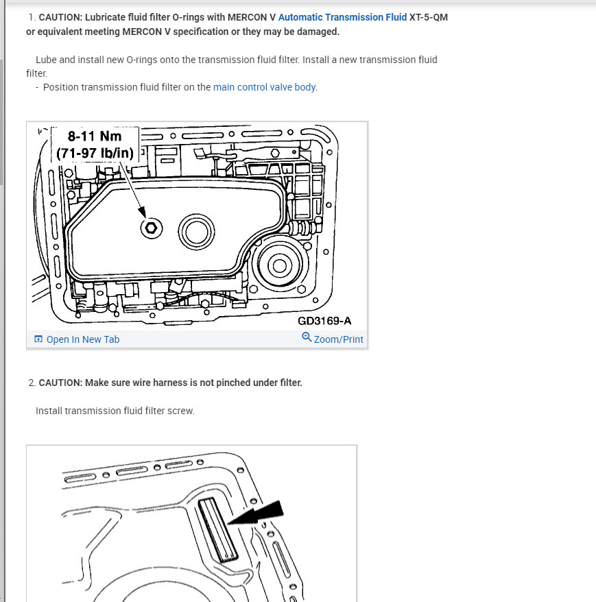

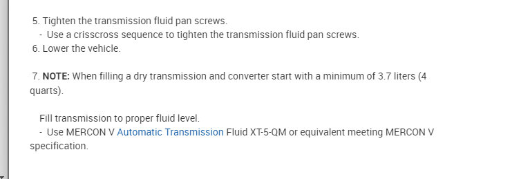

That is correct. There is no separate tank for this fluid. We need to fill the transmission using this process in this guide:
I am attaching the info below from the manual but here is another guide that will help with checking the fluid after you are completed.
https://www.2carpros.com/articles/how-to-check-and-add-transmission-fluid
Please see the info attached on how to service the unit that talks about how to fill the unit as well.
Let me know what questions you have.
Thanks
