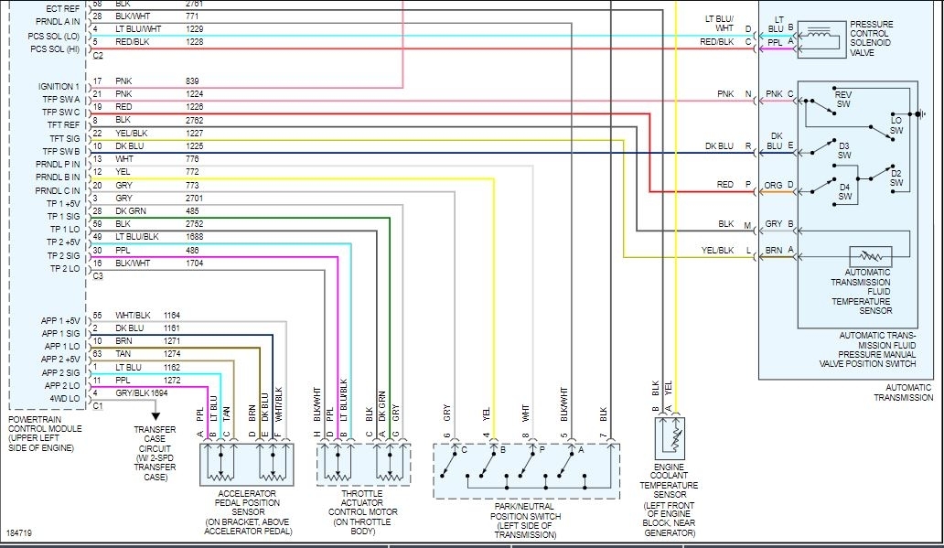

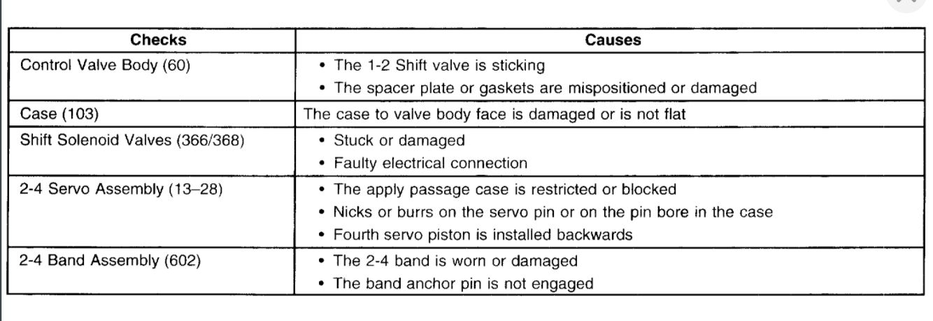

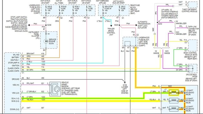

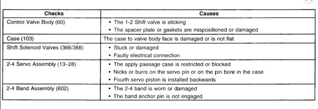

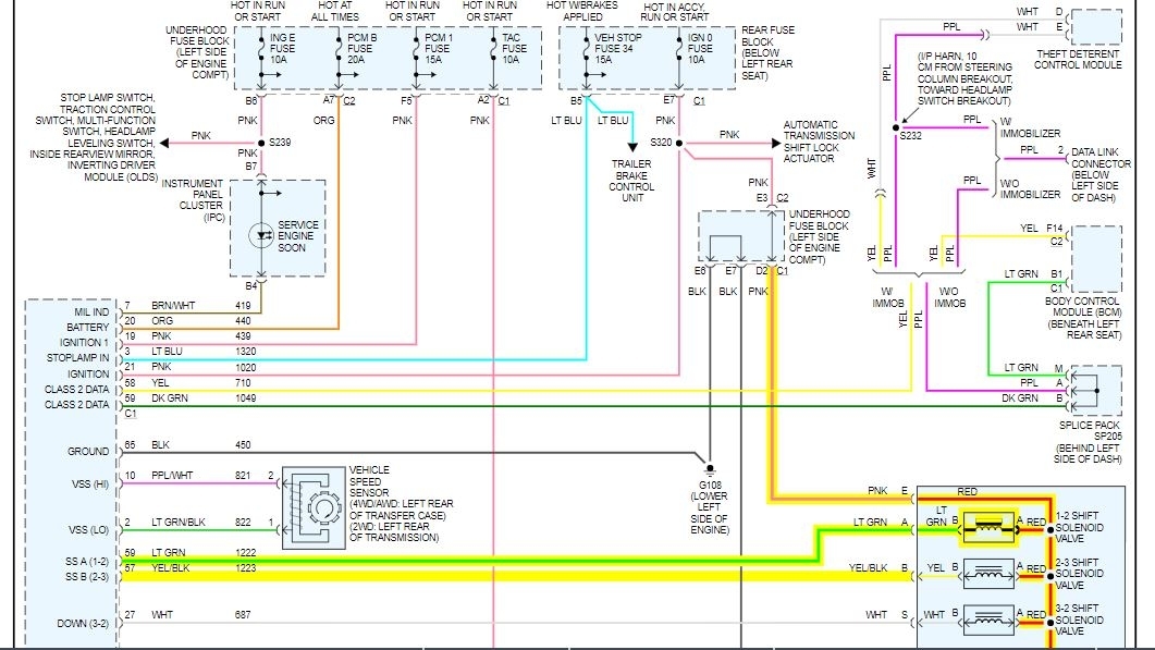

Good morning,
I attached some possible issues for not shifting for you. It could be the valve body.
As far as the solenoids, did you verify power to the solenoids in the truck with the pan down? I attached a wiring diagram of the transmission as well.
