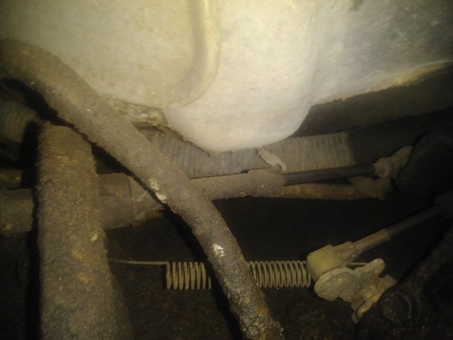

Hey Roy it is David i was speaking with you yesterday. i am at junkyard noticed shift cable on all these do not look like mine. on the other side of the metal bracket by the transmission there bushing or clip with a spring Inside. on mine the spring has popped out. this is a picture of one at junkyard the part right above the long spring. The picture is truck at junkyard. what they all look like mine as the spring popped out. i did not think it looked right.
Feb 1, 2018 at 8:42 AM
it does not look correct at all.
Feb 1, 2018 at 9:00 AM
DAVID DETRANA
  • 9 POSTS
The picture is the one at junkyard on mine the spring has popped out and just hanging there. could this simply be the problem it is a bushing or clip on the transmission side of bracket holding shift cable?
Feb 1, 2018 at 9:04 AM
you can try that. it is a return for throttle cable. try it and see before removing the transmission.
