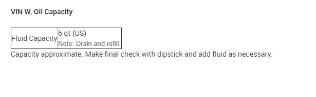

What type of transmission oil does it take and how much quarts do my transmission take? Transmission is THM440-t4.
Mar 18, 2020 at 12:42 PM
Okay, I attached the fluid type and the capacity for you below.
Mar 18, 2020 at 9:50 PM
