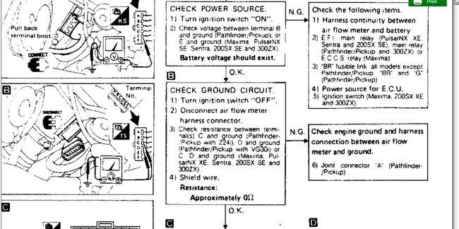

So i started doing routine checks transmission was low topped it off brake fluid a little low topped it off changed cap rotor button, plugs and wires ran like a top. two days later the transmission loses power will not move. i shut of the SUV started perfect it moved then lost power again. i shut it off thinking it may be over heating let it sit started it had power pulled off shifted fine then lost power. i was able to get it home on this fashion. I got up this morning now it wont start, it will turn over but not start. I do not know what to do. can it be related to the transmission problems?

probably not a transmission problem. have battery checked for condition including load test then try resetting security system if that all is okay, then scan for codes and check fuel pressure with a gauge auto parts rent it. also, check fuses under hood. See links.

Well on a sad not must have been a temporary fix ran great for about a week then no start but i so i checked battery 13. 4 volts got spark fom coil with pulse but still no spark was checking for codes and pulled codes for injector leak but what gets me is as i pump gas and and turn over engine i smell no fuel what so ever and i also see no spray in carb but got fuel at rail really scratching my head on this one

what was the code? it may be a fuel pressure problem or injector may be staying open to long...
Jan 2, 2017 at 5:44 AM
JOSEPH TREADAWAY
  • 8 POSTS

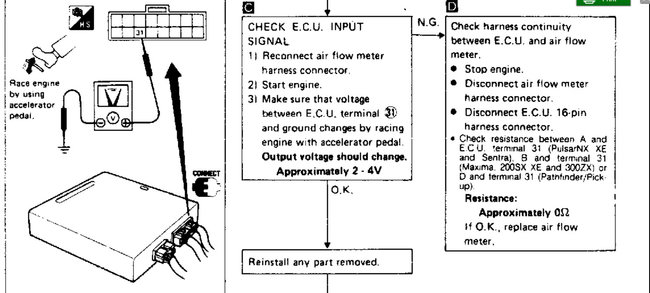

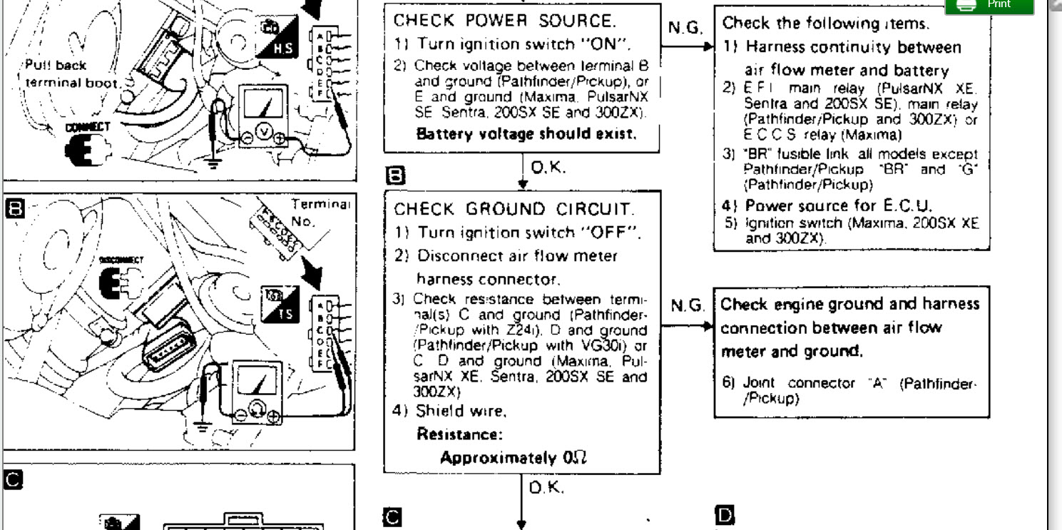

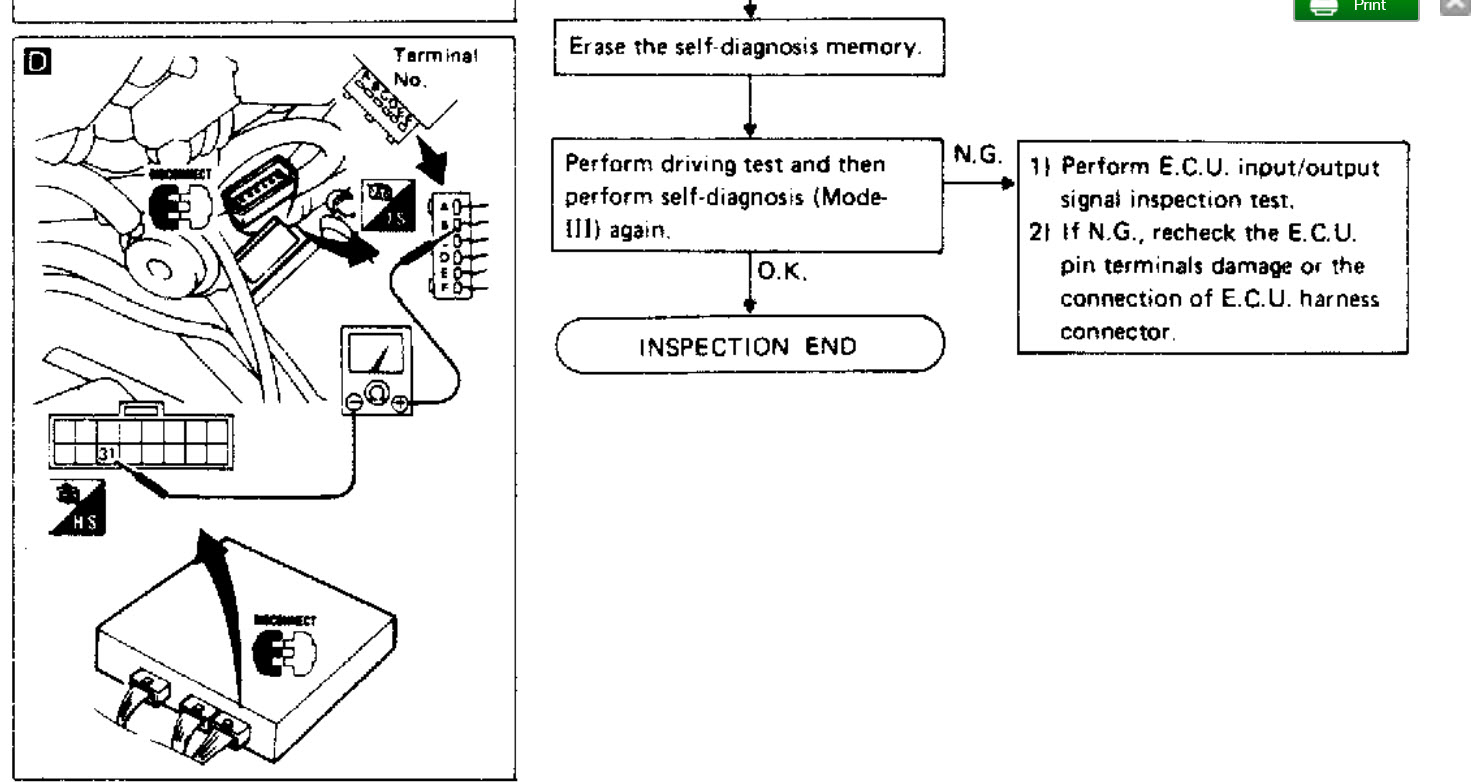

It was a code 12
Jan 3, 2017 at 1:26 AM
HMAC300
  • 48,601 POSTS
see pics for testing maf circuit
