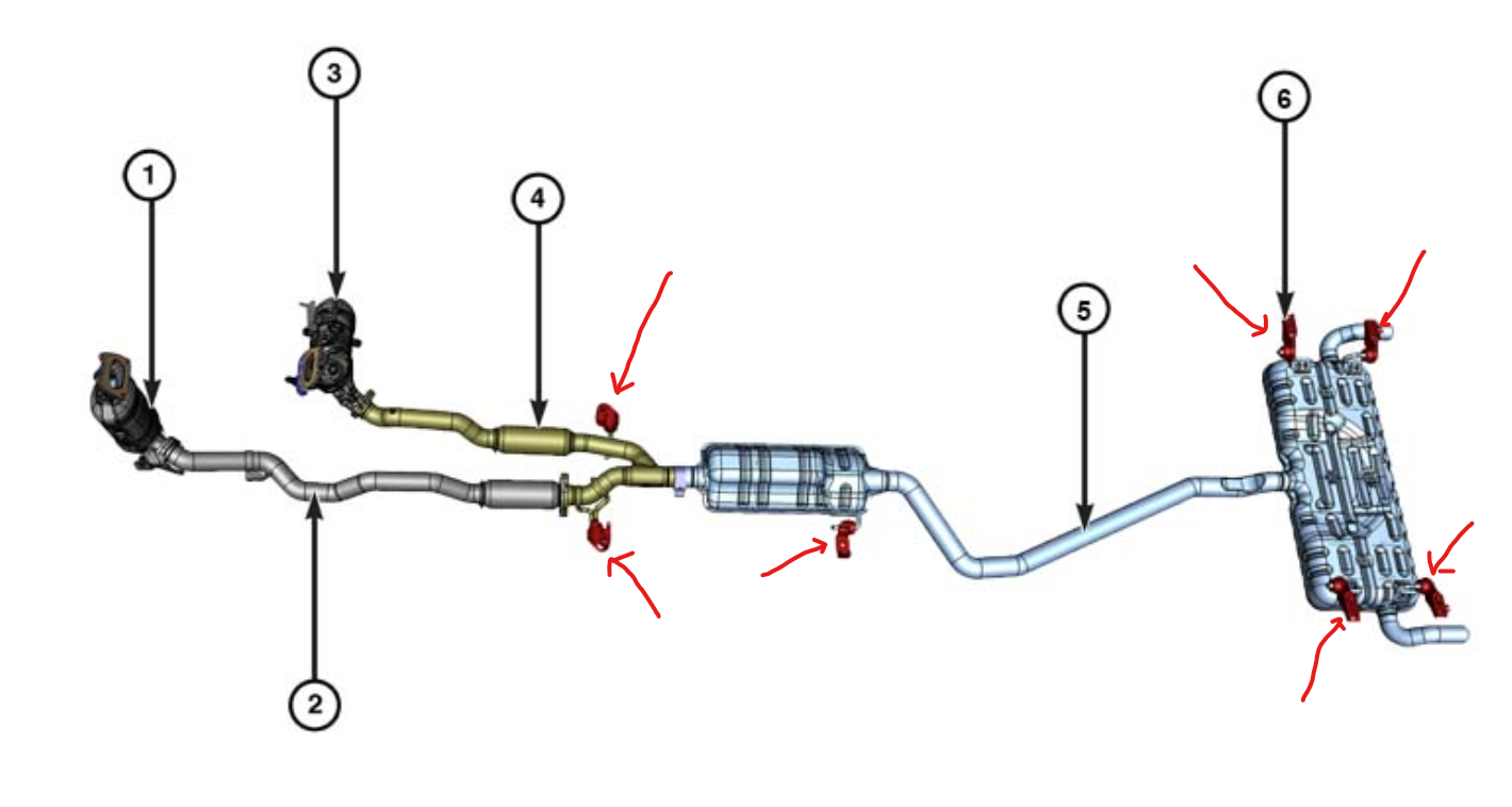

Can I ask where the rattle is coming from, front, center or rear? Please upload a video in your response of any problems so we can see what to help you with. It could be a loose heat shield or broken hanger for the exhaust system. Please check the image below to see what I am talking about and get back to me.

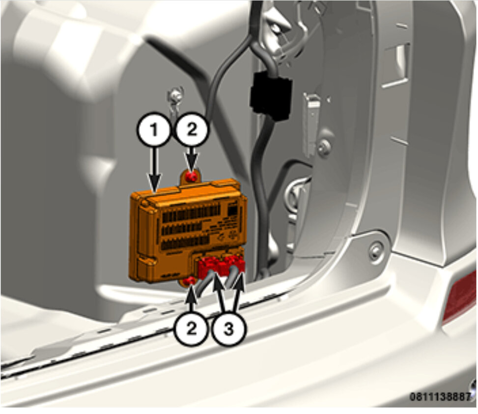

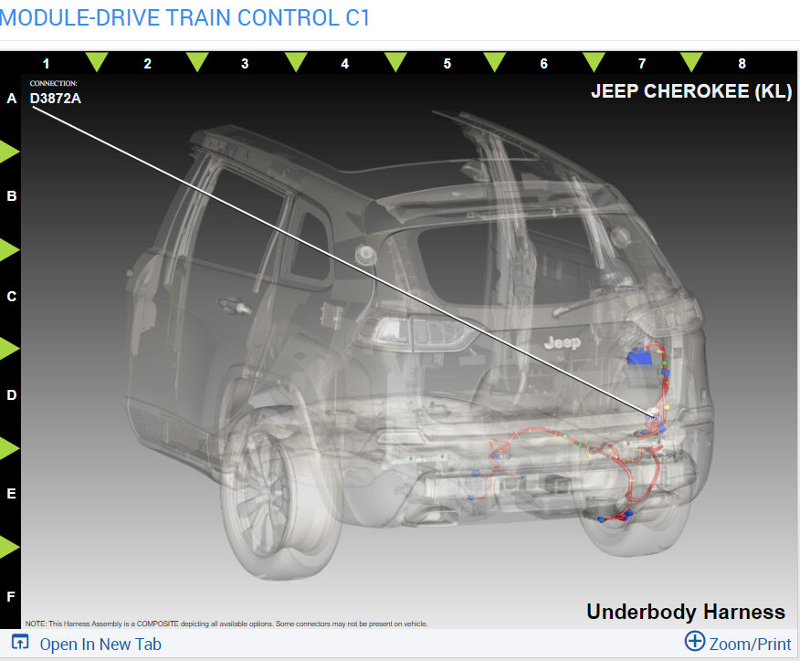

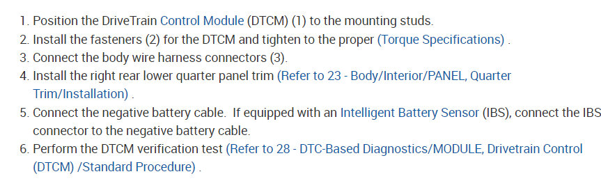

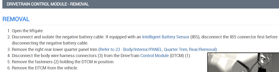

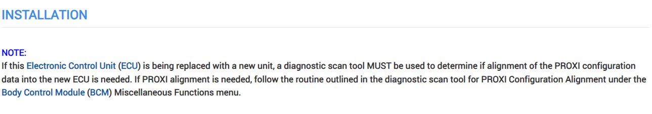

Thanks for the videos, they help. I have seen this problem before, this is the drivetrain control module has gone out, but to be sure let's run a CAN scan to see if there are any codes stored. You can get a CAN scanner (Controller Area Network) which will work on most cars from Amazon.
https://youtu.be/u-4syLc-ifQ

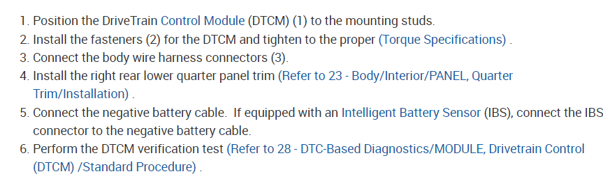

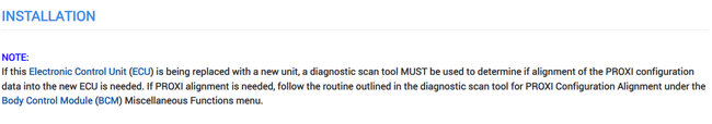

Here is the location and how to replace the drivetrain control module in case a code comes up for it. Check out the images (below). Please let us know what happens.
