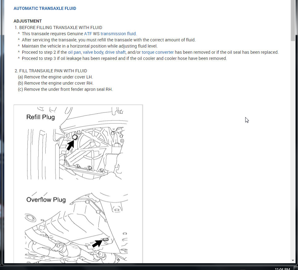

There is no dipstick to check transmission fluid.
When i put my car in reverse i had to give it a lot of gas before it would move.put it in drive and it was the same way. after it got going it was fine all other gears shift like normal.a couple of days prior to this i started hearing a whining sound they got louder as accelerated but then stopped after it shifted out the first time. any thoughts and what this could be please? thank you
May 30, 2021 at 11:08 AM

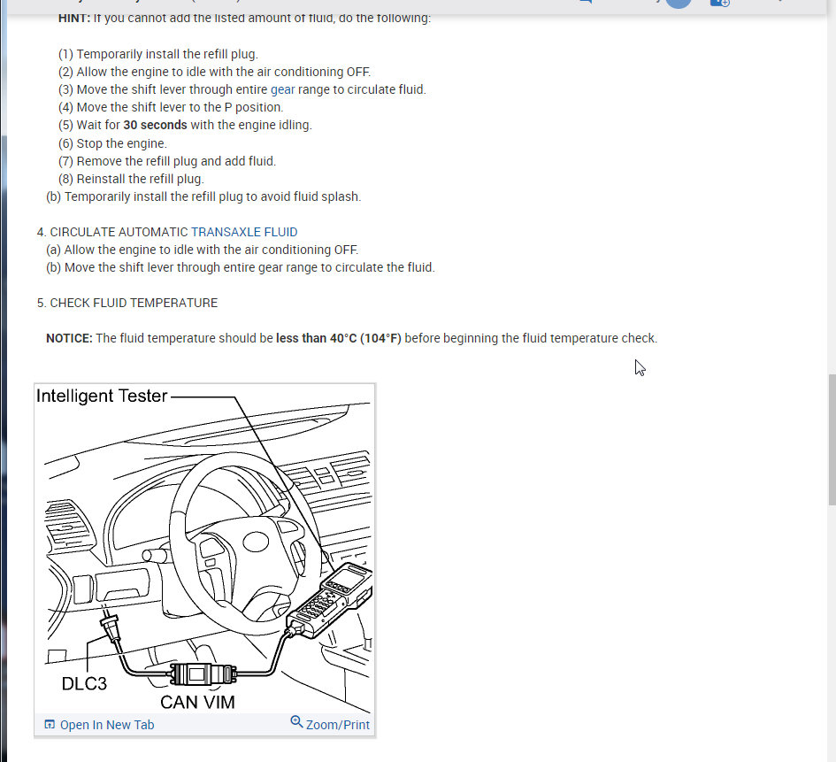

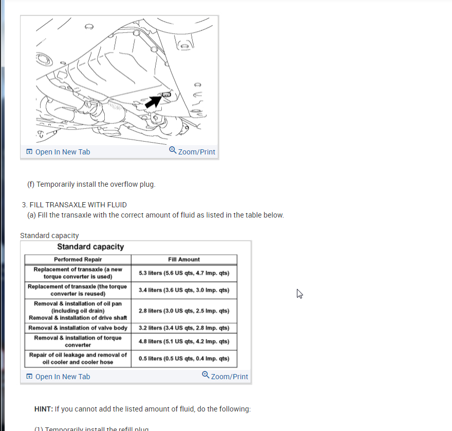

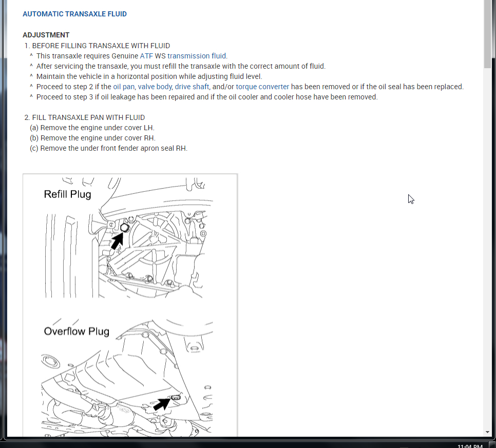

This could be a fluid issue so even though you don't have a dipstick we will need to check the fluid.
I would suggest servicing the unit. Here is a guide that will help with this:
Below is the process from the manual that will show how to properly fill the unit so that we know it is at the right level. However, we need to know the condition of the fluid currently as if it is burned then that will be good info.
Thanks
May 30, 2021 at 1:09 PM
