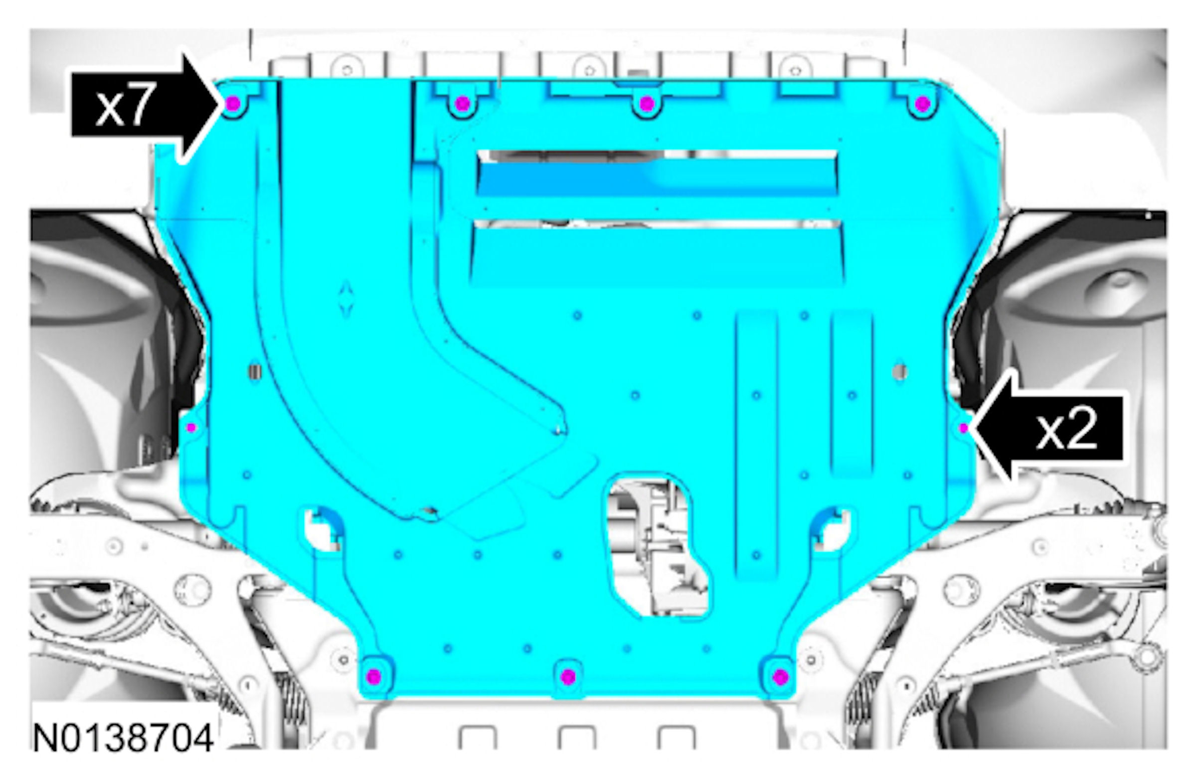

Engine Front Undershield

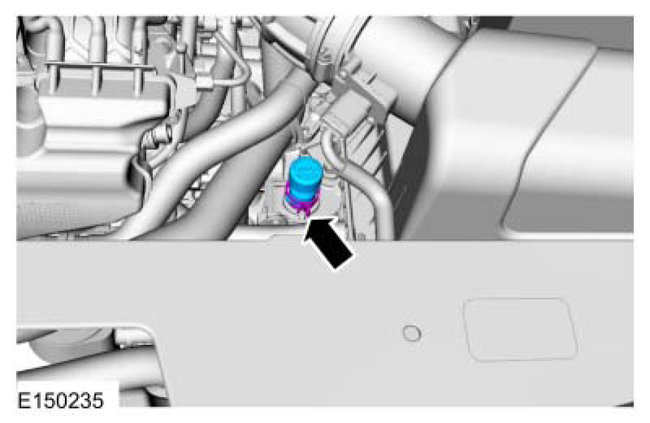

pic 1

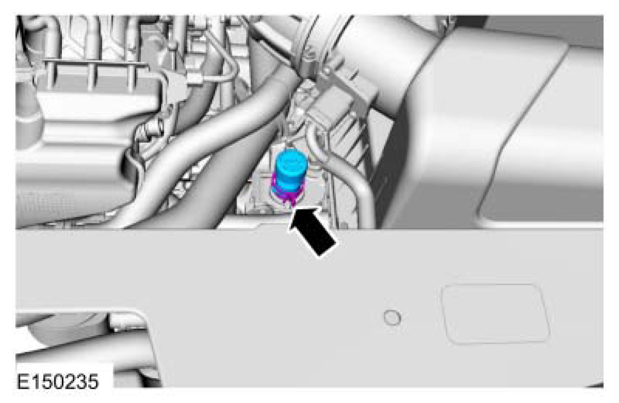

2. Start the engine and slowly select each gear position, stopping in each position and allowing the transmission to engage.
pic 2

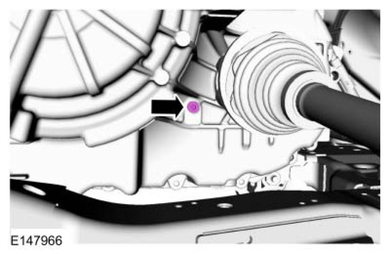

3. With the engine running in PARK on a level hoist make sure the transmission is at normal operating temperature 85-93 C (185-200 F). Check if the transmission fluid is even with the oil leveling plug hole.
pic 3
4. If the transmission fluid is not even with the oil leveling plug hole, add clean transmission fluid in increments of 0.25L (0.5 pt) until the transmission fluid is even with the oil leveling plug hole.

Refer to: Engine Front Undershield (above).
