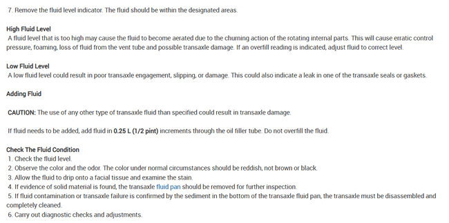

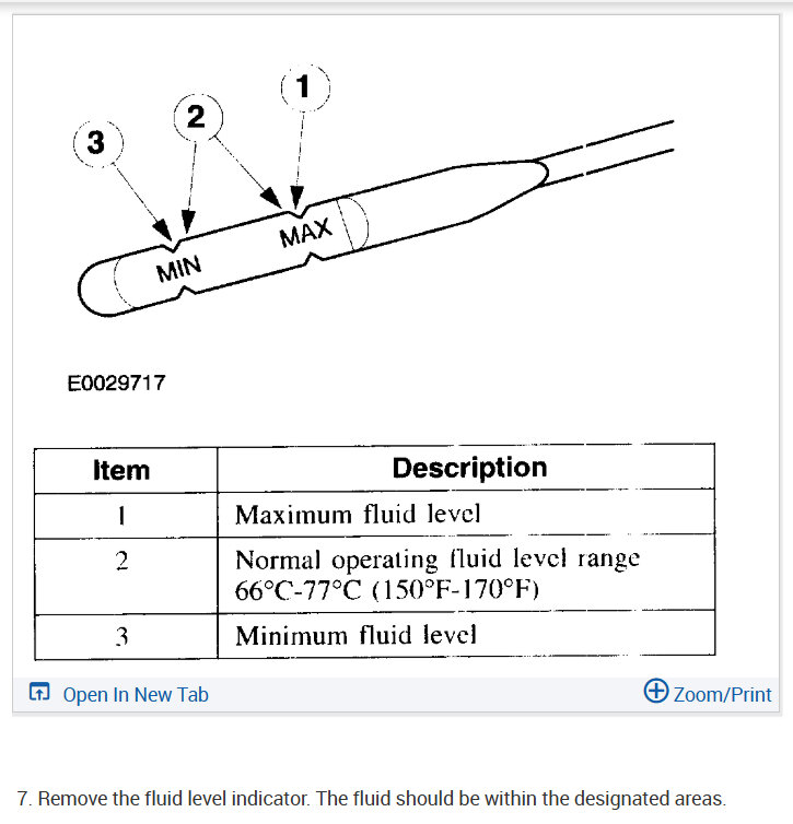

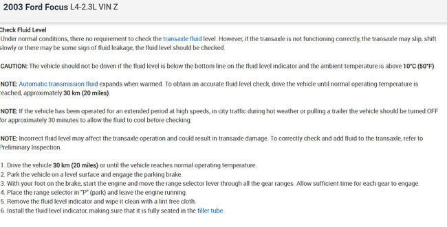

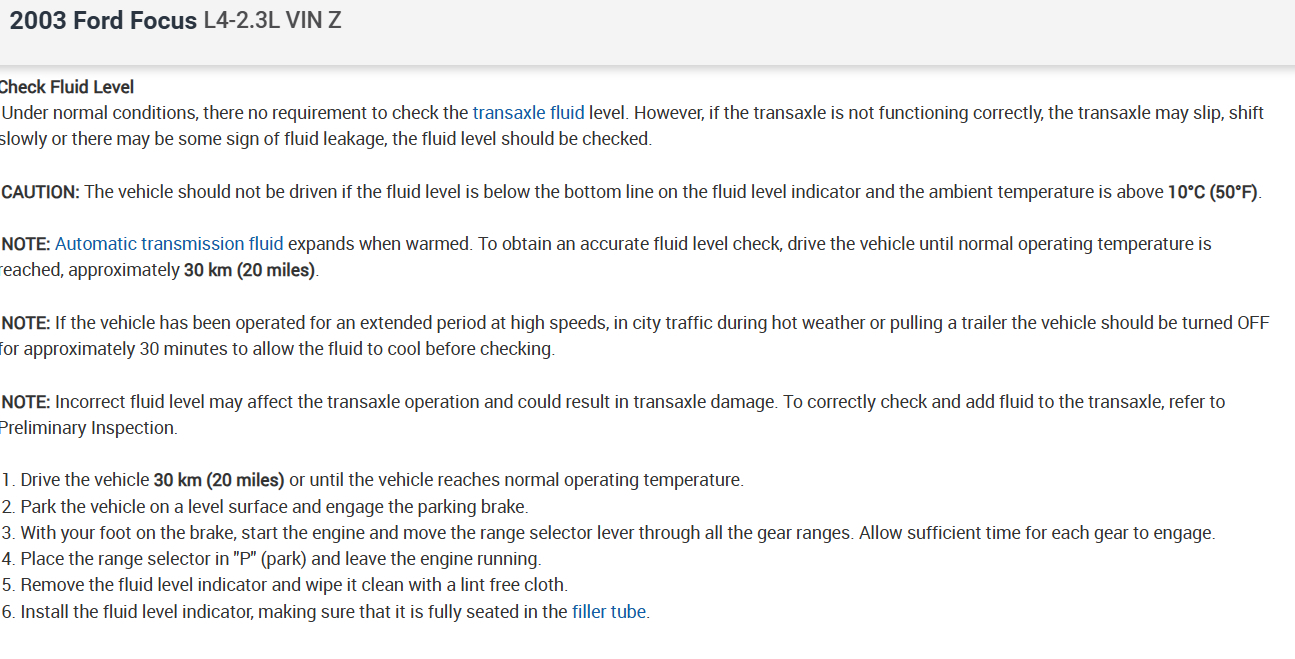

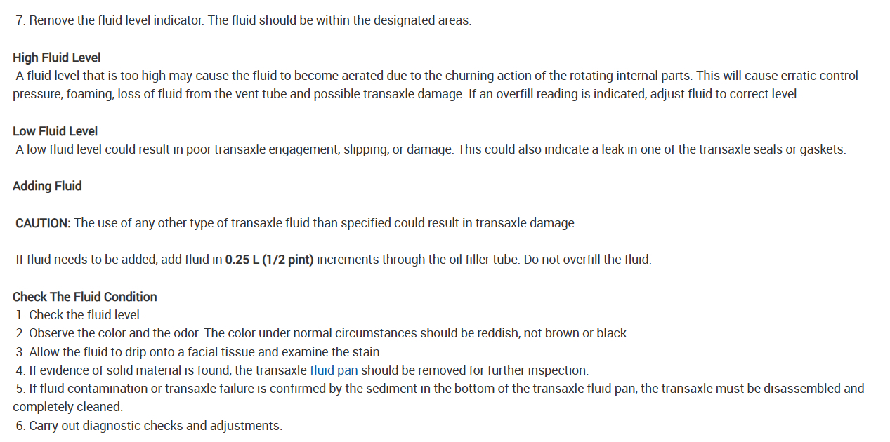

To me it sounds like the transmission needs to be rebuilt. I would check the fluid level and condition; this guide can help:
https://www.2carpros.com/articles/how-to-check-and-add-transmission-fluid
Here is how the job is done on your car. Also, you must use the correct transmission fluid.
Type .................... MERCON V XT-5-QM or equivalent
Check out the images (below). Please upload pictures or videos in your response of any problems so we can see what to help you with.

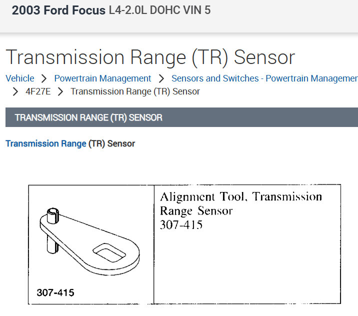

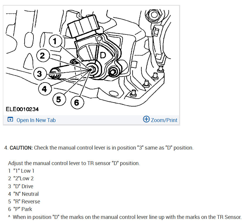

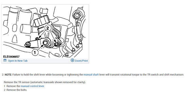

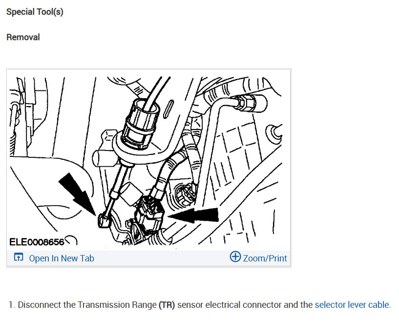

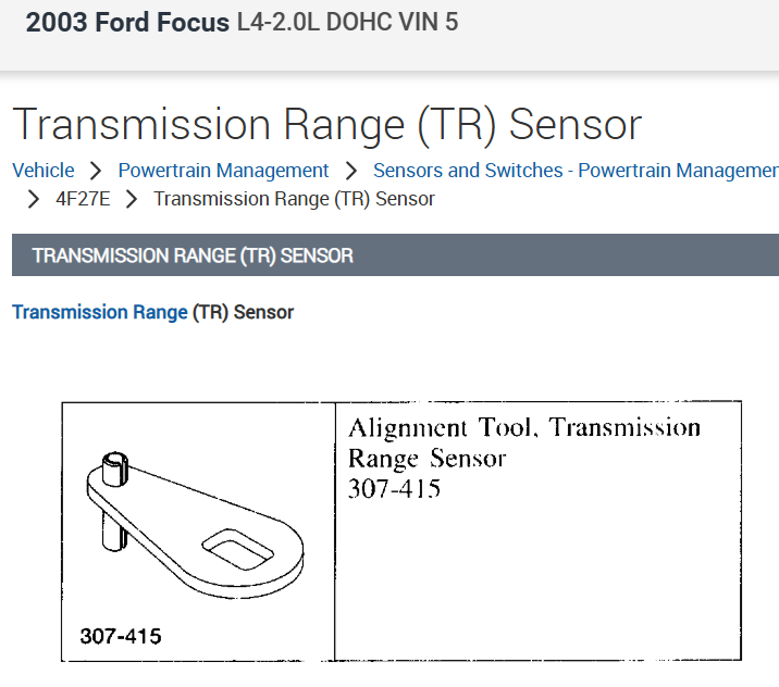

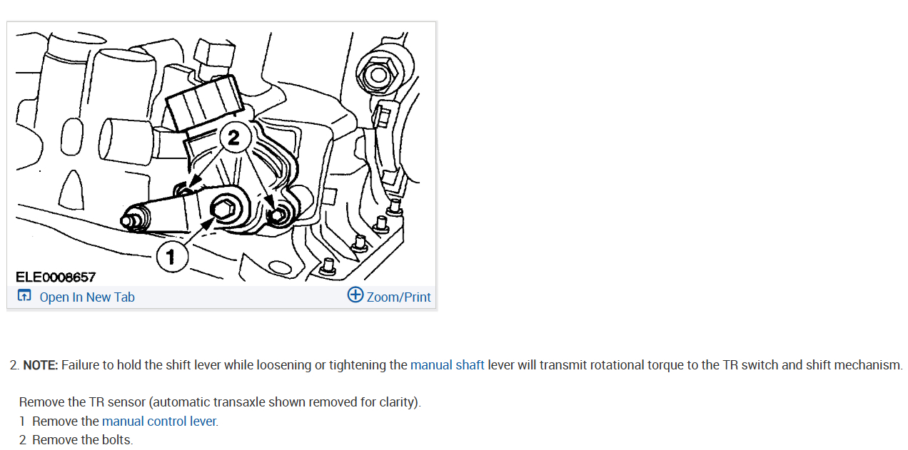

also, when it still was engaged in drive for a few minutes i gave it a little gas to move forward and it like stalled out. and i went to restart in neutral and it wouldn't so i had my hand on shifter and slightly moved it while in neutral with key to start then it started. seemed like the switch was a tiny bit off alignment like just a little bit.. could it be the neutral safety/range sensor just off alignment ? i know how to align it.. shift it to drive and the lever has a notch line up to the spot on the sensor itself ?
Dec 8, 2024 at 12:05 AM
  • 55,433 POSTS
Yes, this can cause the transmission to have issues if the gear range sensor is not aligned correctly or if it is going out. Here is how, so we are on the same page. Check out the images (below). Please let us know what happens.
