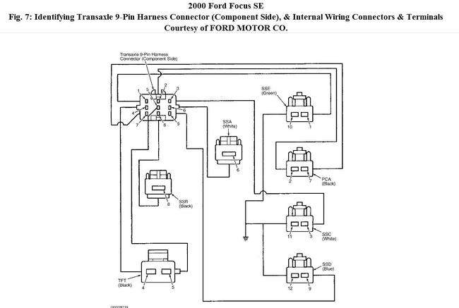

While driving goes into 3rd gear but then when my to.s go up or I go over idk 30mph it disengaged then when let off gas or let rev down it engages again. Sounds like a solenoid but no codes? I need help nobody knows what it is here sounds like solenoid to me but why no codes any help would be very helpful.

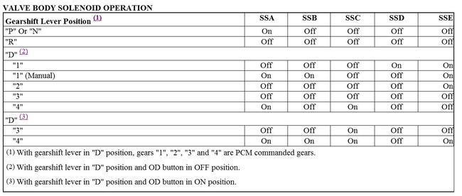

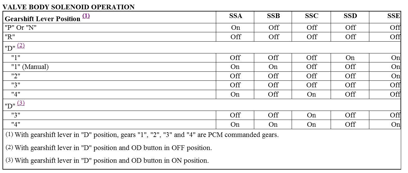

Chart shows the solenoid operations in the various modes. Did you test if there is any difference when OD button is turned on or off?
For testings of solenoid operations, a scan tool would be the easiest way to go about. It can read the various circuits and allows you to test the solenoids.

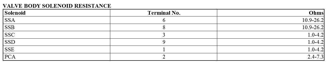

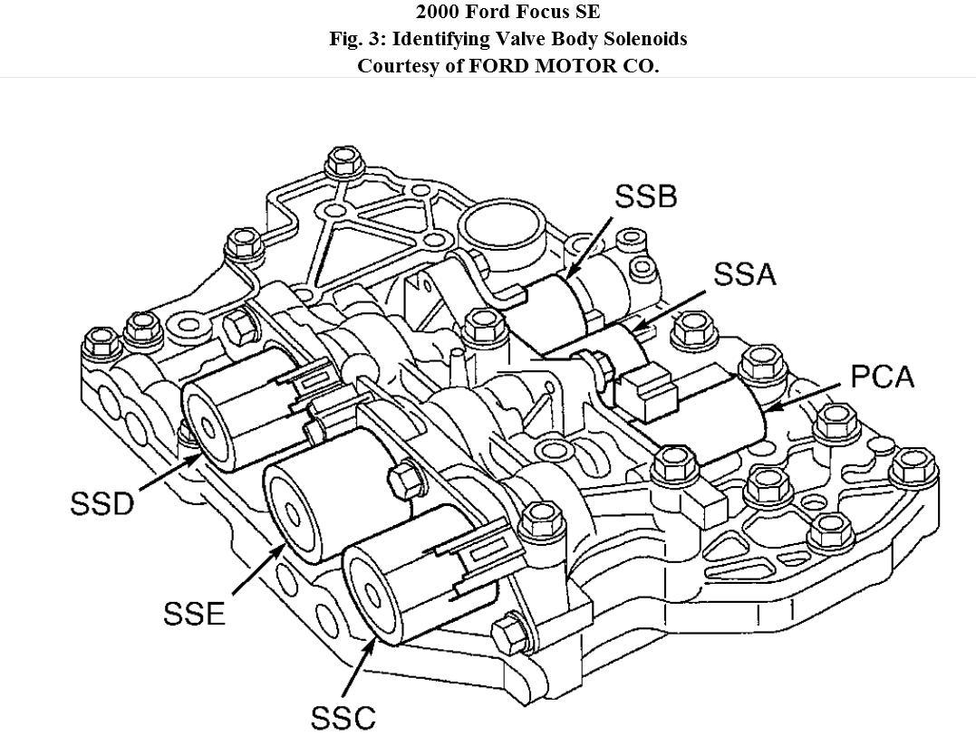

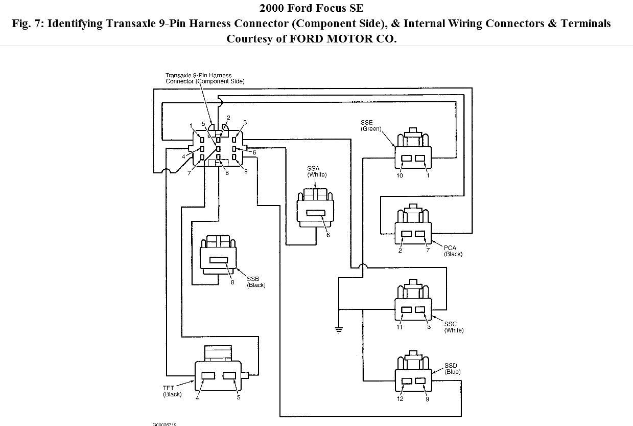

Oh ok well I live on st thoms in the virigin islands I don't think they have the scan tool anywhere here. How do I test the solenoids manually to make sure they are moving an working
Aug 9, 2013 at 12:09 PM
KHLOW2008
  • 41,814 POSTS
VALVE BODY SOLENOIDS
Raise and support vehicle. Remove transaxle oil pan to access valve body solenoid assembly. Disconnect solenoid wire connector(s). See Fig. 3 . Using an ohmmeter, measure resistance between specified terminal(s) and solenoid body. See VALVE BODY SOLENOID RESISTANCE table. See Fig. 7 . If resistance(s) is within specification, solenoid is okay at this time. If resistance(s) is not within specification, replace faulty solenoid(s) and retest system operation.
