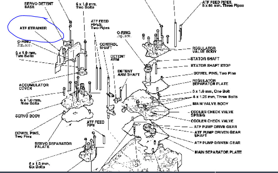

The car engine works fine. I was able to drive the car at low speed around 20 mph for 15-20 minutes, and then the I stopped at a red light and then it didn't move.
I restart the car, and it' running again for 10 minutes and the same thing happen. It works on the reverse. I was able to change the gears but it's difficult..
Aug 16, 2019 at 9:21 AM
Good morning,
When you go forward, does it shift through the gears?
Did you change the fluid? The filter is internal and cannot be changed without disassembling the transmission.
Are there any codes stored?
