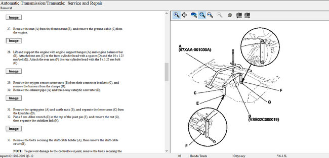

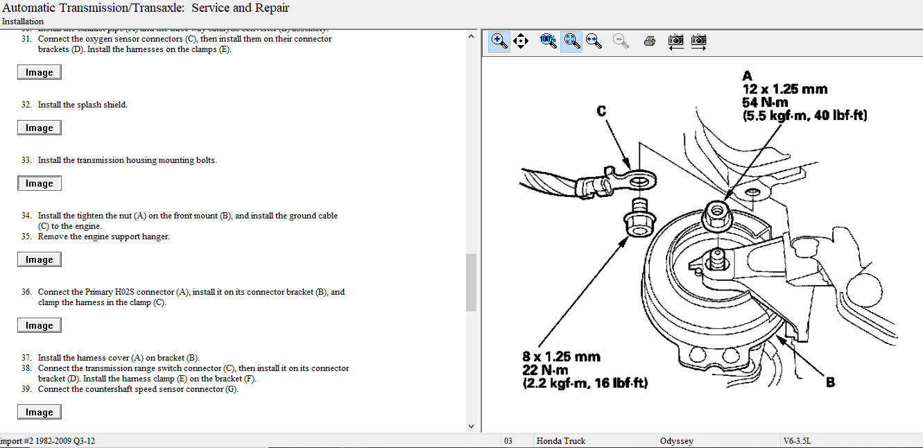

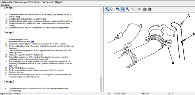

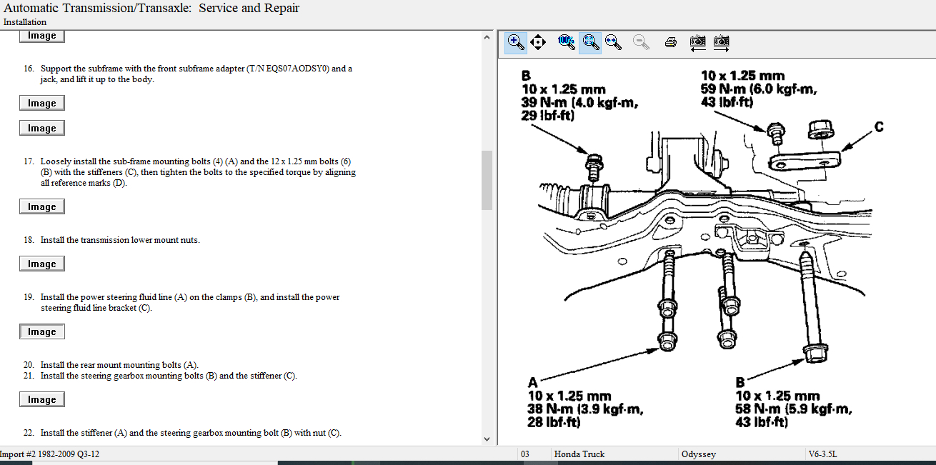

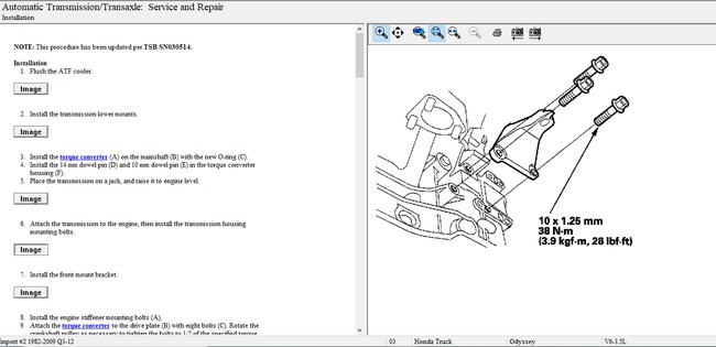

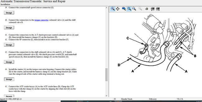

Is a odyssey trans hard to take out I need to replace it can you help me please?

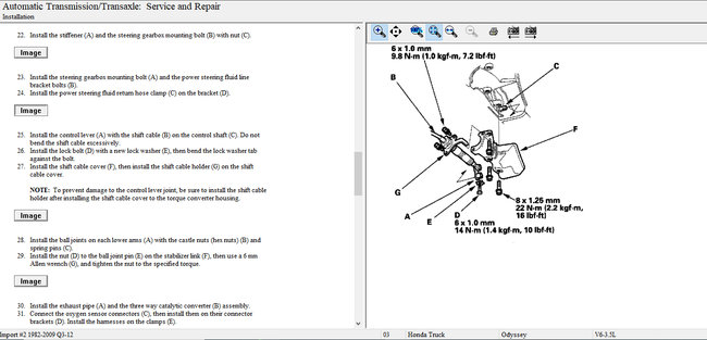

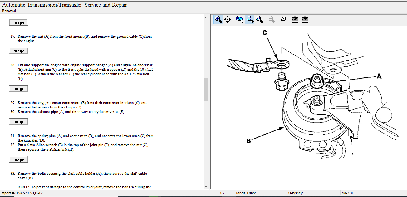

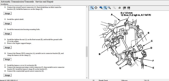

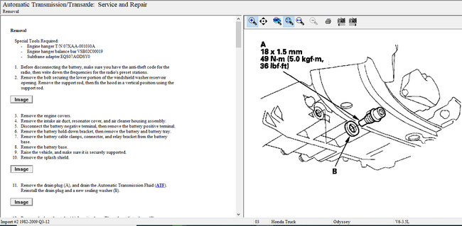

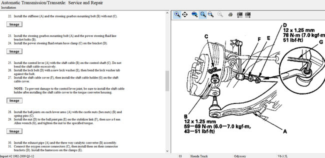

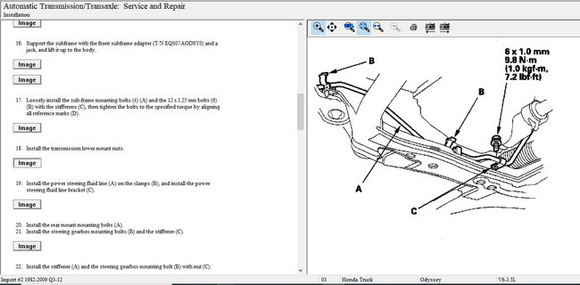

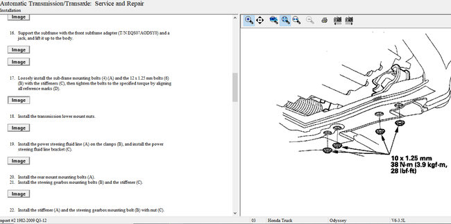

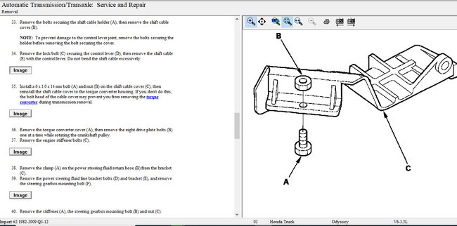

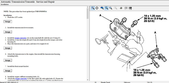

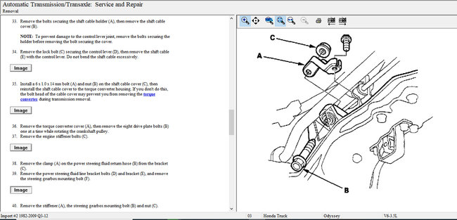

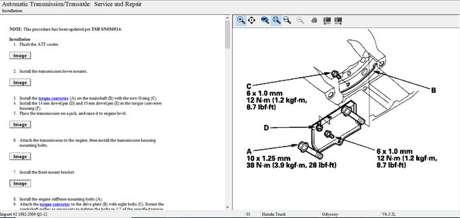

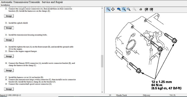

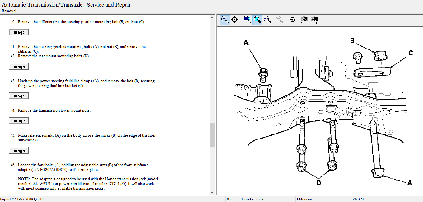

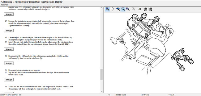

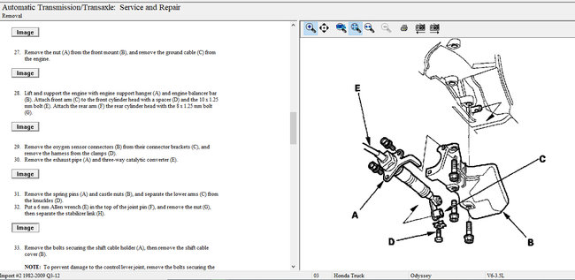

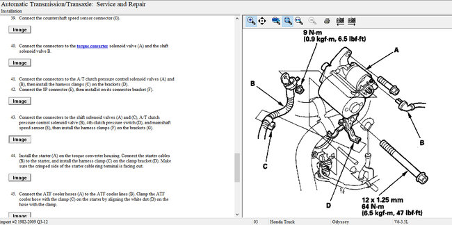

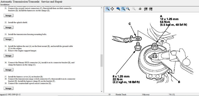

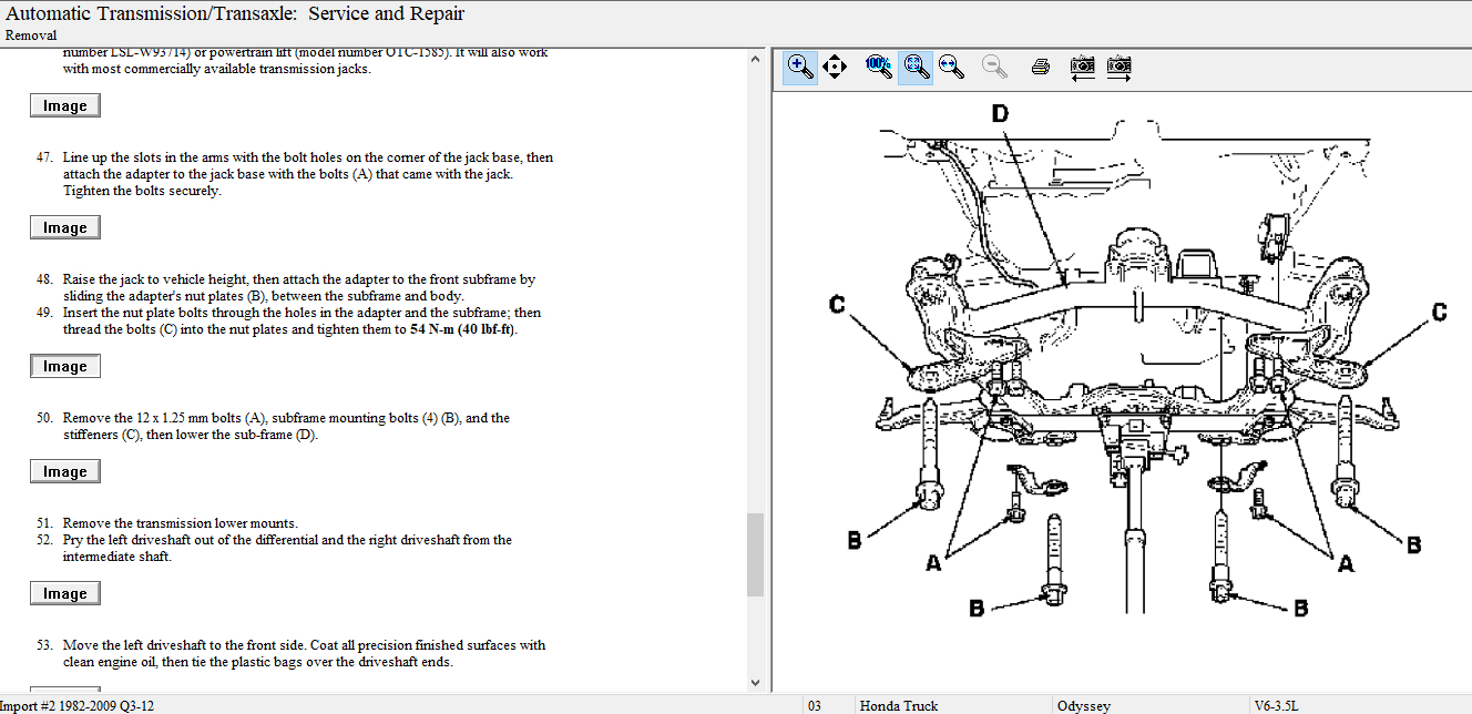

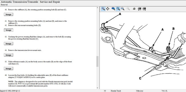

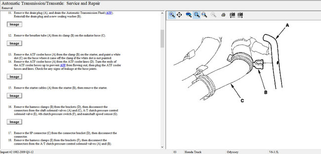

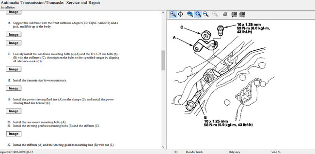

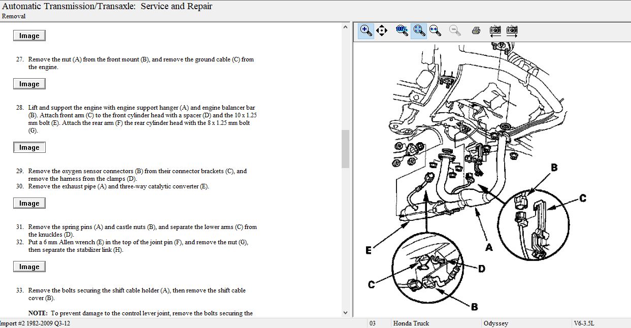

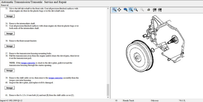

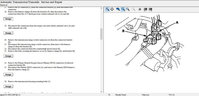

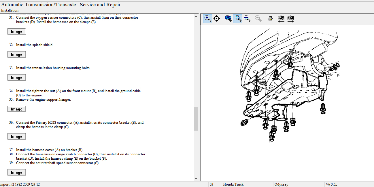

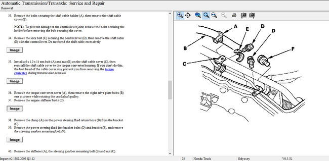

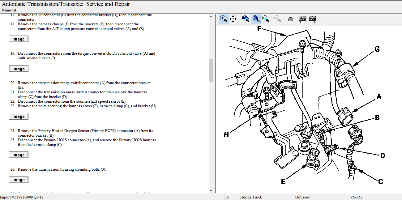

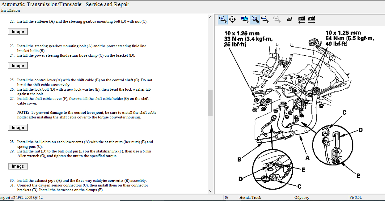

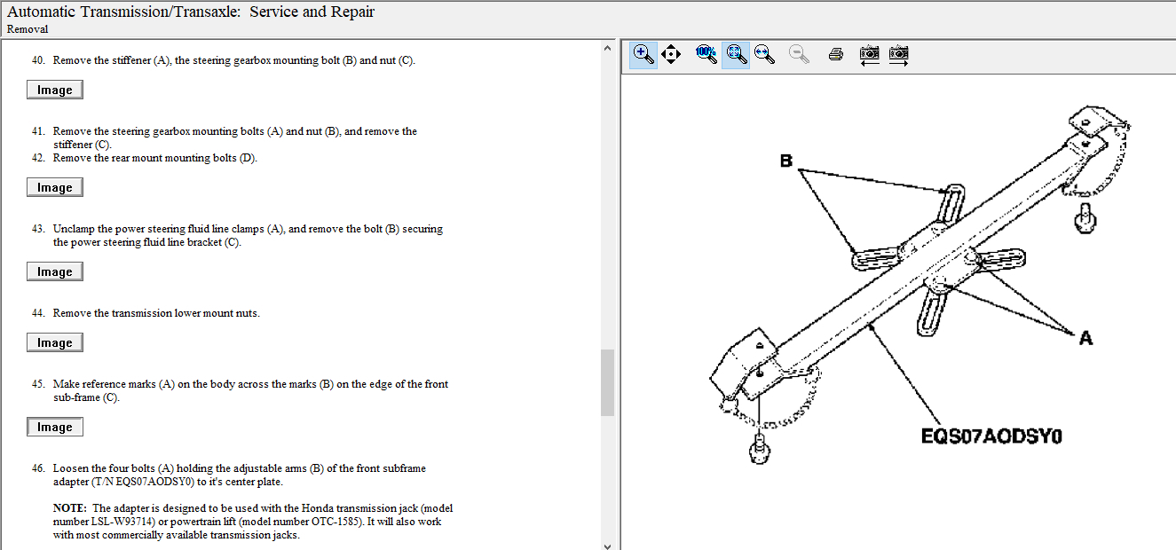

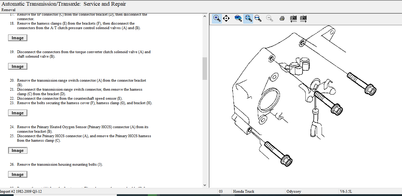

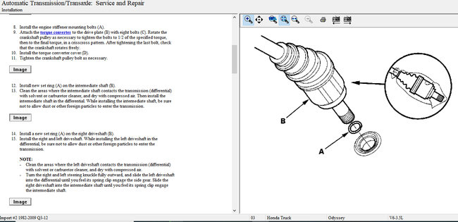

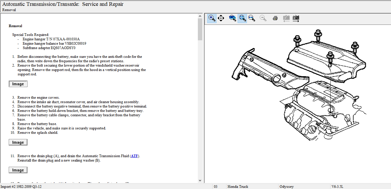

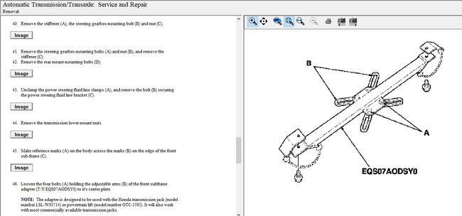

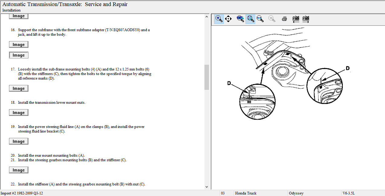

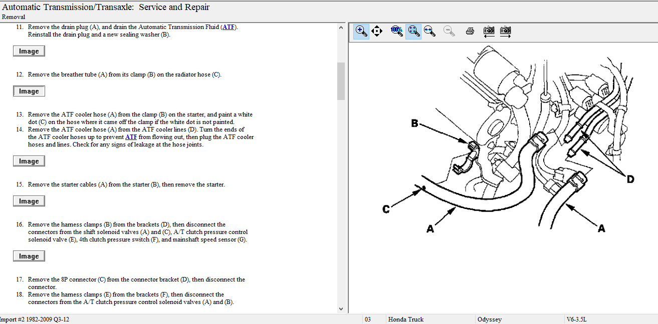

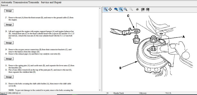

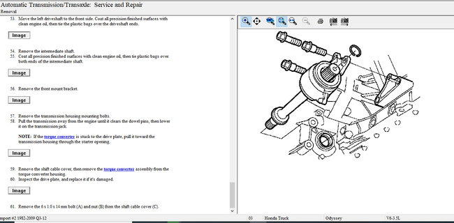

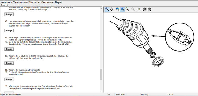

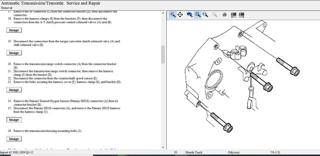

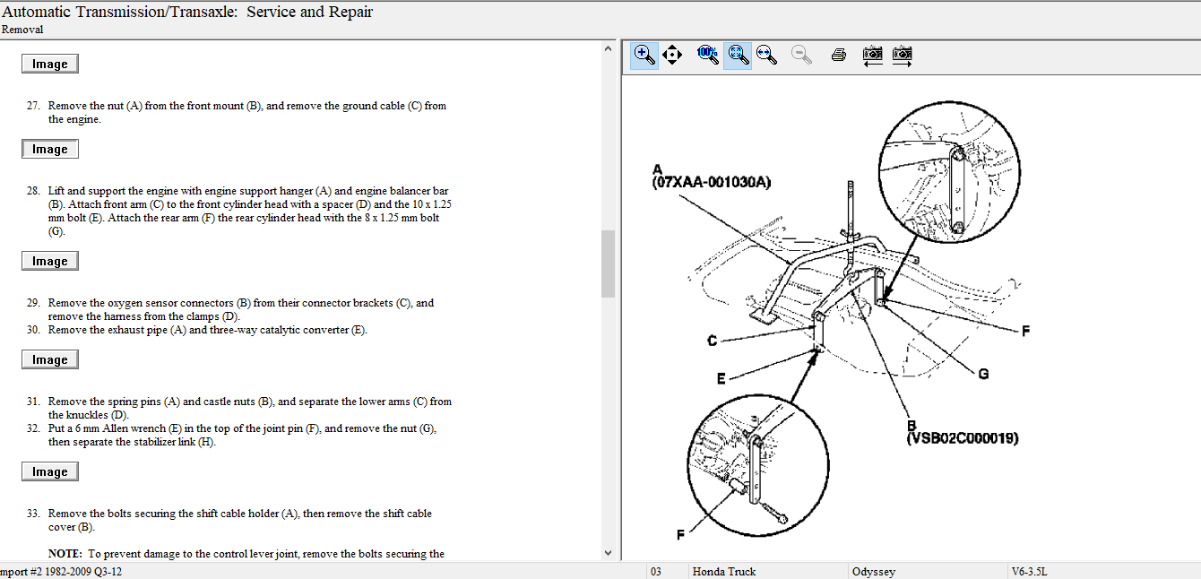

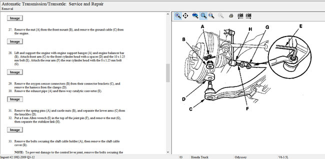

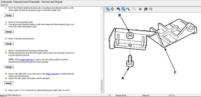

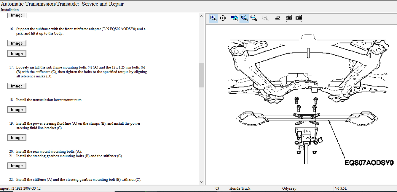

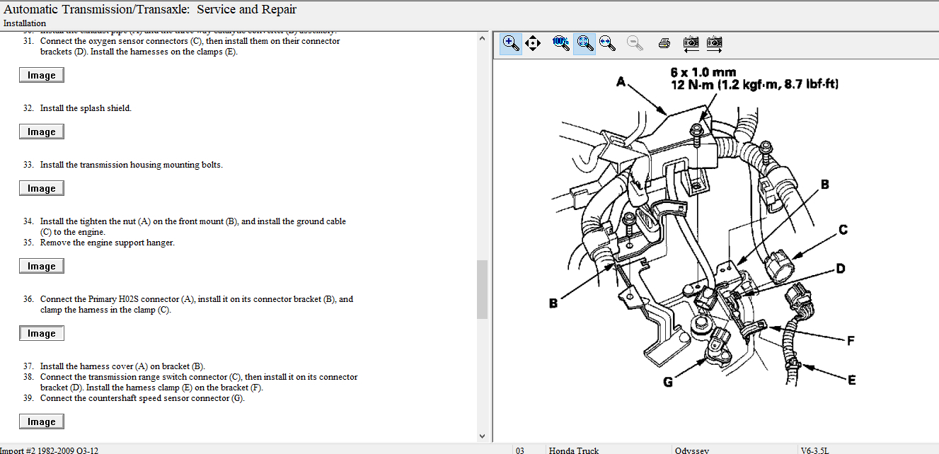

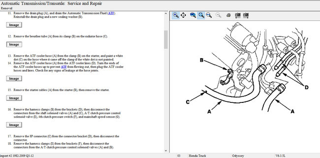

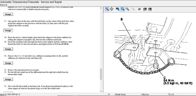

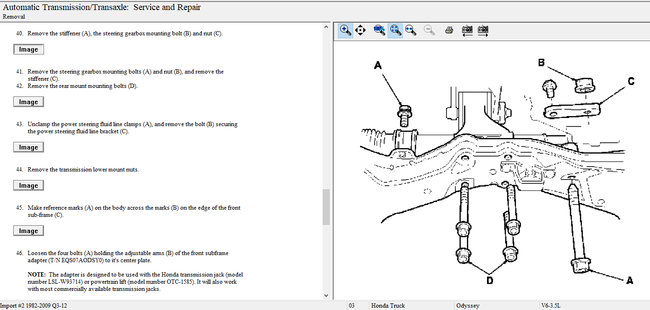

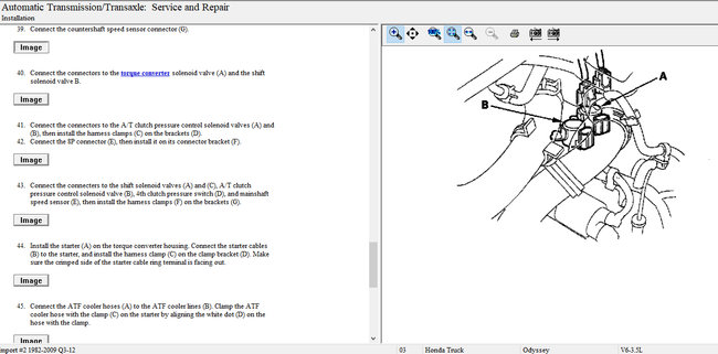

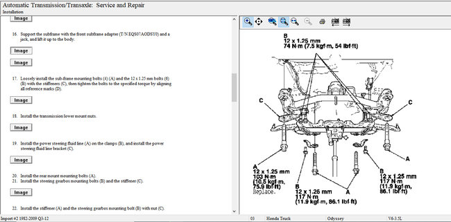

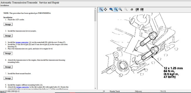

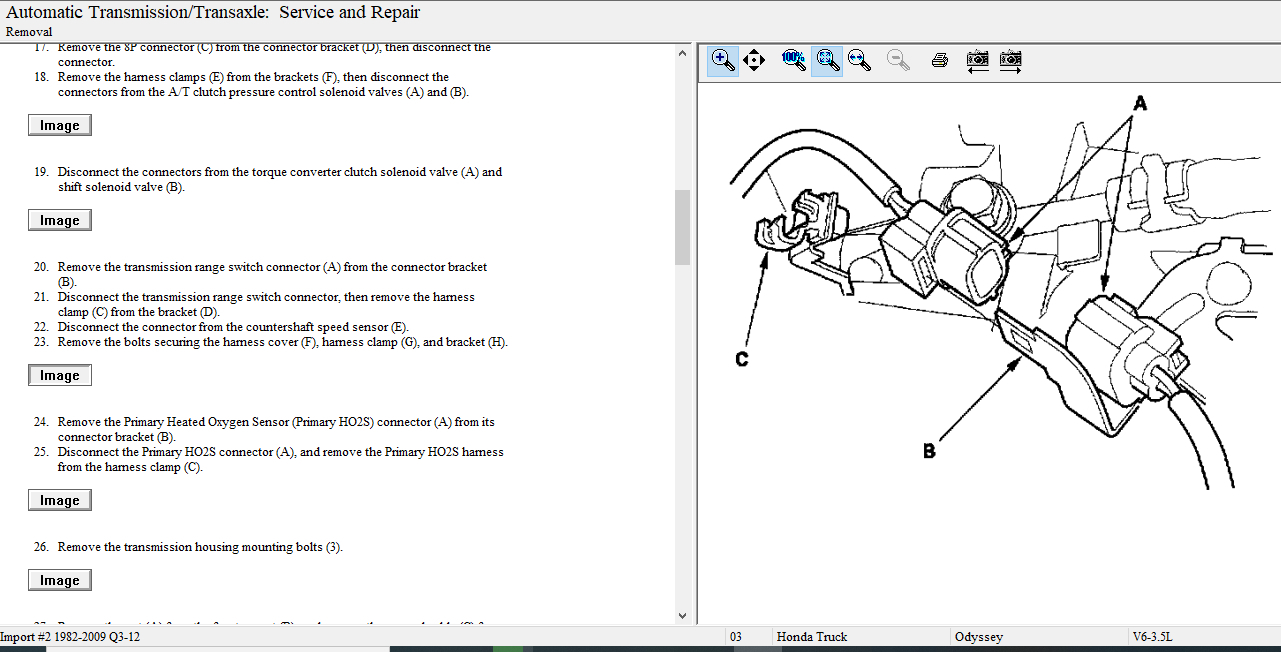

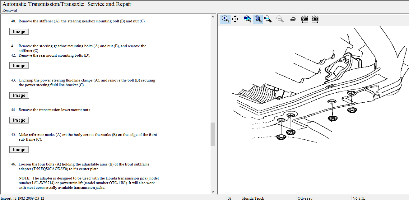

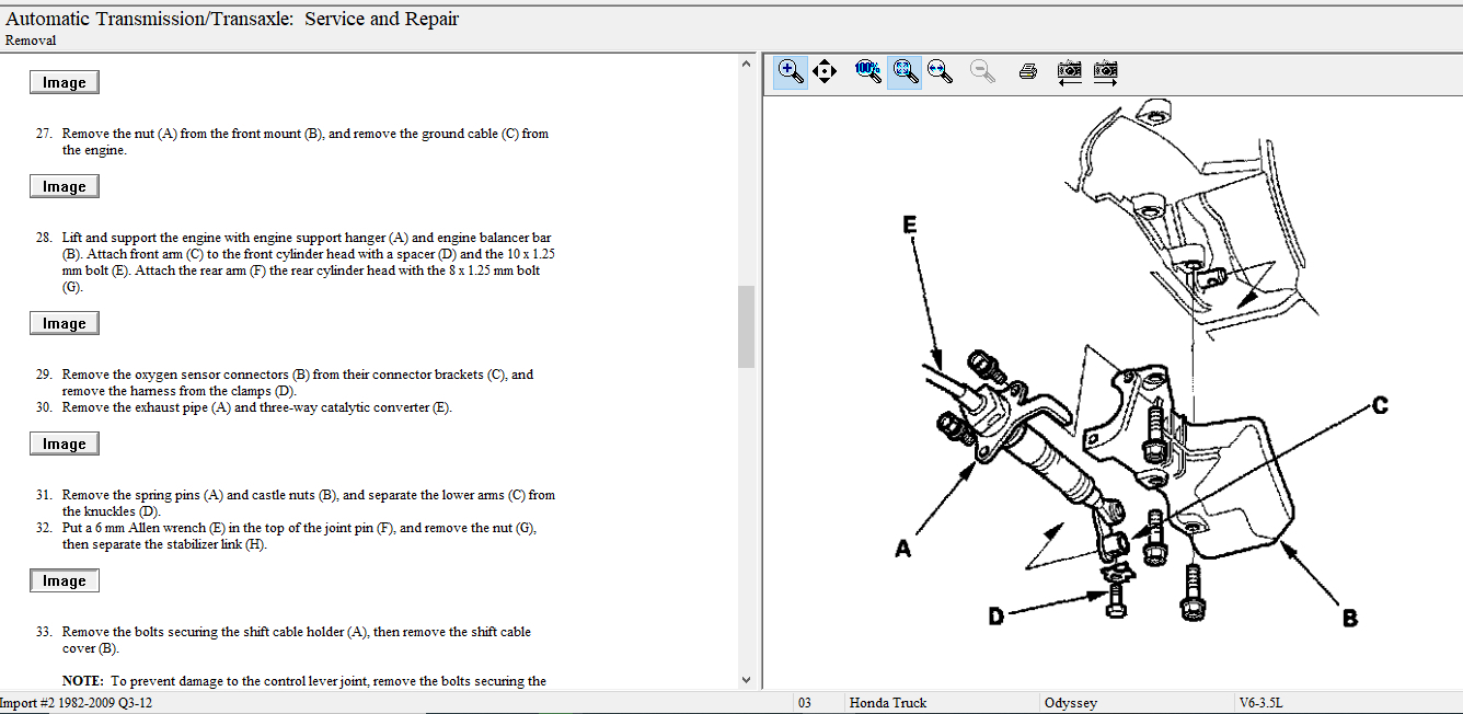

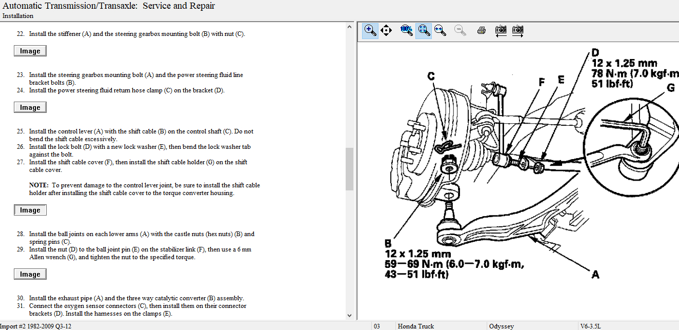

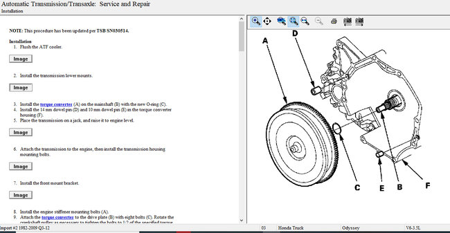

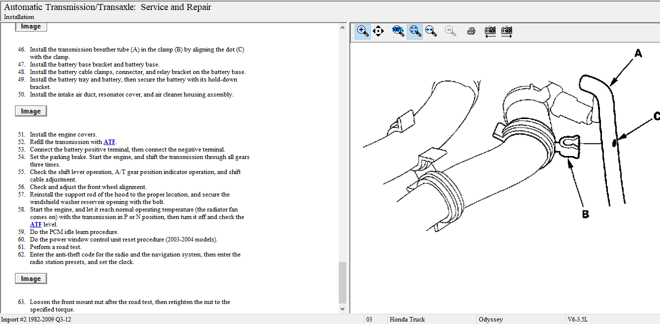

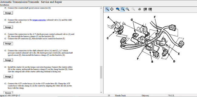

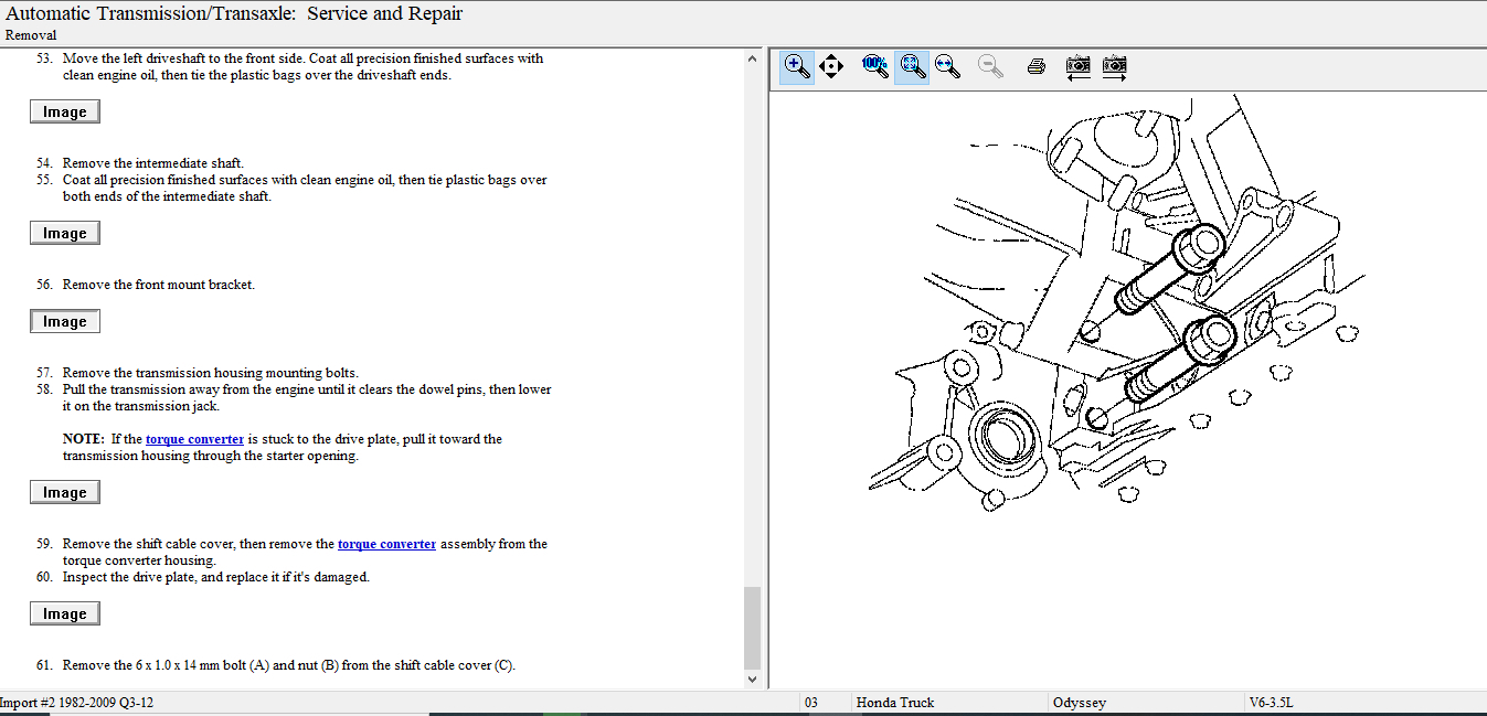

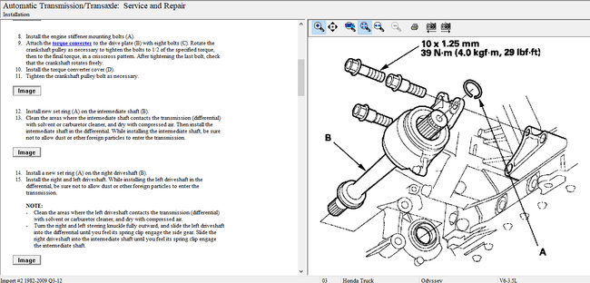

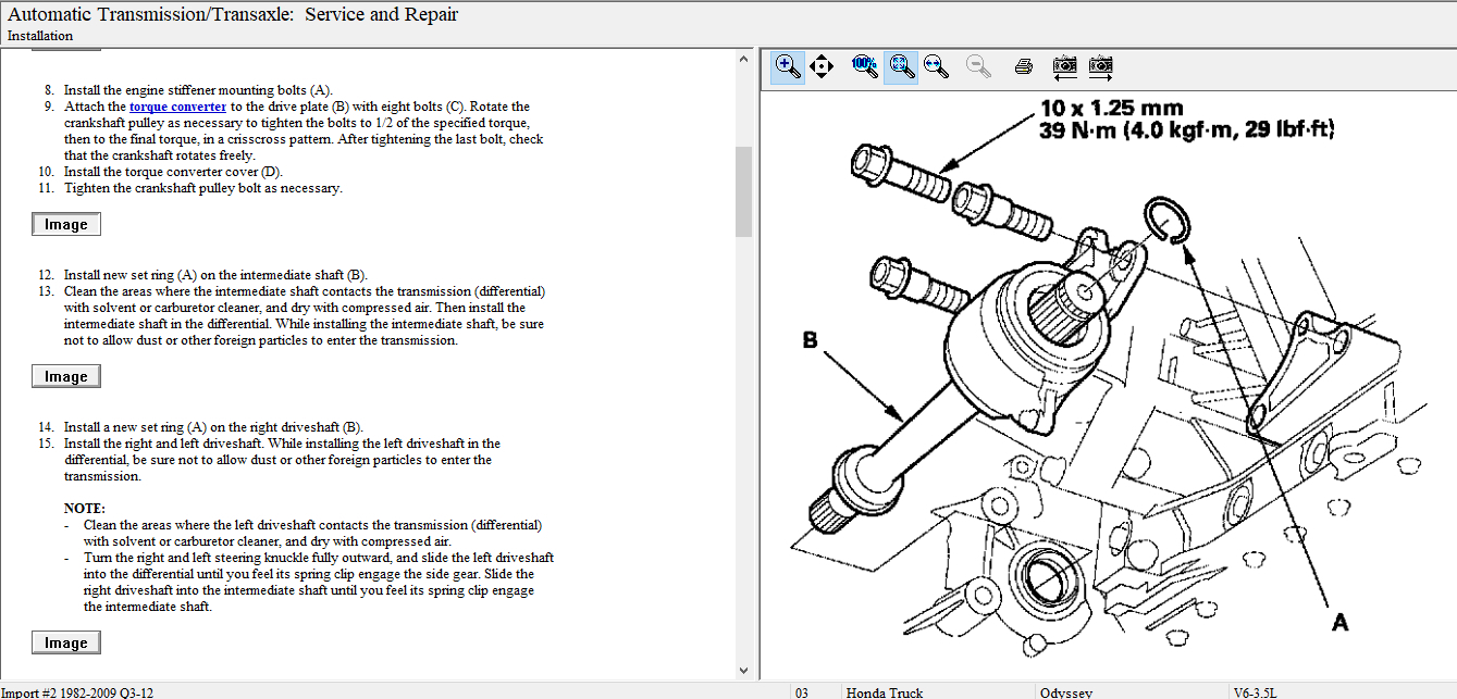

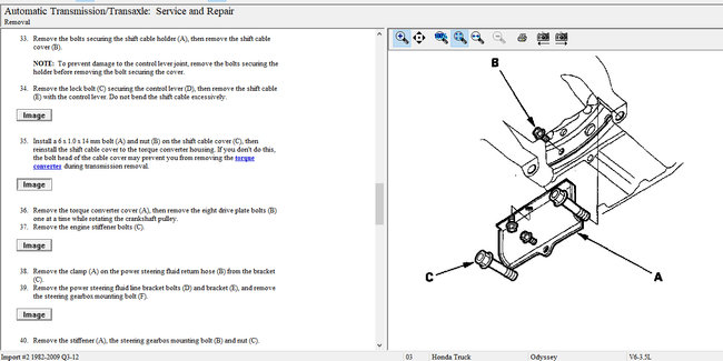

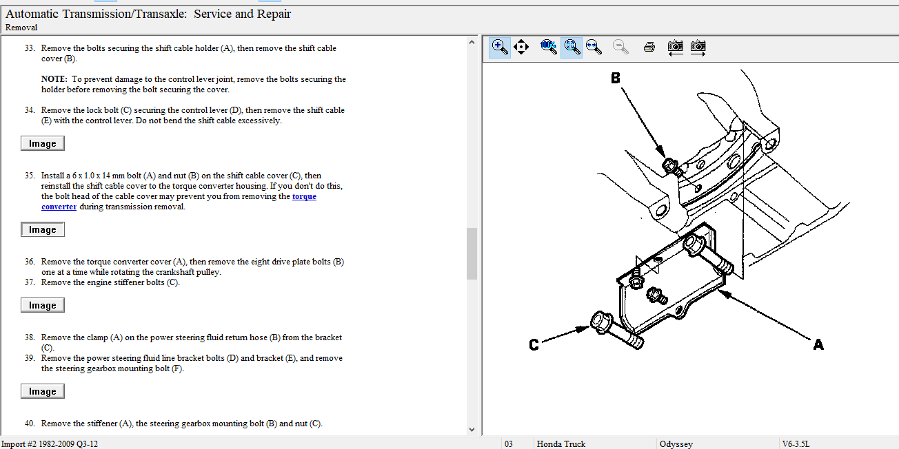

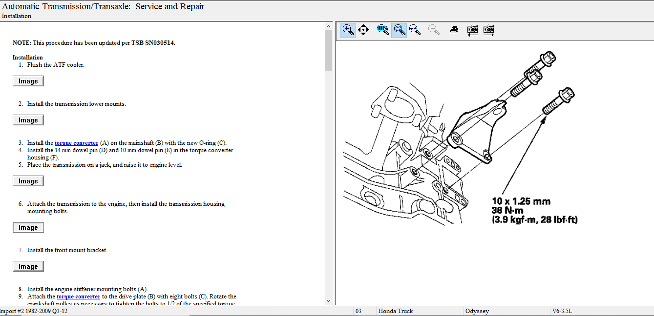

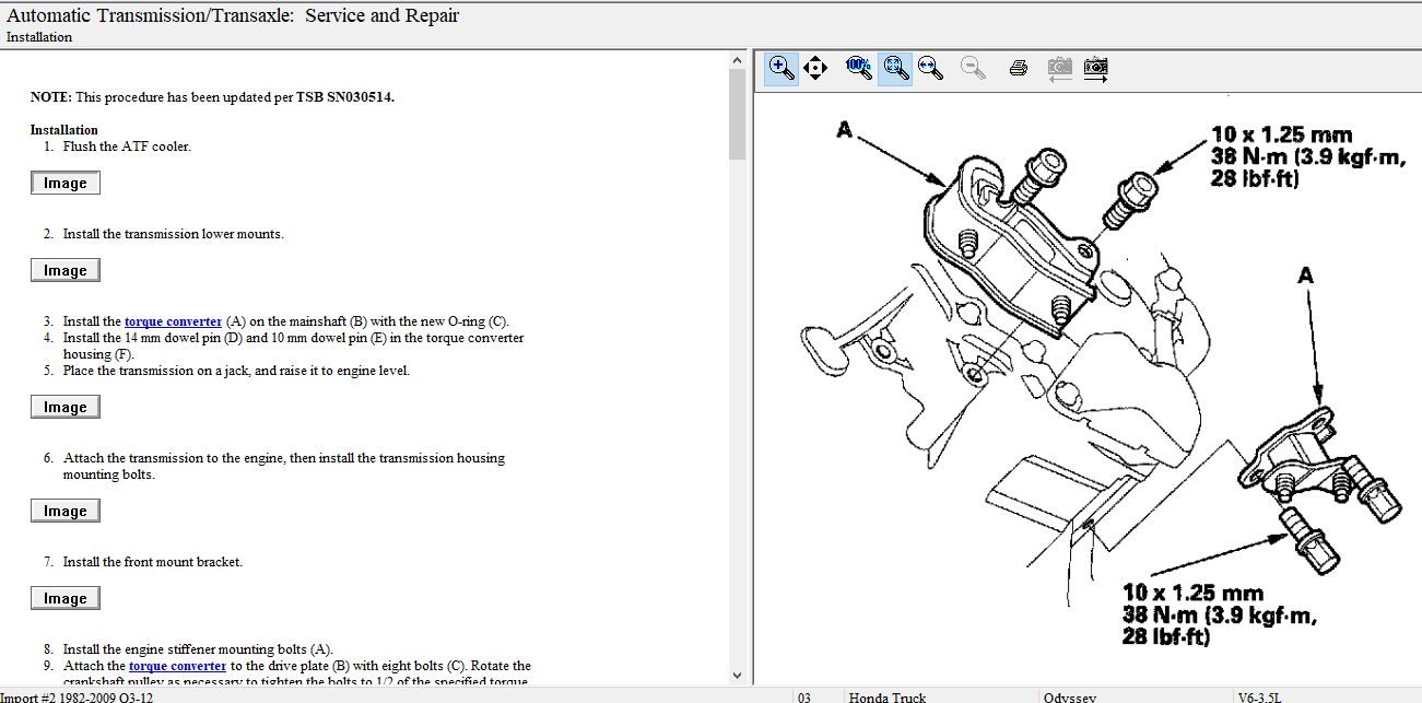

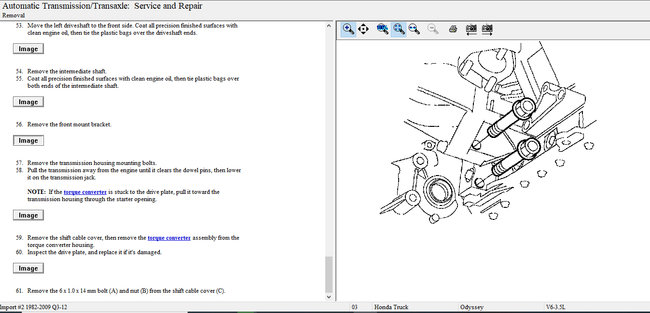

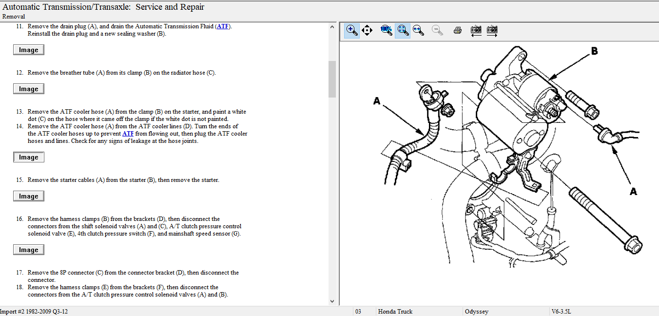

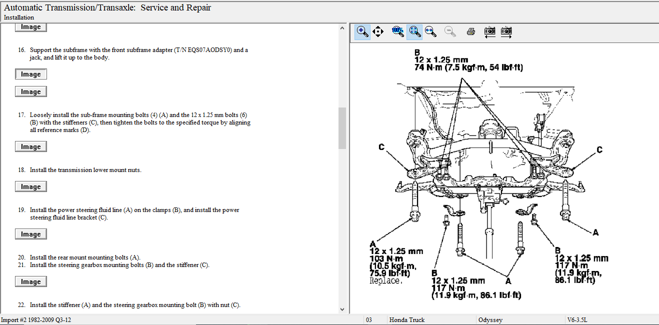

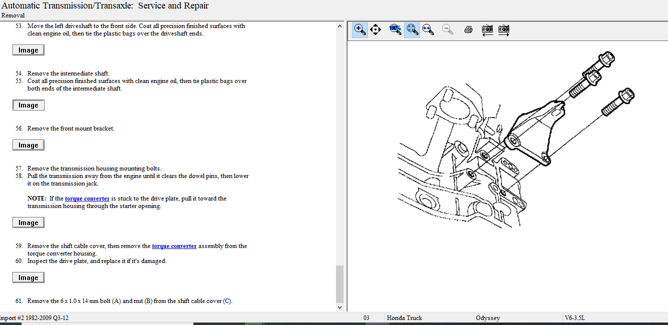

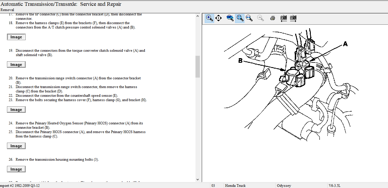

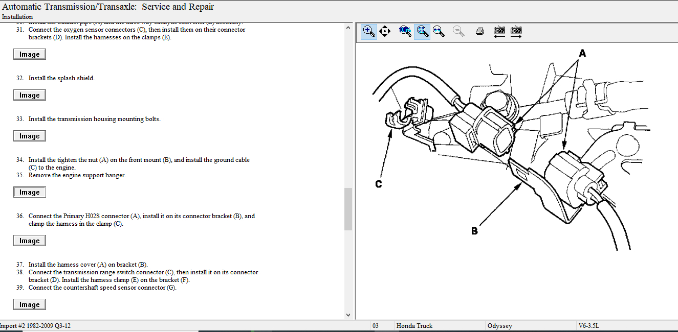

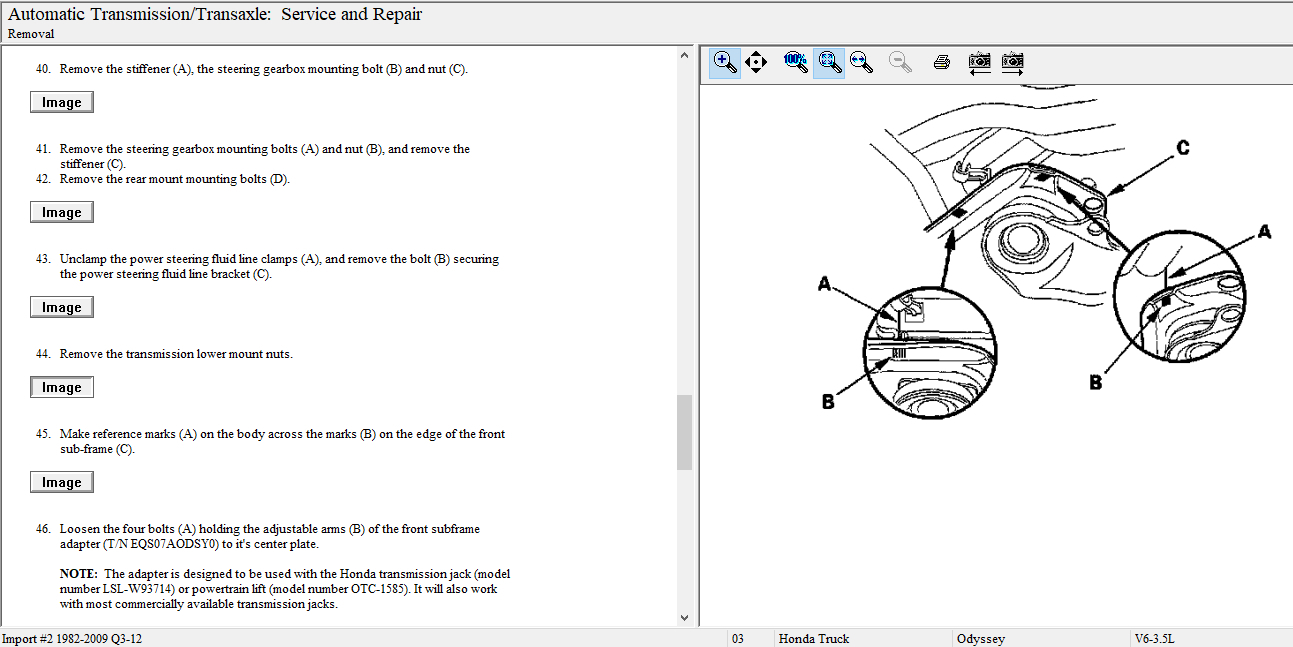

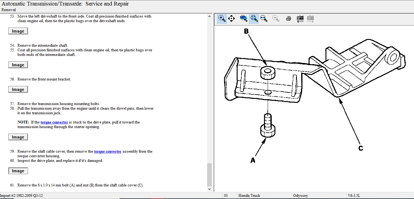

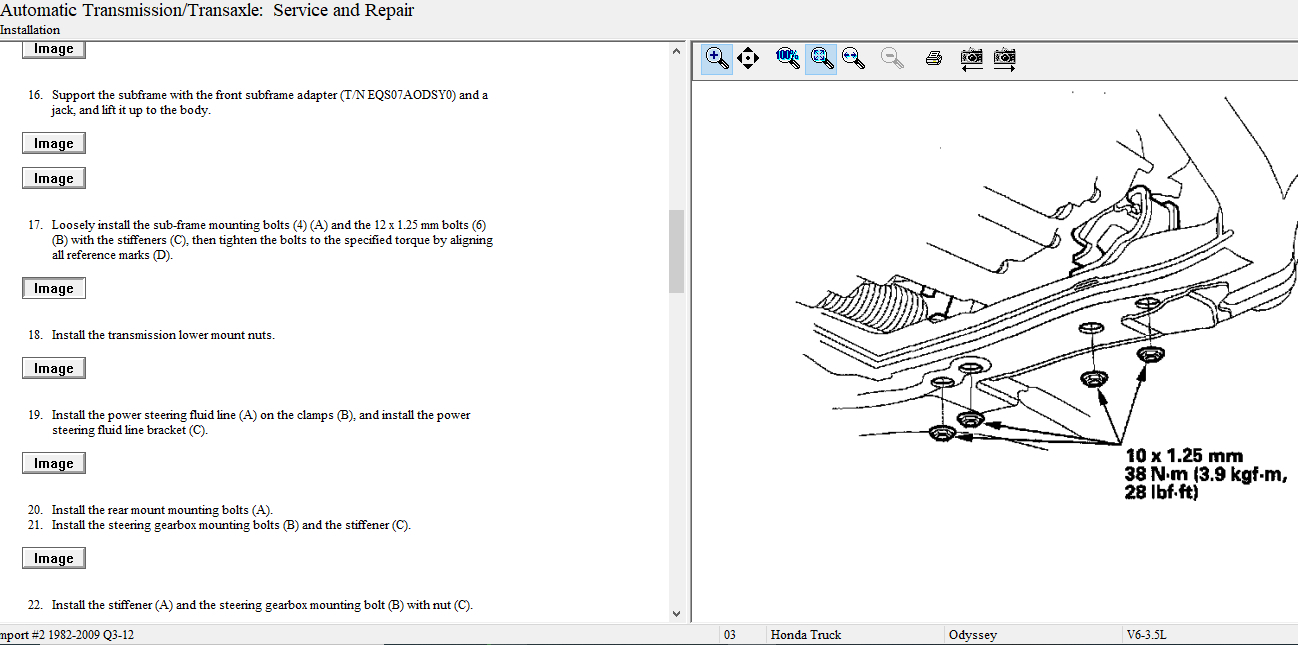

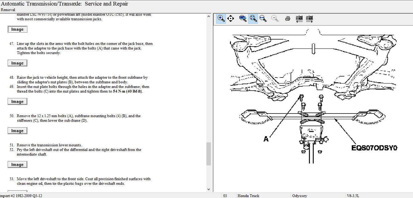

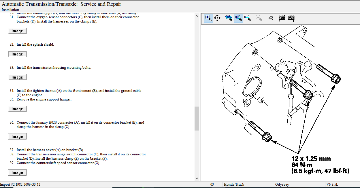

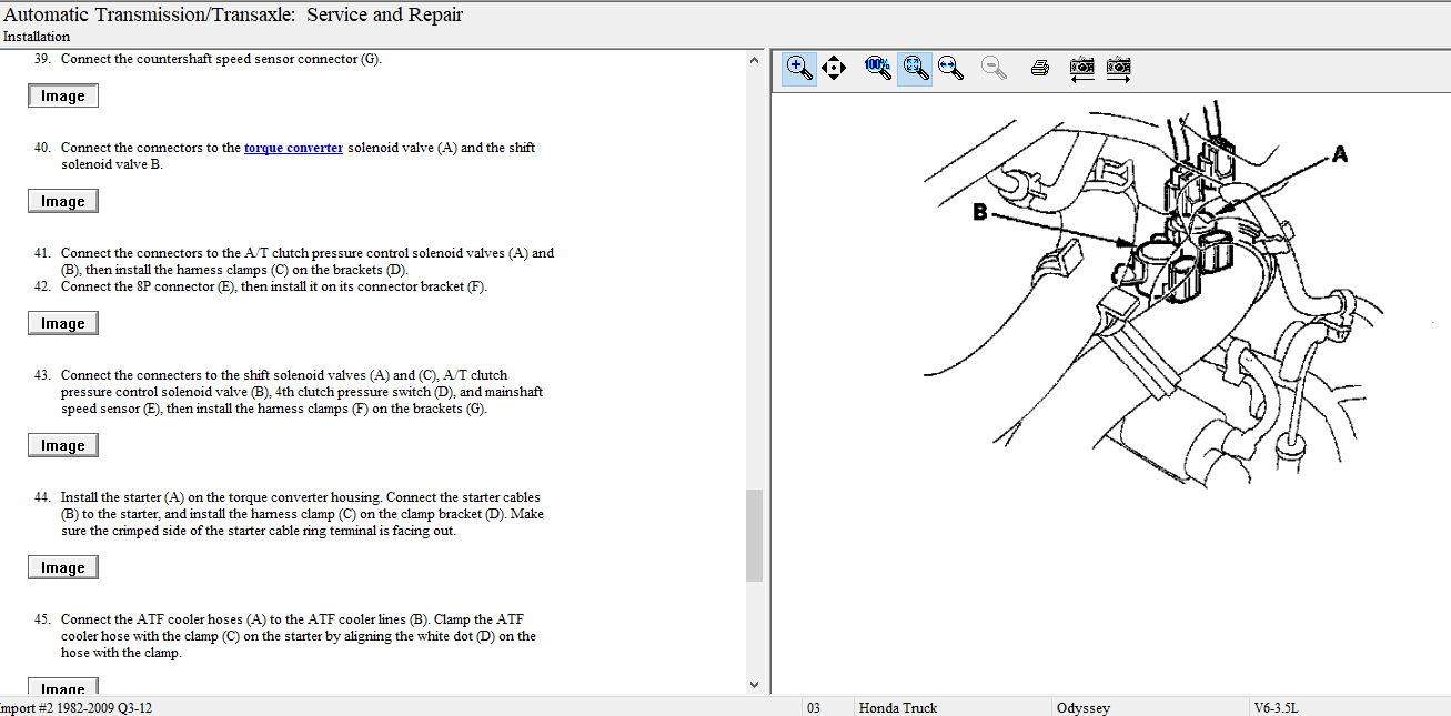

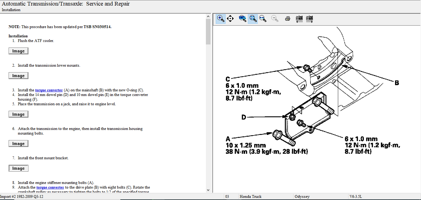

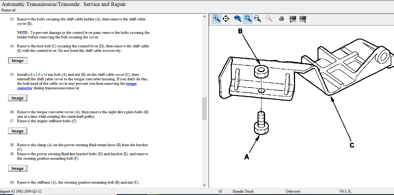

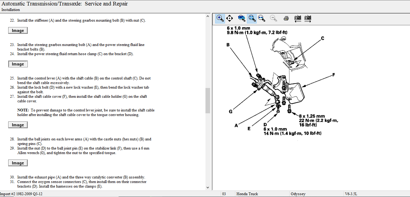

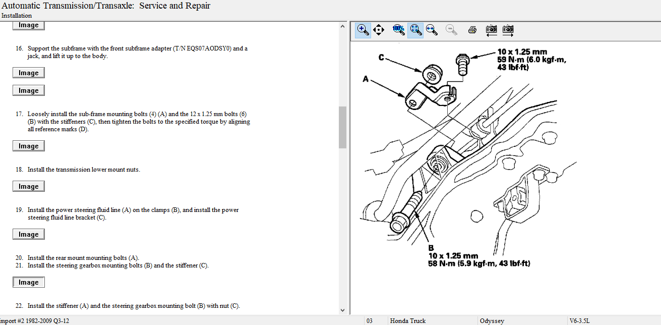

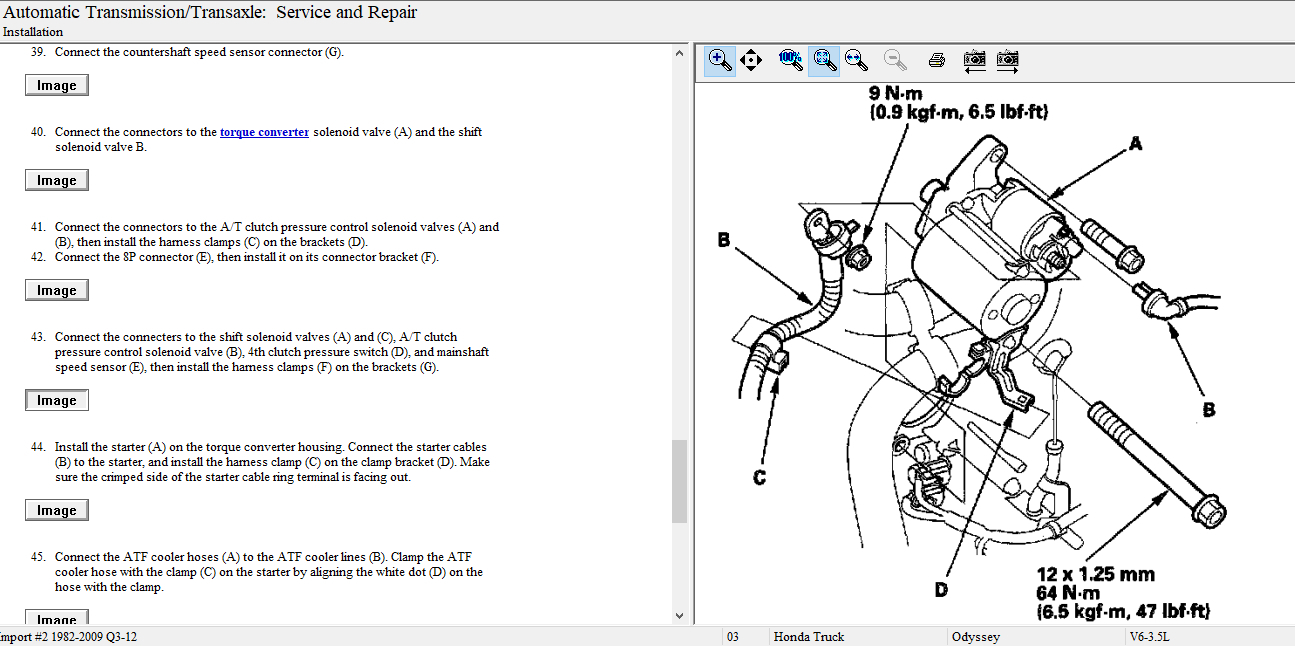

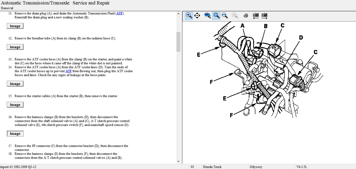

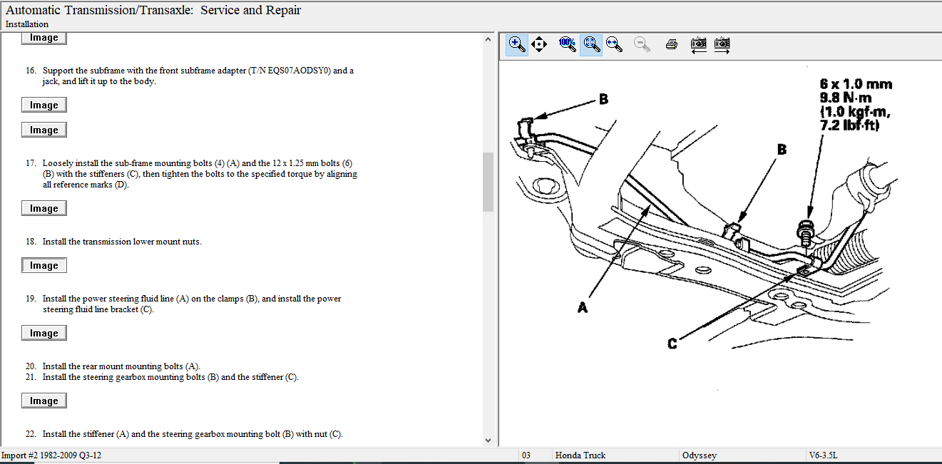

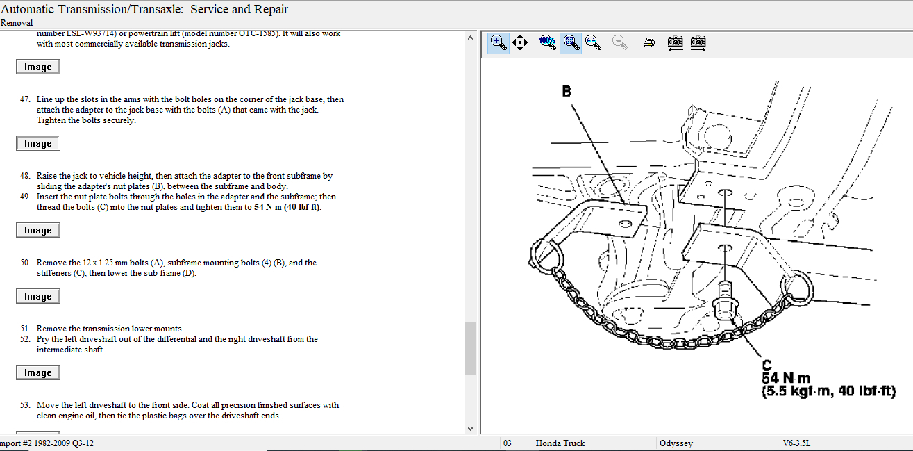

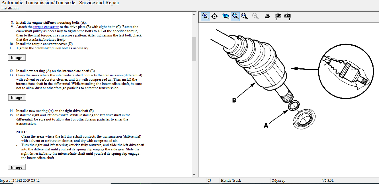

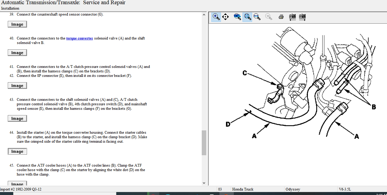

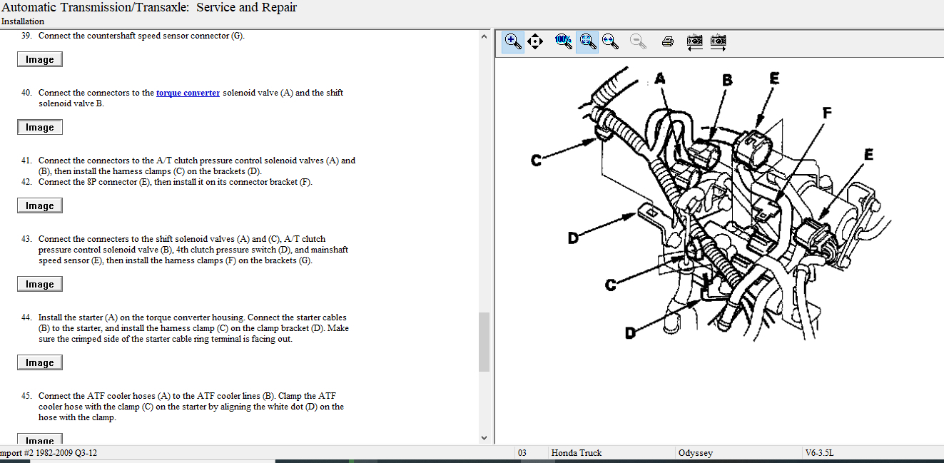

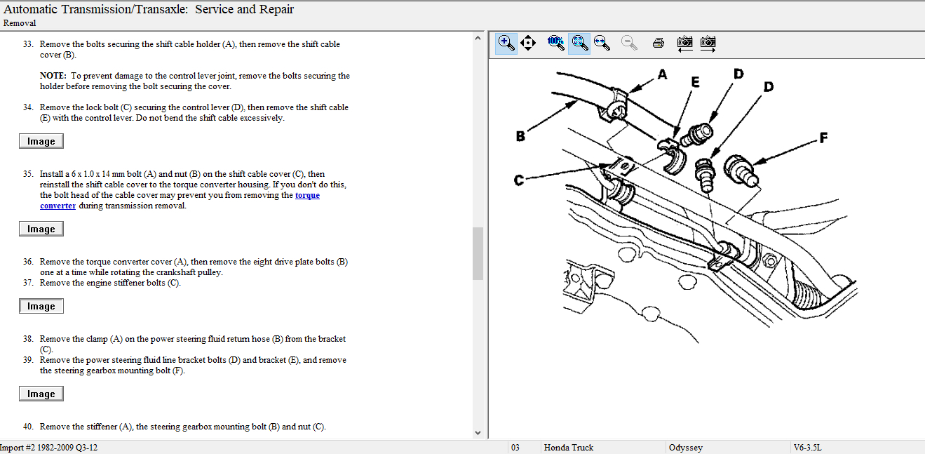

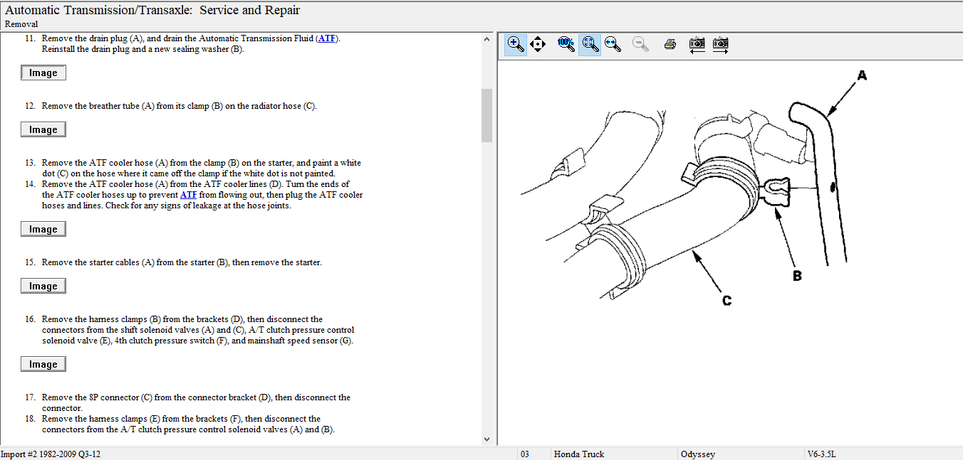

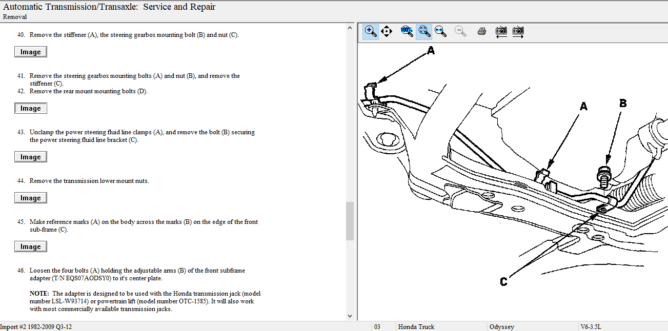

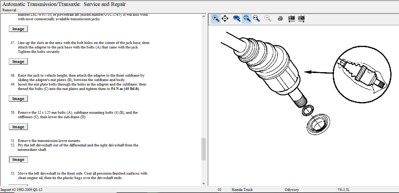

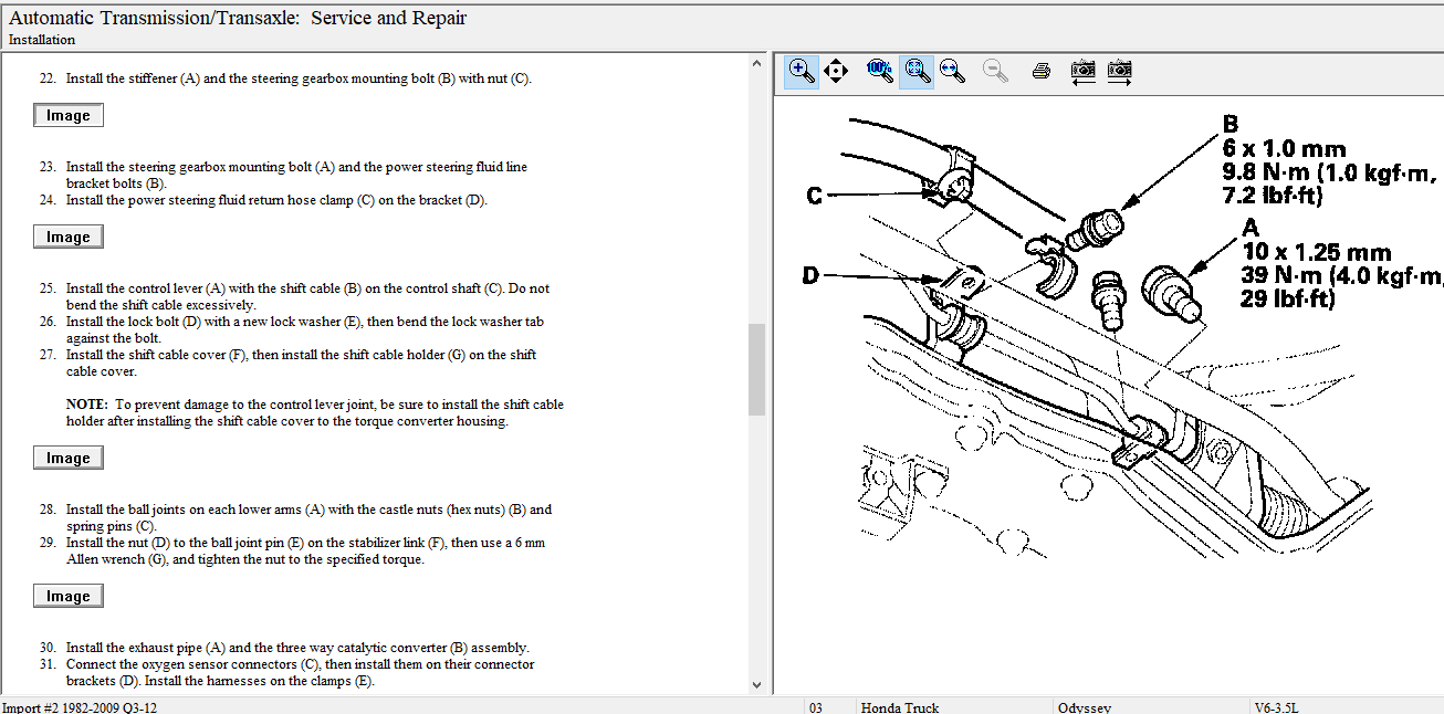

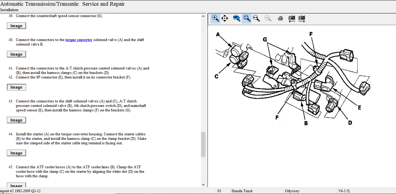

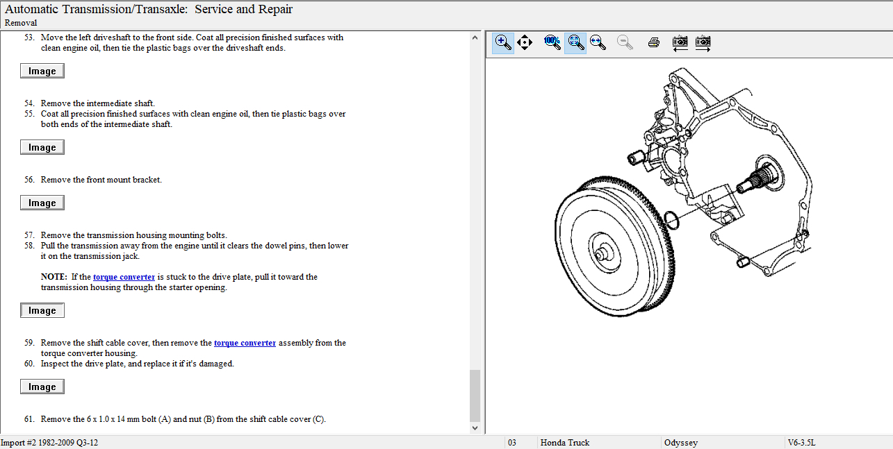

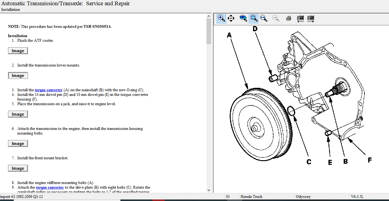

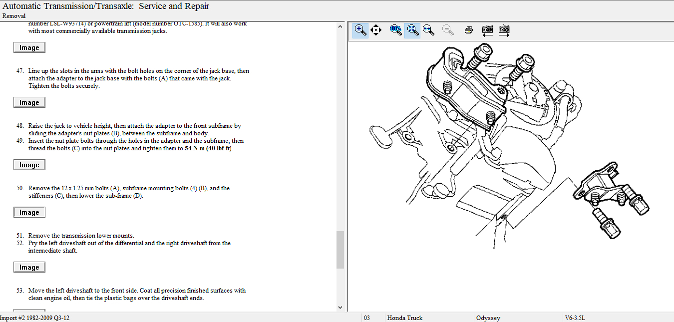

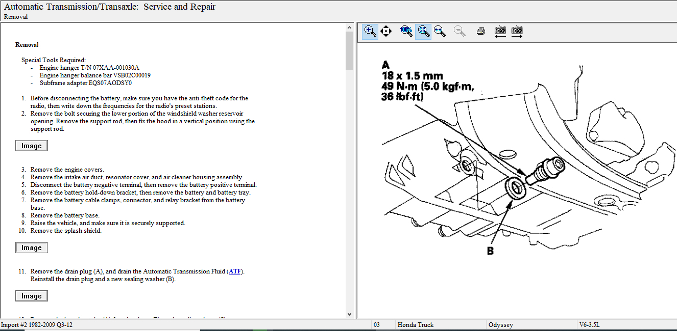

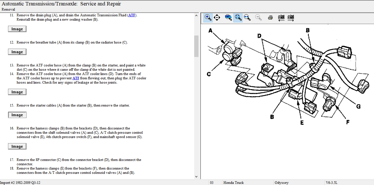

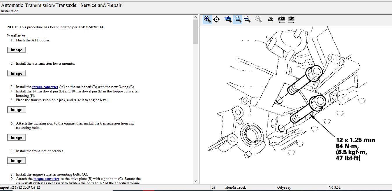

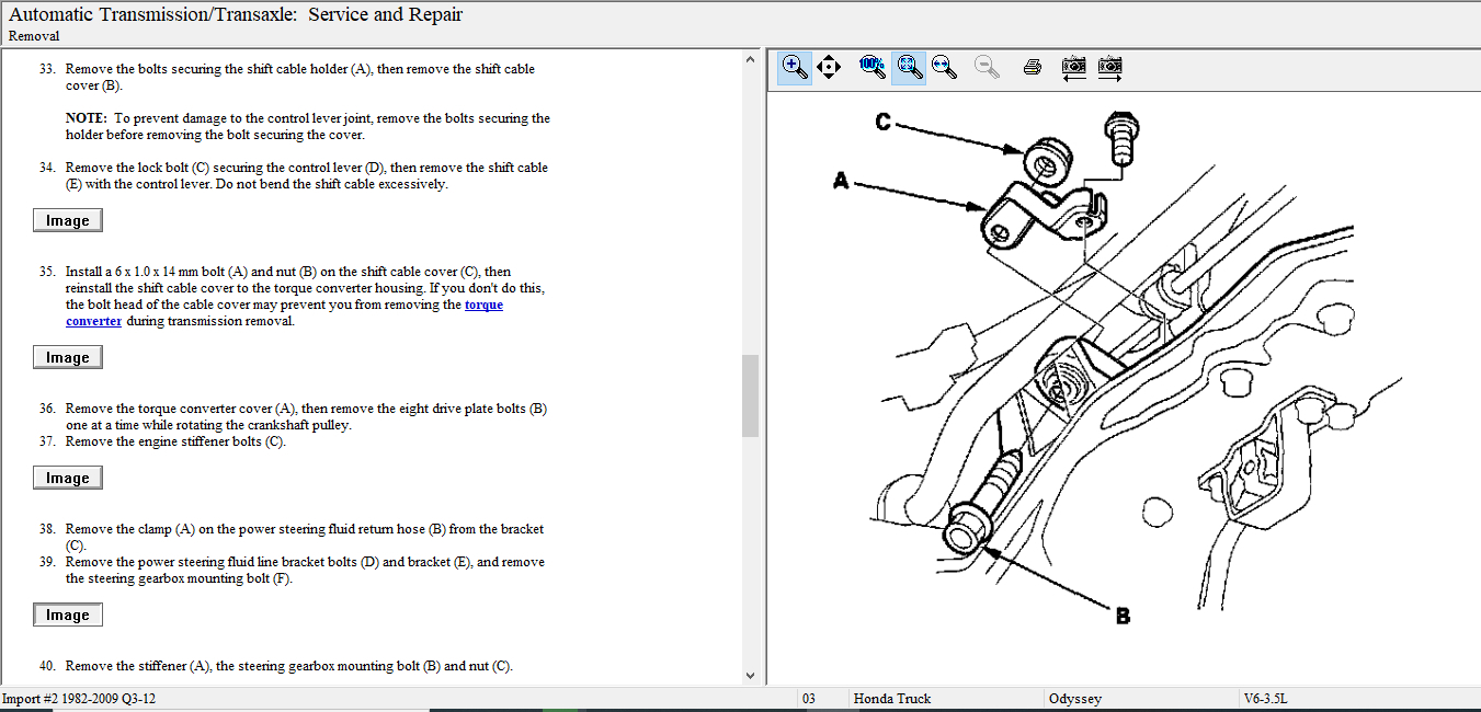

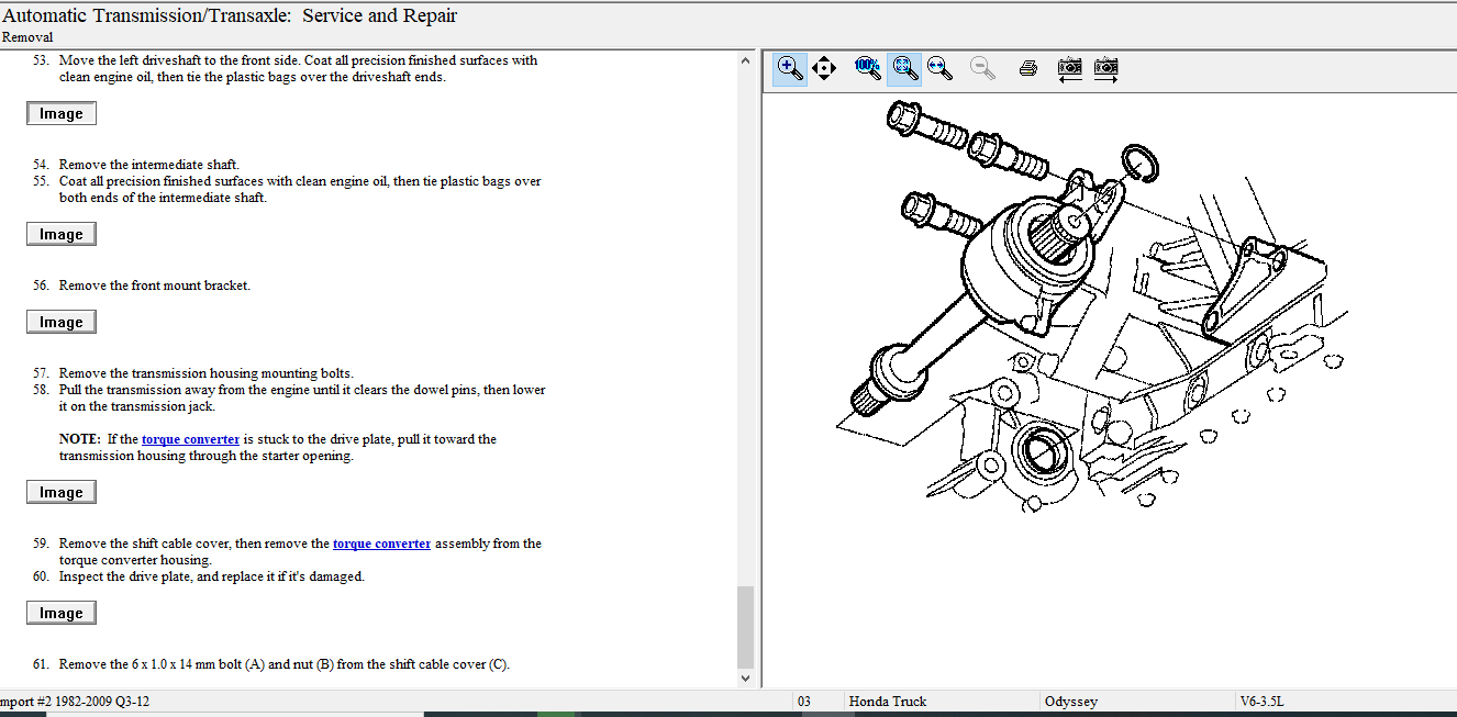

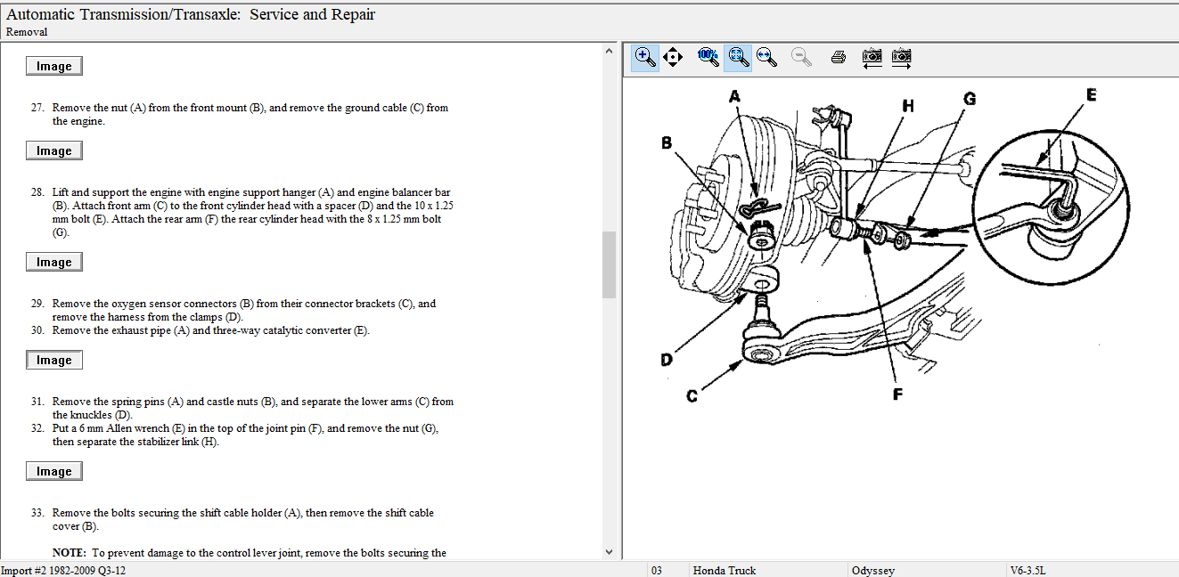

It's not hard to take off but it needs time, check the diagrams below very detailed procedure and steps how to remove and reinstall transmission.
Use power tools to gain time because so much parts will be removed.
Hope these helps. Let us know if you need more help.
