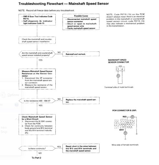

Codes P0715 and P0700
1996 HONDA CIVIC
400 MILES • 1.6L • 4 CYL • AUTOMATIC
BLACK HUSSLE
Code P0715 Transmission input speed sensor.
Code P0700 Transmission Control Solenoid.
Dec 31, 2019 at 2:22 AM
Good morning,

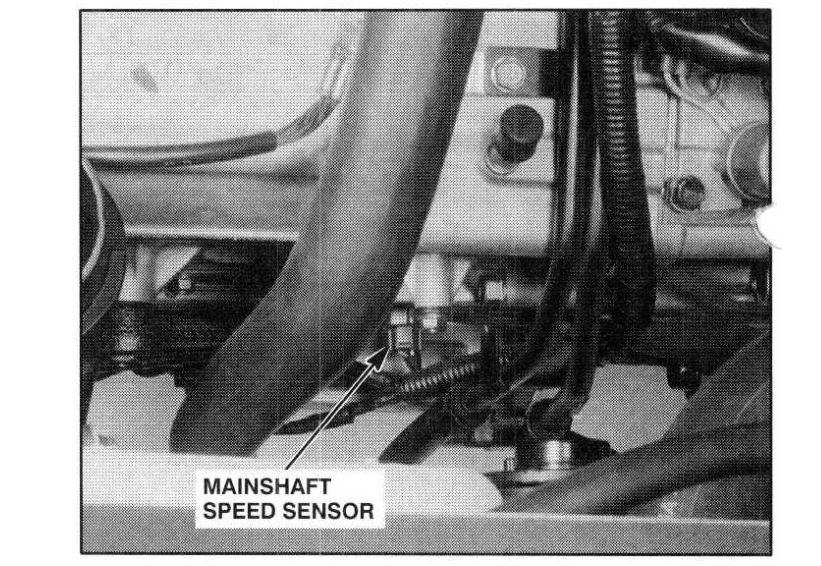

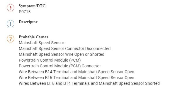

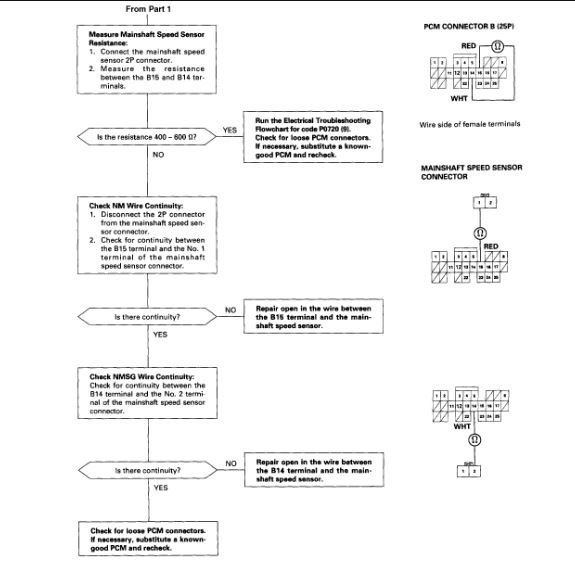

The 700 is a general code that means there is another code.
The 715 is for the speed sensor. It could be the sensor but it also could be several other items as well. I attached the possibilities as well as the flow chart for the code.
