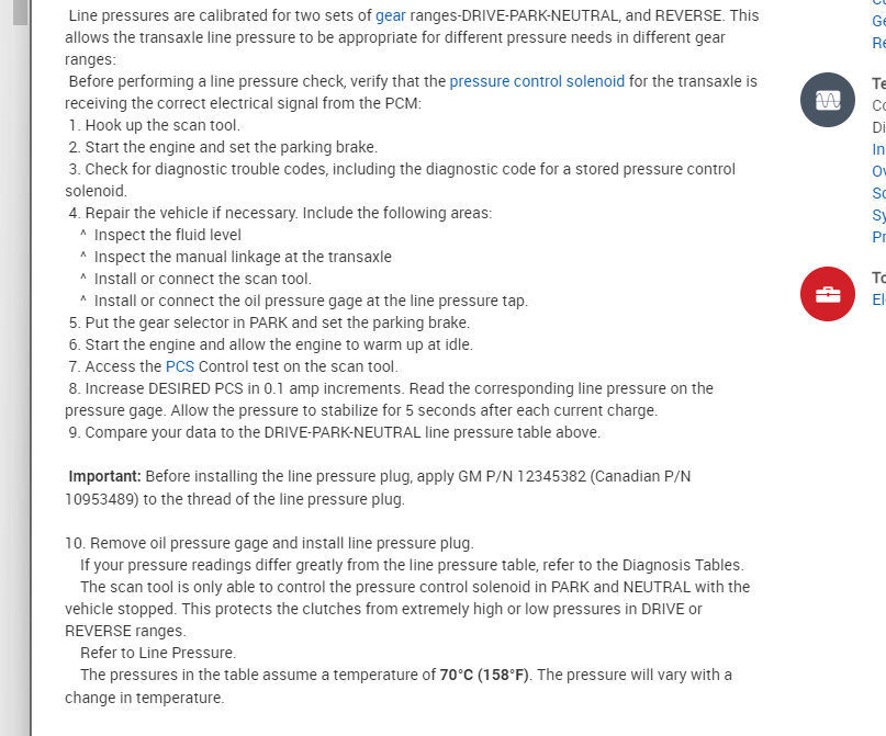

Transmission goes in reverse good and solid; car moves great. Won't go forward at all.

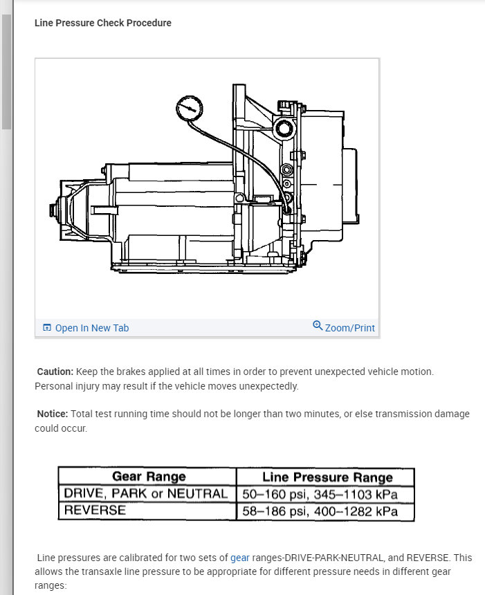

Next, we should check the pressure in the unit and find out if they are correct.
I suspect the pressure is going to be low in drive which means we have internal issues and would need to drop the pan.
Please see the process below and let us know what the pressure is, and we can go from there.
