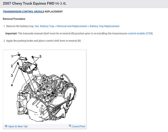

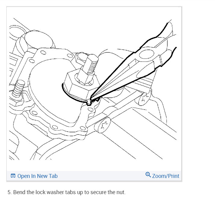

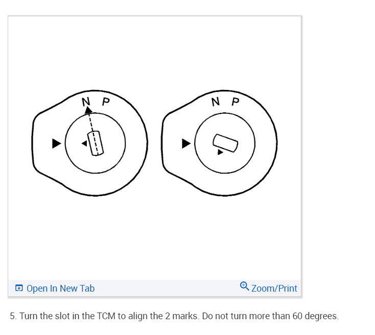

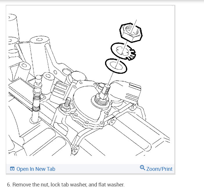

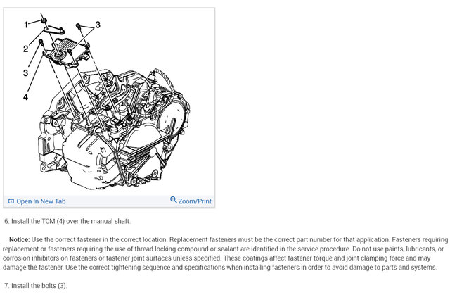

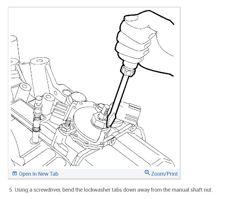

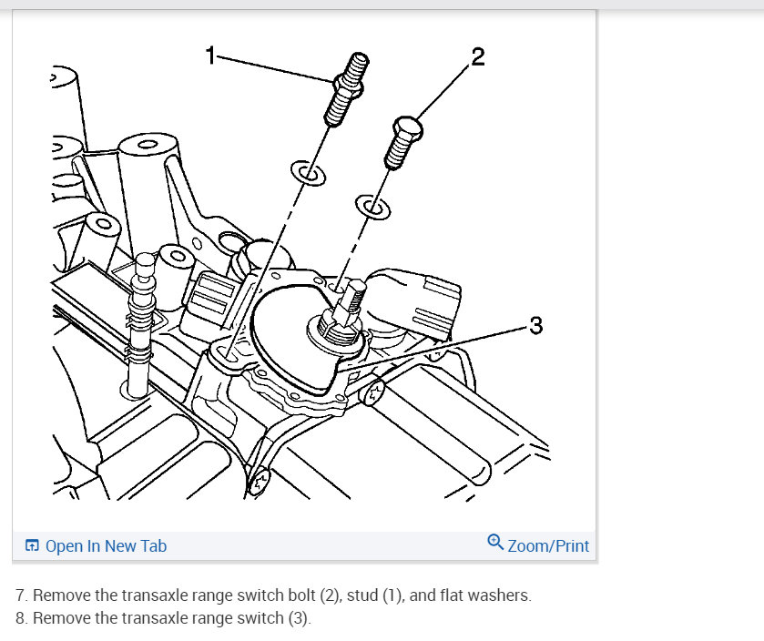

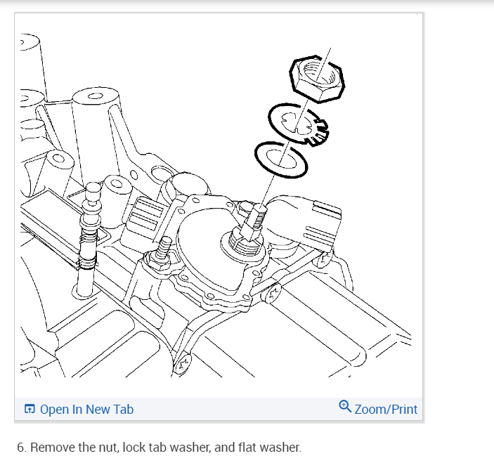

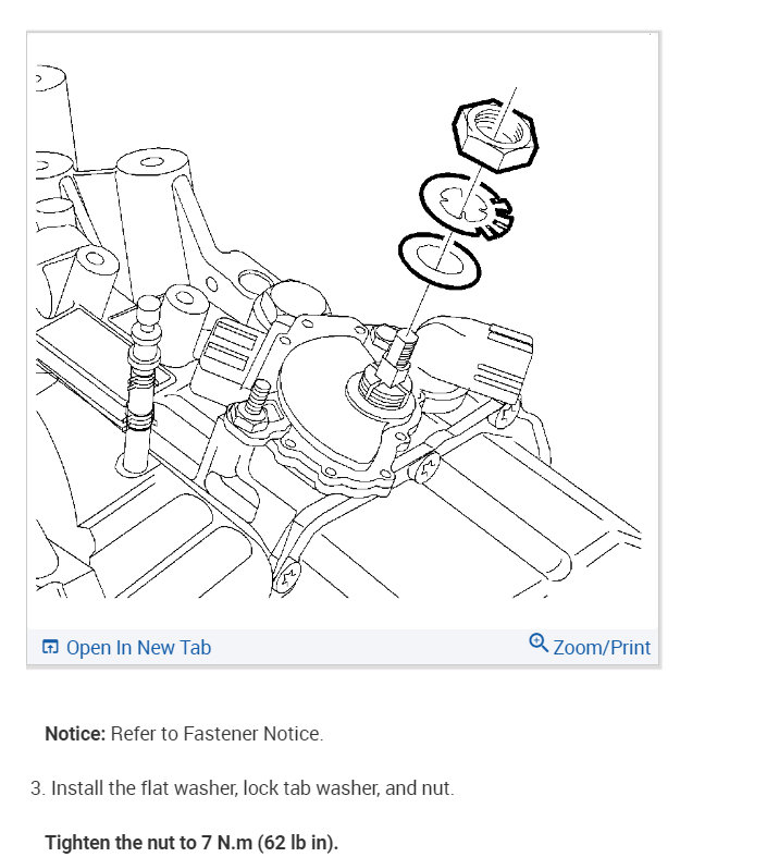

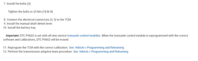

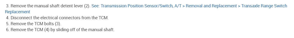

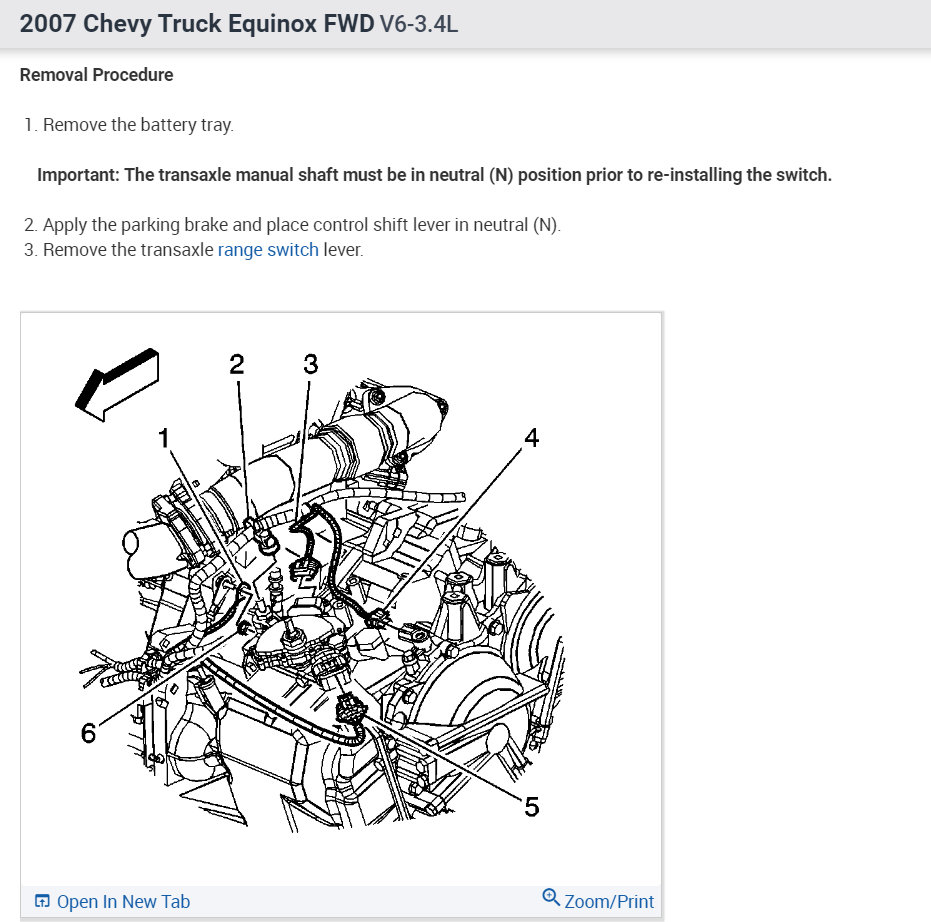

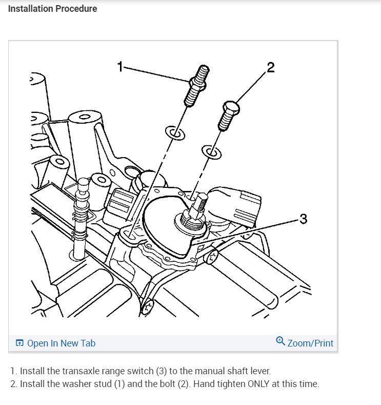

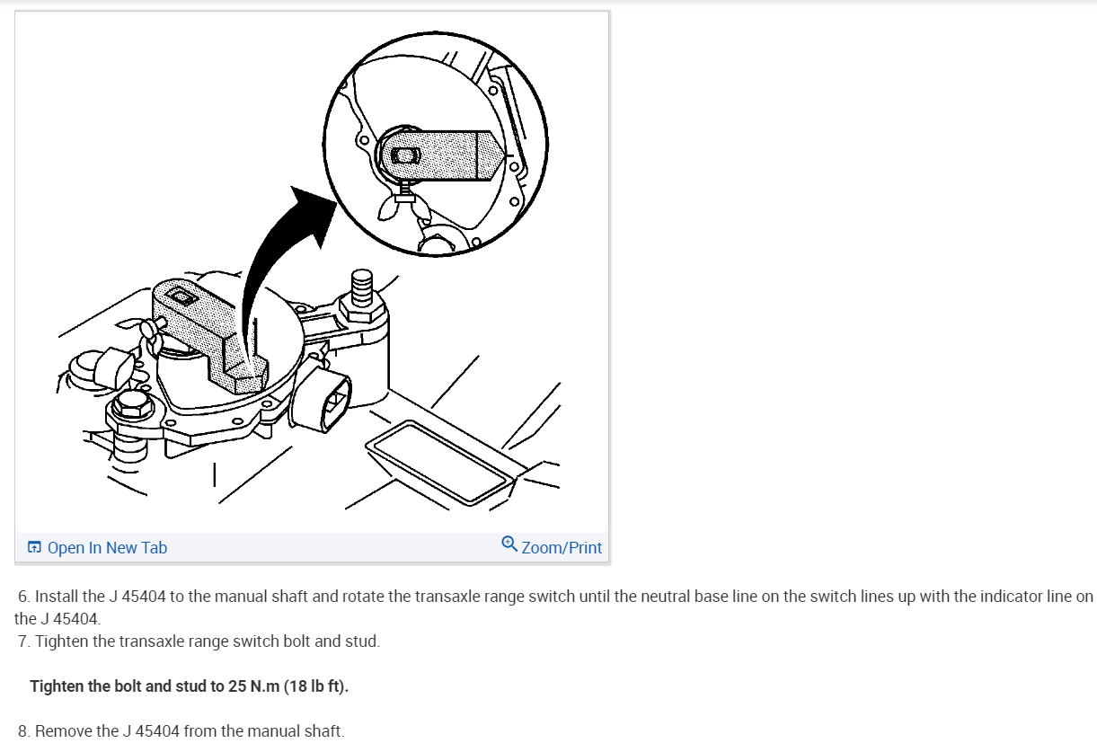

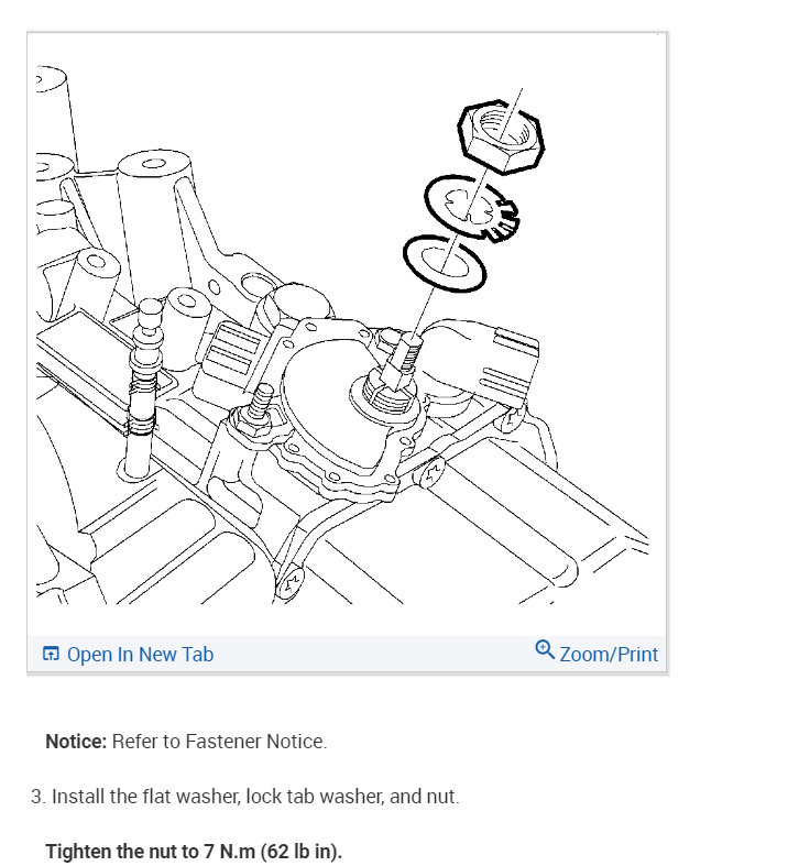

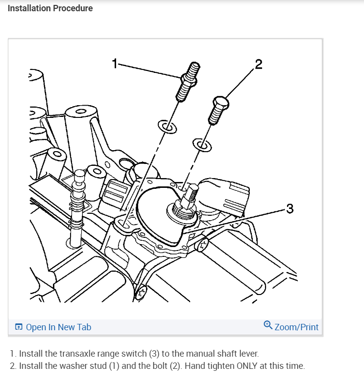

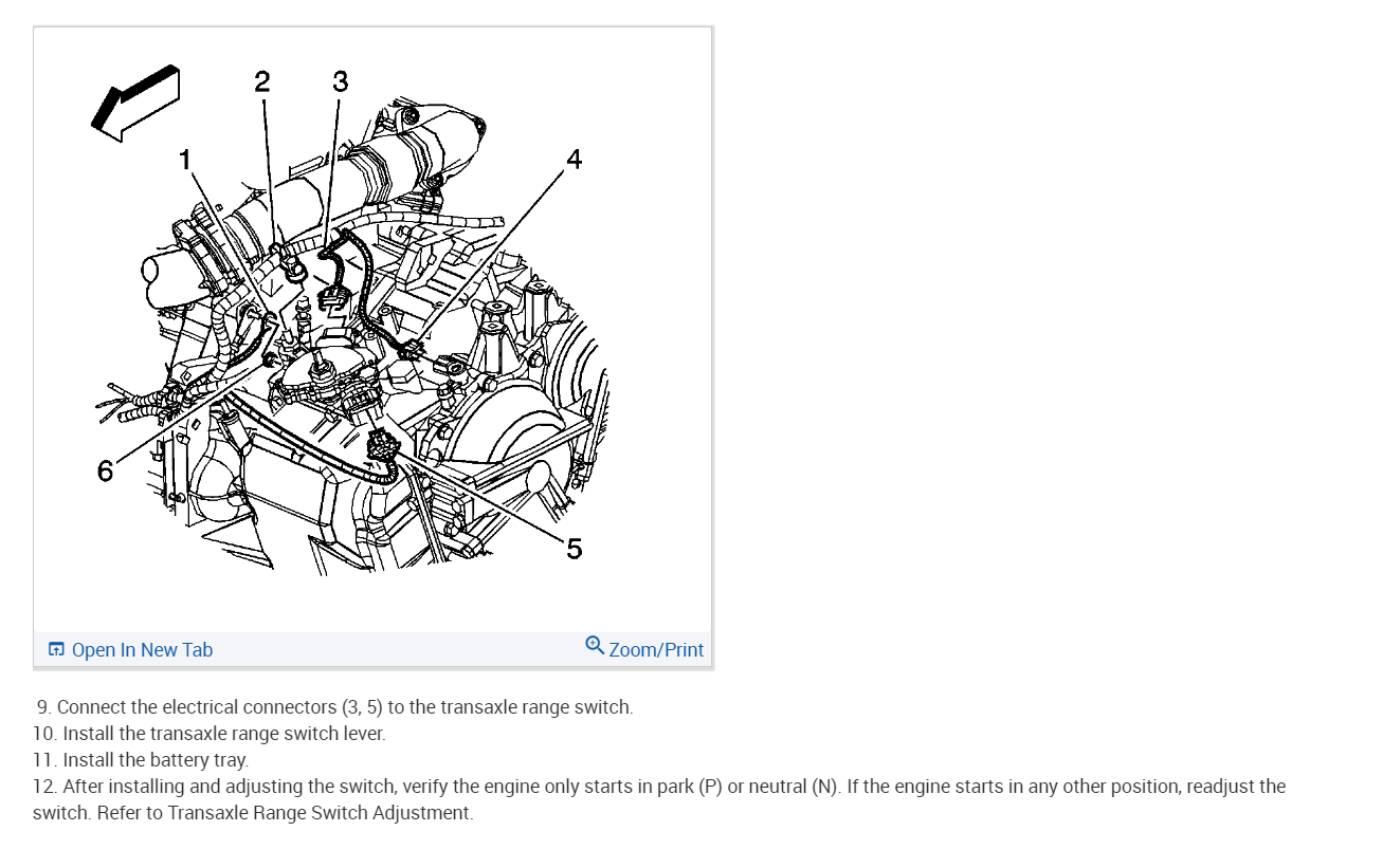

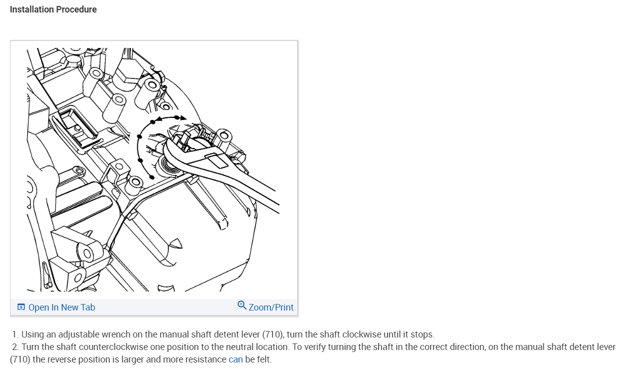

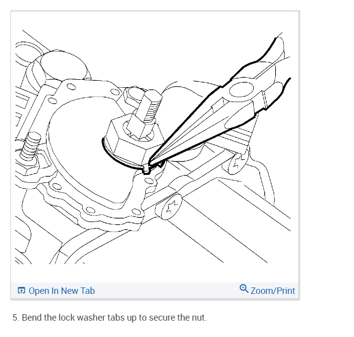

It sounds like the gear range sensor is not working correctly, but we should run the codes to see what comes up. This guide can help, and I have included how to change the sensor out in the images below.
Aug 18, 2022 at 3:41 AM

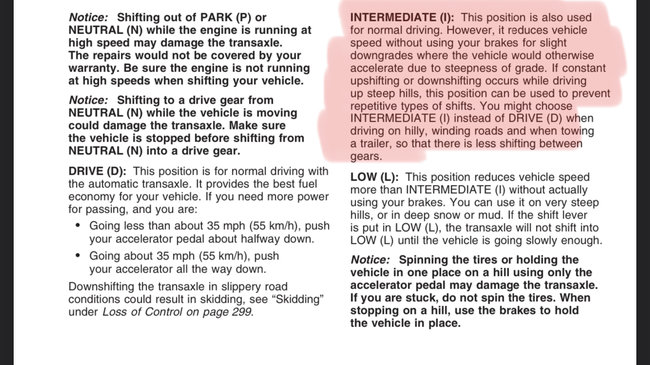

I am not sure what you are talking about, "Intermediate gear?" can you upload an images please?
Aug 19, 2022 at 4:07 AM
NTSTEMMLER

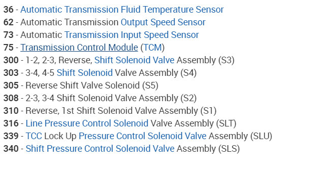

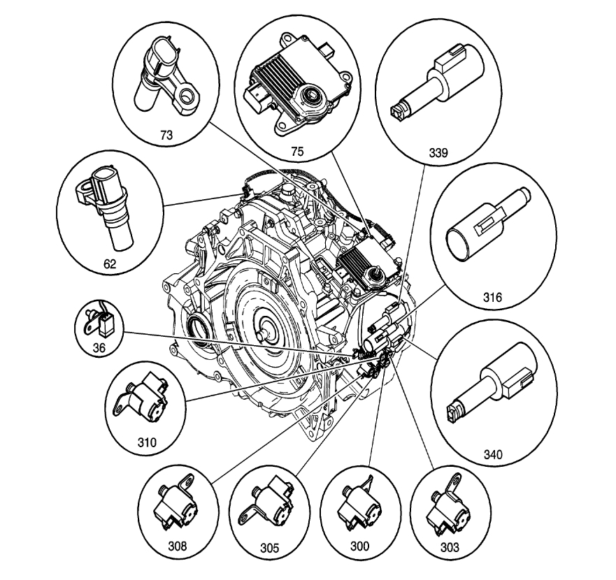

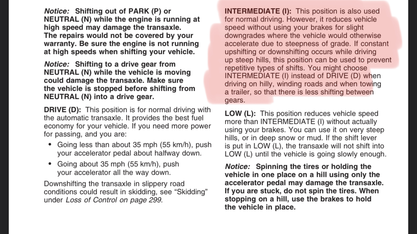

I’ll get a picture/short video when I go to do some body work on the car later. For now I have this from the manual.
Aug 20, 2022 at 11:27 PM

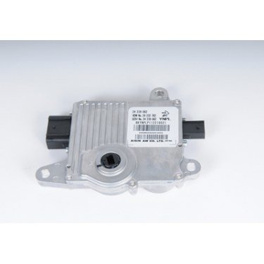

NTSTEMMLER

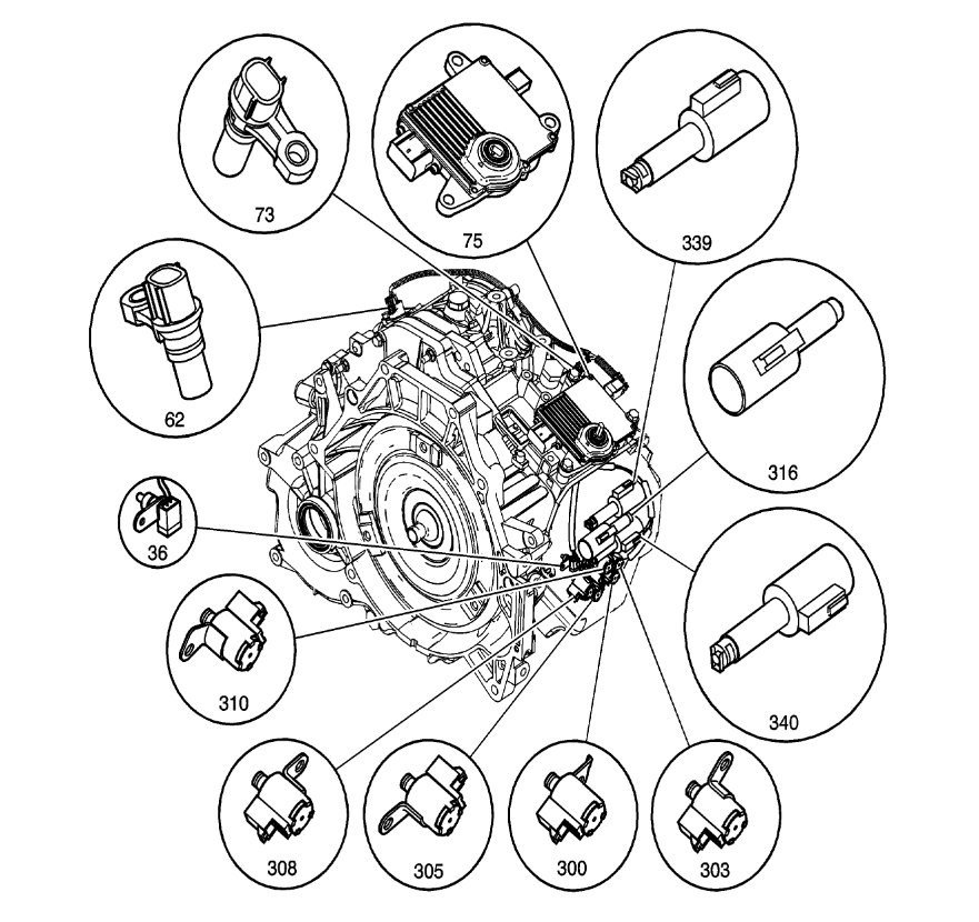

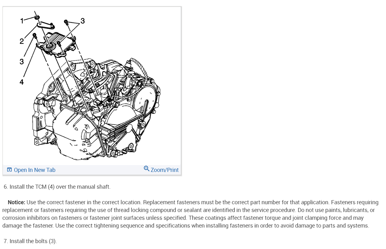

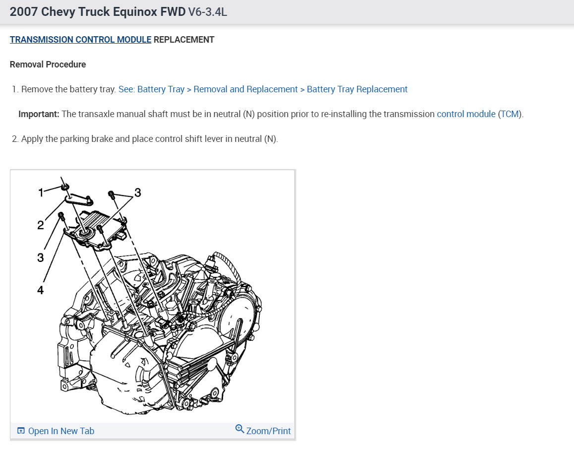

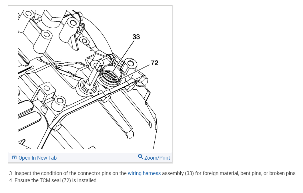

Also, I do not have a gear range sensor like the one pictured in the diagrams you posted. Where that would be, I have this.. Which I believe to be the TCM.
Aug 20, 2022 at 11:31 PM
  • 55,443 POSTS

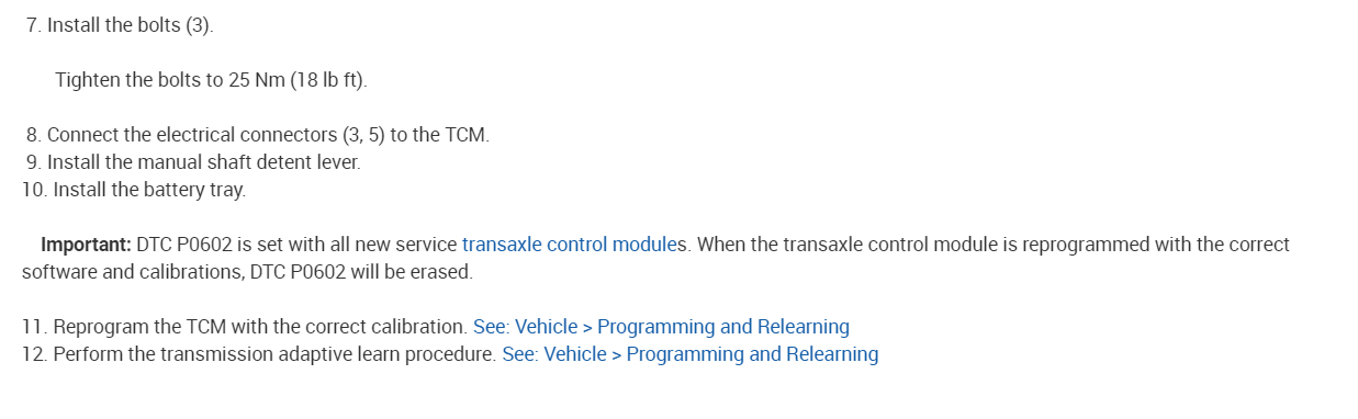

Nice, thanks for the info, yes that is the TCM here is how you replace it in the images below. Let me know what happens please.
