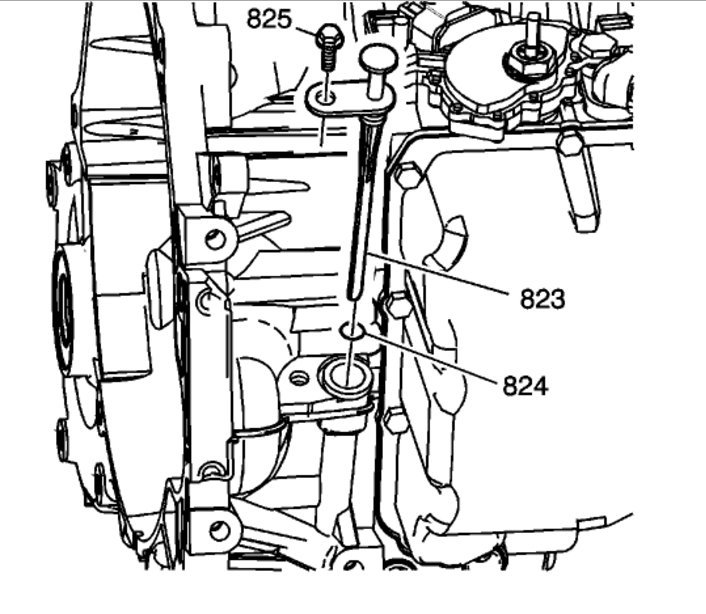

Where is the location for adding the transmission fluid for a 2005 Chevy equinox?
Apr 22, 2013 at 4:08 AM
  • 55,677 POSTS
The transmission fluid level and add tube is near the front of the unit and has a bolt holding the dip stick in.

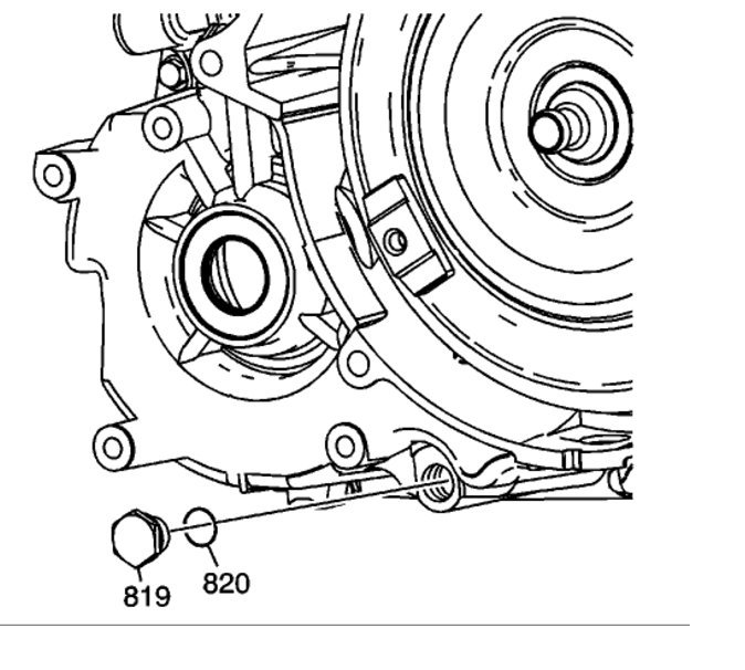

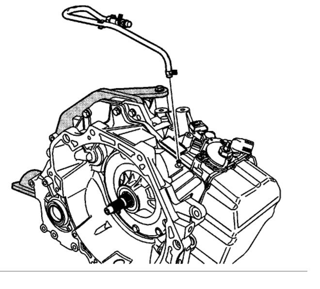

Here is a guide to help you service the unit and some diagrams (below) that will help you get the job done.
