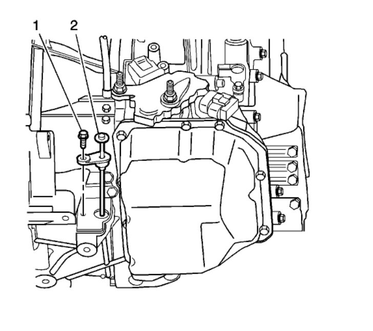

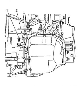

Remove the fluid level indicator located behind the front trans-axle mount.
NOTICE: Do not remove the third gear anchor band bolt located on top of the transmission for checking fluid or adding fluid. Removing the bolt will dislocate internal components and require the transmission to be removed from the vehicle and disassembled for repair.

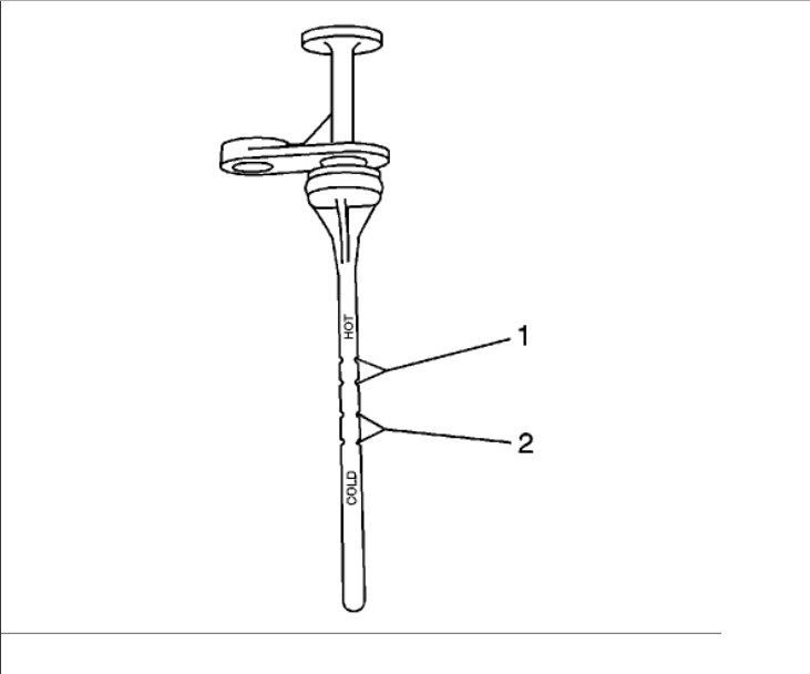

Pull level gauge out again and check if fluid level is within the "HOT" range.

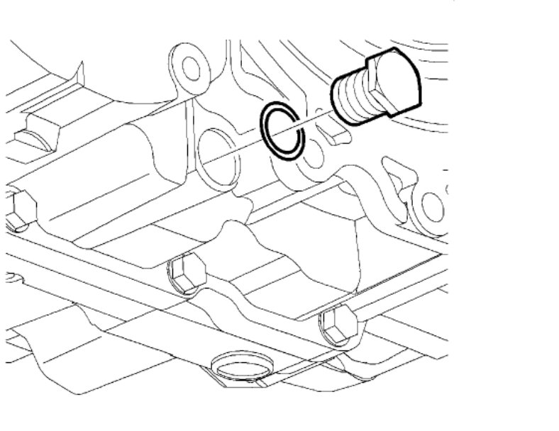

You will need to raise the car up safely to do the repair here is a guide to get you started on that
Here is how you service the transmission and check the fluid once you are done.
Here are the diagrams (below) to show you the location of the drain plug and dip stick

The drainplug is at the bottom of the transmission use a bucket to catch the fluid.

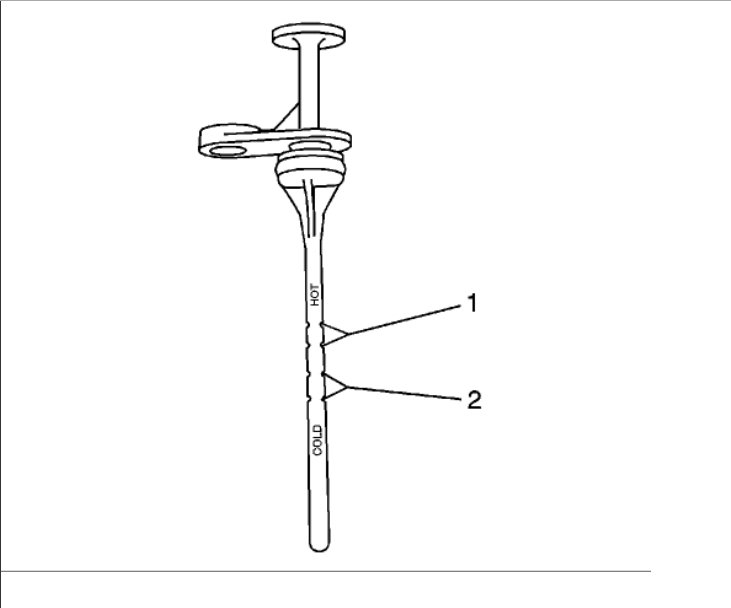

Hi there, With the transmission at normal operating them and in park remove the dip stick and check fluid level (see pics) use ATF fluid TIV.

howdy, I want to know where the transaxle fill plug is. On top of tranny, side near the dipstick, or do I add the fluid at the dipstick area?

yep you should add teh GM T-IV fluid to the transaxle using the fluid level dipstick location.
