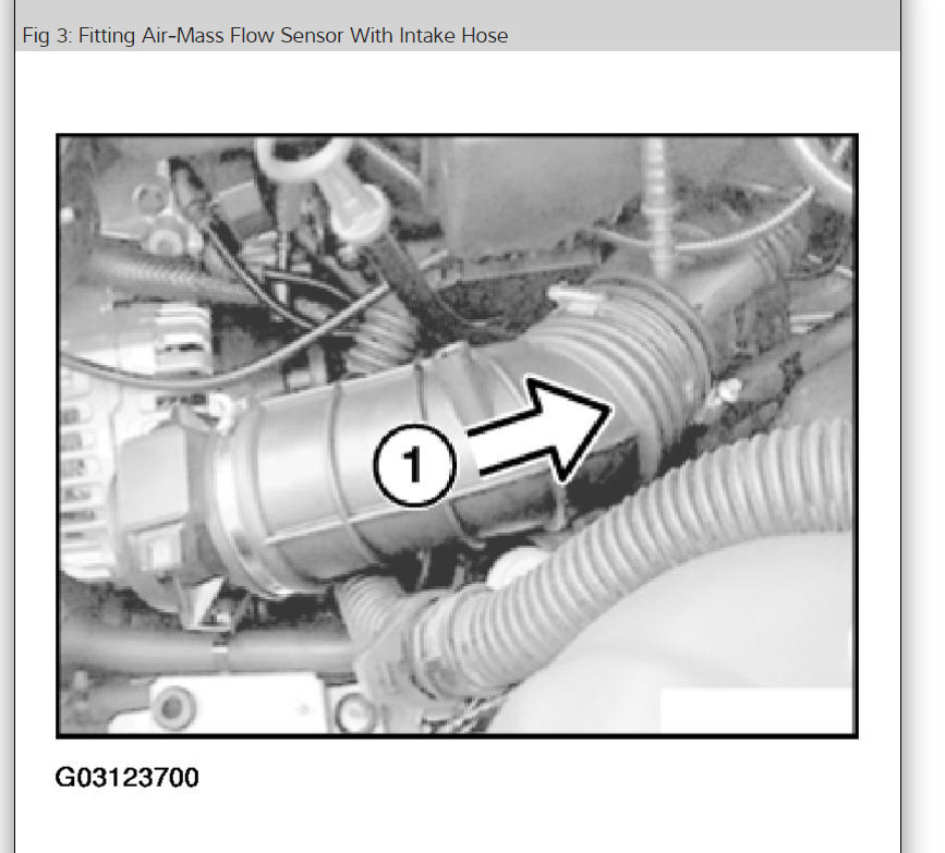

My car was idling very roughly. A friend's mechanic drove 35 miles to my home and replaced all the spark plugs. It was still idling a little roughly, but seemed better. About two weeks later, the speedometer suddenly stopped working; it would only go from 0-20 mph regardless of how fast I was driving. During that same ride, I noticed the car seemed very sluggish and slow, especially on hills. As I got closer to home, an orange warning light on the dashboard came on. When I arrived home, the car had to strain to make it up the incline where I park. When I got out, I noticed a burning smell.
The manual says the orange warning light (an exclamation point) indicates the car is operating in "emergency transmission mode." The manual said to turn the motor off, engage the parking brake, and restart the engine a minute or two later and the light should go off. I did those steps but the light was still on. I started the car two days later, and the warning light still appeared. I drove to an AutoZone five blocks away for a free diagnostic scan that said two spark plugs were misfiring, the ignition coil needed to be replaced and there was some type of problem with the transmission.

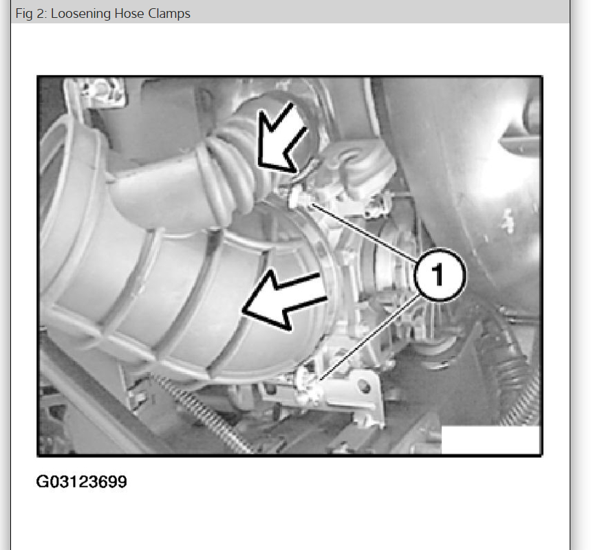

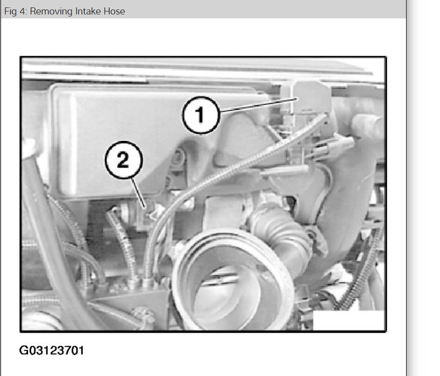

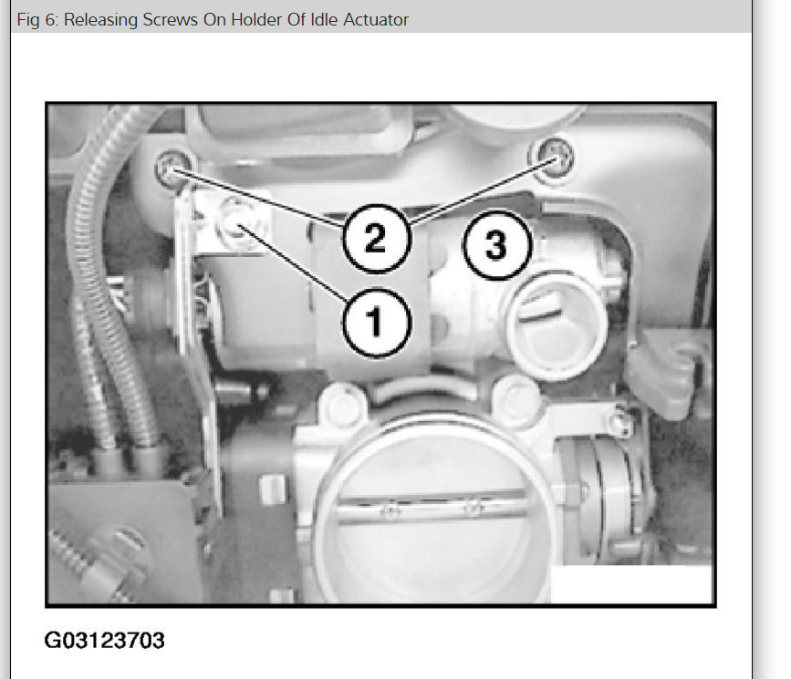

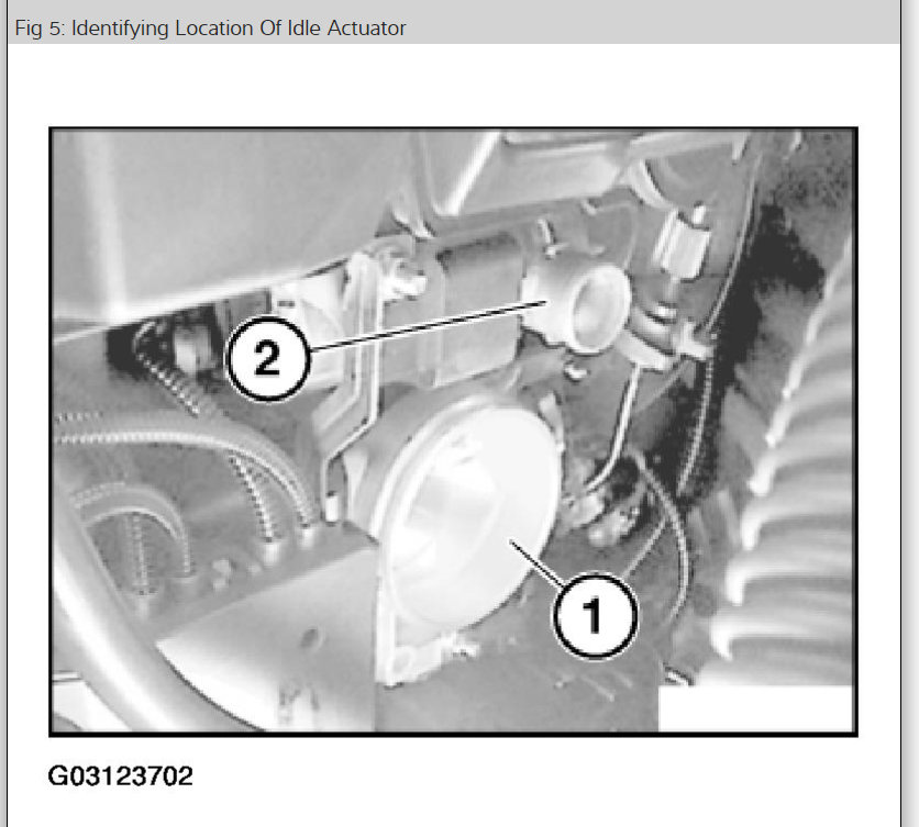

Yes, go get the car from AMMCO. I will help guide you through the repairs. I would start by cleaning the throttle body and clearing the codes. Disconnect the battery before you begin. Here are two guides to help walk you through the repairs and diagrams below to show you how on your car:
