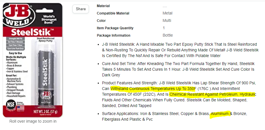

The transmission housing (bell housing) has a hairline crack at the l lower left side and the fluid is seeping out slowly when parked but fast as the car is driving. Can the crack be fixed, or does it need to be replaced?

It likely could be welded. However, it is aluminum, and you will need someone that can TIG weld. Please keep in mind that I'm not sure where it is leaking other than the lower left. Are you certain it is the bell housing and not a pan leak? I ask because it's odd that it would leak faster when running unless it is in a pressurized section.

No problem whatsoever. The bell housing is what attaches to the engine. What you described sounds like the transmission housing.
It's interesting that it's worse when it runs because if it is at the fill port, the fluid is at its highest point with the engine off. When started, it drops to the fill port level.
Because of the location, it may need to be removed to have it tig welded. They make products that may help temporarily. Actually, it may last the life of the vehicle, but I can't be sure. Take a look at the pic below.
If you decided to use something like this (there are other brands), the area needing repair must be clean and dry. I would recommend using something like a brake cleaner to remove any oil and dirt from the transmission. If you have access and the area needs to be repaired and it's flat and smooth, take sandpaper and rough the area so it has a better chance to stick tightly.
Let me know your thoughts.
Take care and let me know if you have questions.
See pic below.

Thank you for the help, I'll go with your advice! It's sounds salvageable so I'll try and get a repairman that can do the job. Unfortunately, there aren't many TIG welders where I am from, and the big companies snatch them up. I spoke to a mechanic friend of mine, and he said he'll be able to repair it with something called fiberglass resin or and resin, any idea if his method would or can get the job done?
Sep 12, 2022 at 11:38 PM
  • 110,244 POSTS
It will certainly slow things down. I believe the resin can be porous and still allow it to seep. See what he thinks of the product I mentioned above.
All in all, the most important thing is to have the part for repair to be clean and dry so what you use has a chance to adhere properly.
Sep 13, 2022 at 6:16 AM
DARRON 242
  • 5 POSTS
Spoke with him today and he said your recommendation was better, so I'll go with it...Thank you again!
