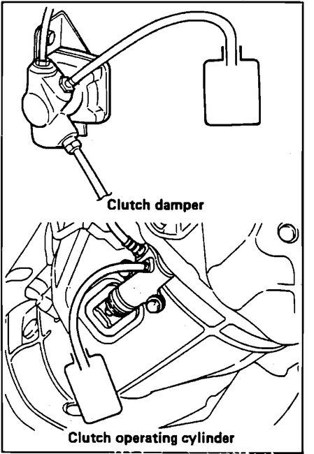

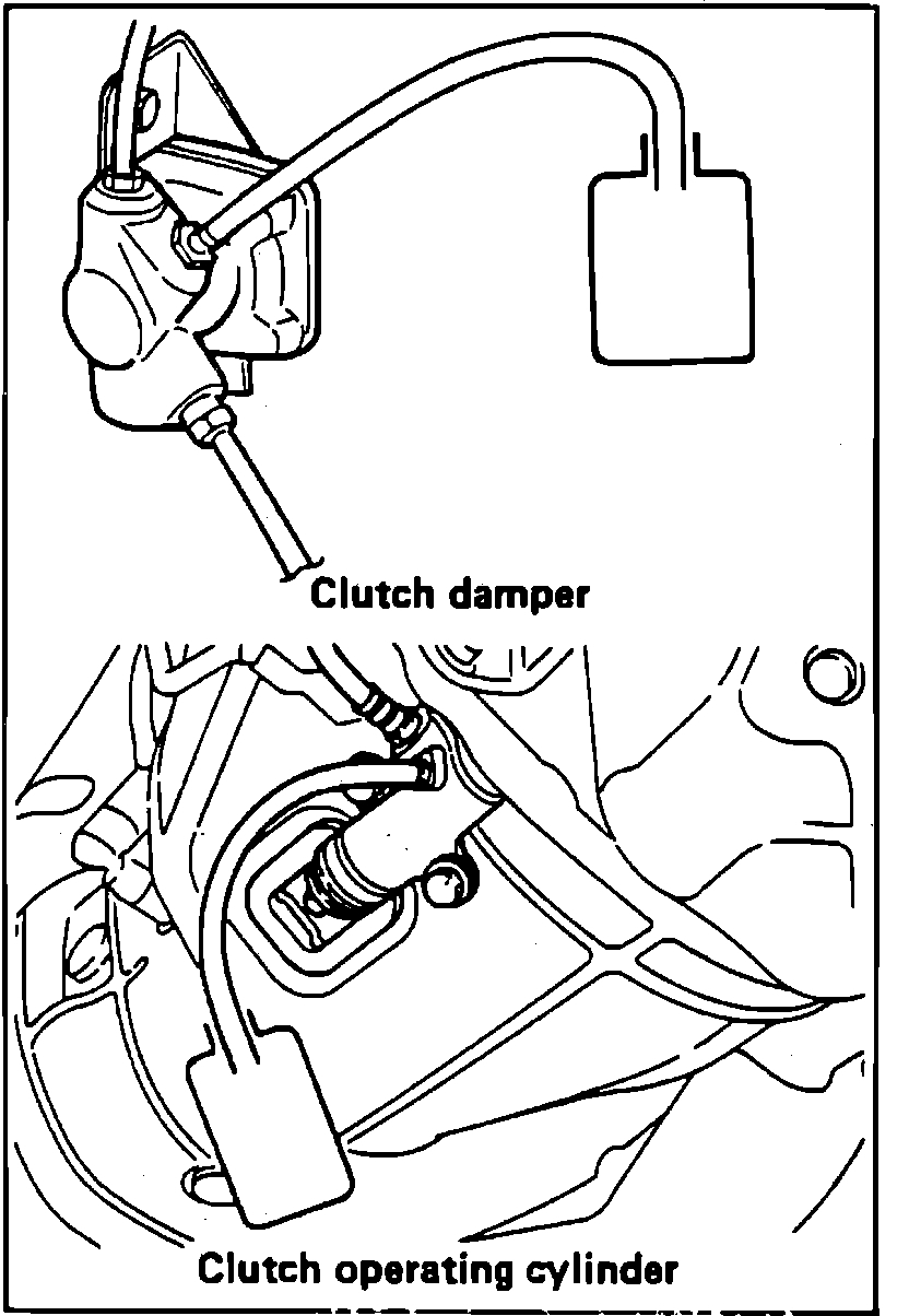

If it shifts with the engine off but not when running, the clutch isn't disengaging. Lets start with bleeding the hydraulic clutch system. Here are the directions:
CLUTCH BLEEDING PROCEDURE
Fig. 2 Bleeding Clutch Damper & Operating Cylinder
Carefully monitor fluid level at master cylinder curing bleeding operation.
1. Fill reservoir with recommended brake fluid.
2. Connect transparent vinyl tube to air bleeder valve, Fig. 2.
3. Fully depress clutch pedal several times.
4. With clutch pedal fully depressed, open bleeder valve to release air.
5. Close bleeder valve.
6. Repeat steps three through five until clear brake fluid comes out of bleeder valve.
If the clutch master cylinder and slave cylinder are good and working, then I suspect the release bearing may not have been properly installed.
Let me know if bleeding helps or if you have other questions,

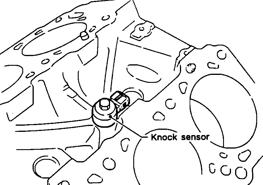

Yea. Thought i would. But did not want to. But where is the knock sensor on that 3.0. And what color wire is it? I have a wire at back of motor that at one time was hooked up. The wire is white with black stripe.
Jan 13, 2019 at 3:47 AM
  • 110,244 POSTS
Hello everyone. The knock sensor is located under the the intake. I attached a picture of it. It has a two pin connector. I've checked two different manuals for color identification, and it doesn't provide it.
