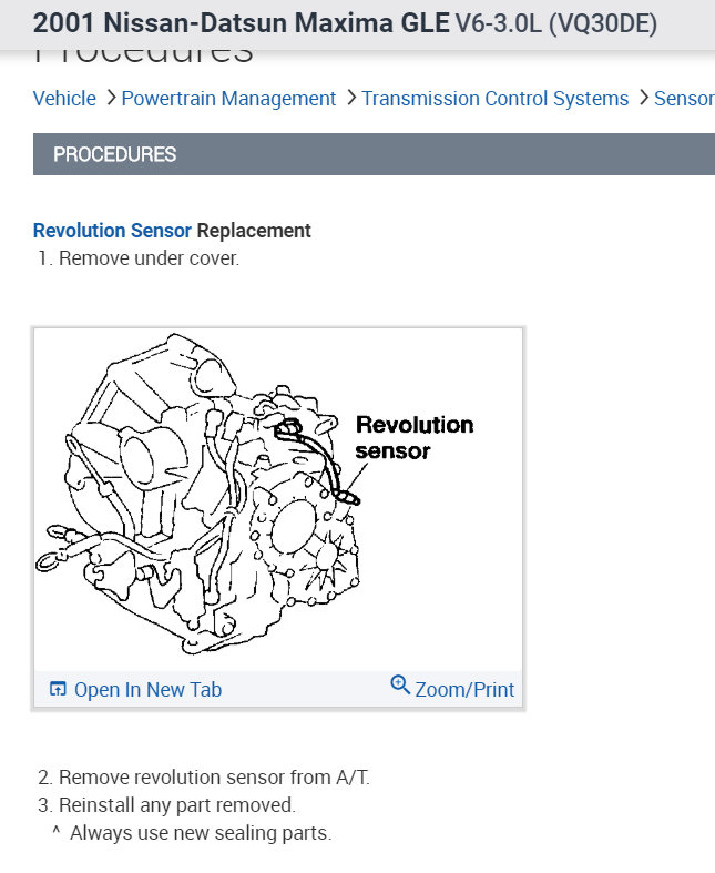

This does sound like the revolution shaft sensor is out. can I ask if you replaced the sensor with an OEM unit? Lets run the codes to see. here is a guide with the sensor location in the diagrams below:

Have changed the sensor in the past-worked for a while the when it went out I replaced it with a aftermarket part. I’ve just replaced the resister assembly and am due for a transmission flush anytime now. would you suggest me getting a Toshiba sensor over the other manufacturers? And I had thought about dropping the transmission pan and changing the filter although I flush it every 50,000 as advised with B&G “quick clean. and conditioner. Thanks For the help.
Aug 4, 2020 at 10:38 AM (Merged)
  • 55,286 POSTS
Yes, I would get an OEM sensor and replace it. Let me know what happens

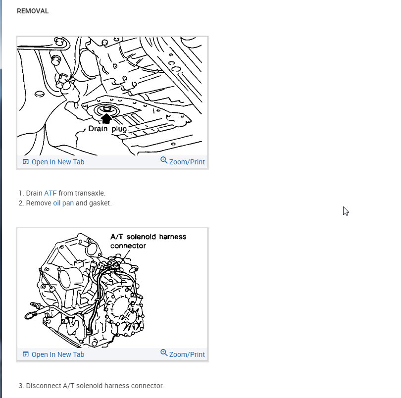

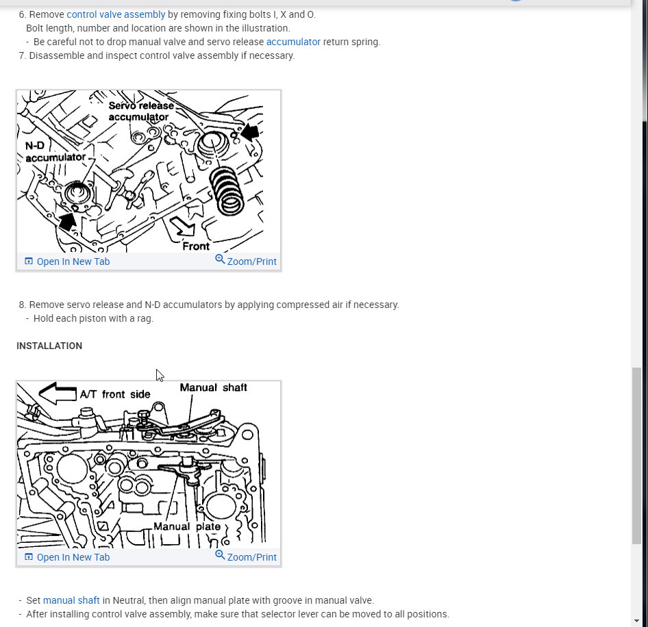

I have seen this issue a number of times in other Nissan's. Normally it is the valve body is the issue. This would actually line up pretty close to the price that you paid to fix the other vehicle.
The valve body is what controls the direction of the pressurized fluid so that each gear is engaged properly. The fact that you shut it off and it starts operating properly points towards the solenoids or valves inside the unit as they are "resetting" when the pressure is relieved when you turn the engine off.
If it were me, I would take the valve body out and check the valve operation but just moving them in the bore to see if they are sticking.
As for a shop in NC, I am familiar with the area and there is a franchise that is all over down there called Christian Brothers. They are very well run shops and would recommend them over any other.
Here is the process of how to replace the valve body in case you need it.
Let me know if you have questions. Thanks

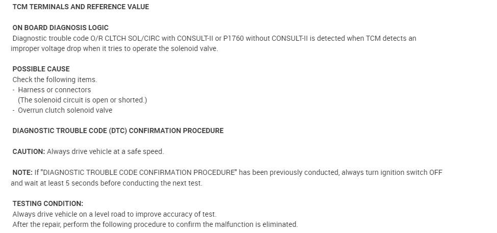

Stored code p0120.
Pending codes p1320 and p1760.

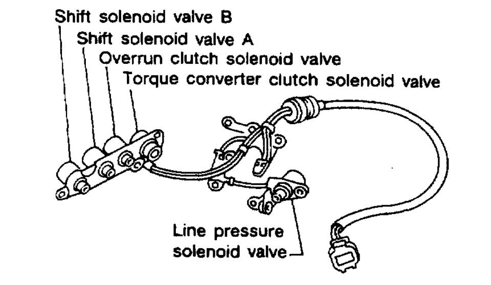

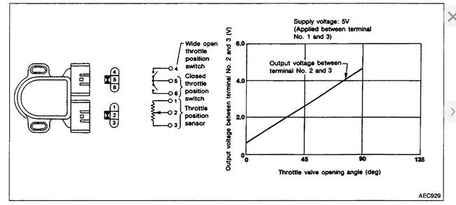

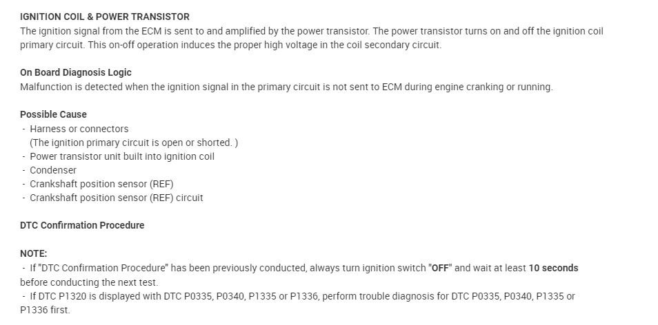

Okay, the 120 is for the throttle position sensor. This does control sifting and shift points for the transmission. You will need a scan tool to monitor the actual voltage when accelerating up and down.
The 1320 is for the engine side. It refers to possible coil issues.
The 1760 is for the over run solenoid in the valve body. It is possible that this is the issue of the throttle position sensor could be it as well.
You will need a scan tool that can read the transmission and activate the solenoids to see if they are working.
COMPONENT DESCRIPTION
The throttle position sensor responds to the accelerator pedal movement. This sensor is a kind of potentiometer which transforms the throttle position into output voltage, and emits the voltage signal to the ECM. In addition, the sensor detects the opening and closing speed of the throttle valve and feeds the voltage signal to the ECM.
Idle position of the throttle valve is determined by the ECM receiving the signal from the throttle position sensor. This sensor controls engine operation such as fuel cut. On the other hand, the "Wide open and closed throttle position switch", which is built into the throttle position sensor unit, is not used for engine control.

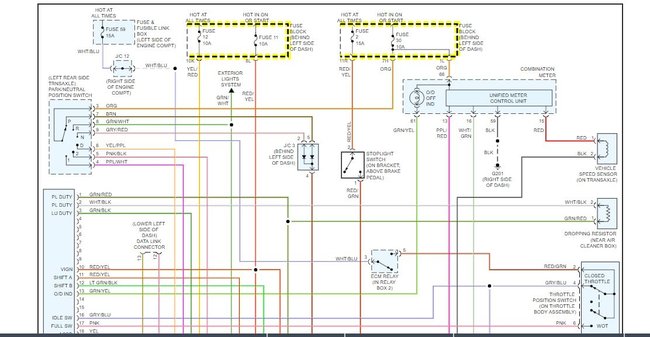

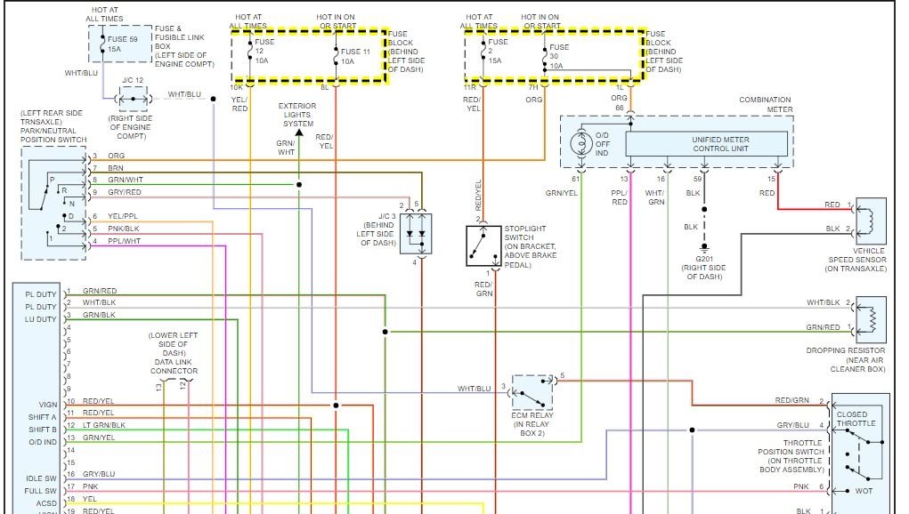

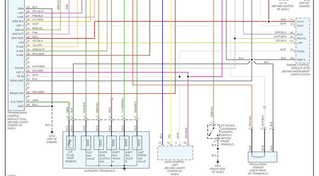

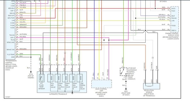

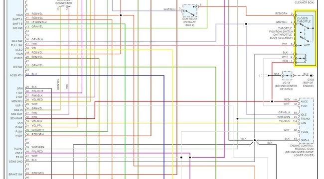

If the code is still active, the TPS was not the issue. It is most likely a wiring issue.
I attached a wiring diagram for you. Verify the fuses are good that I highlighted. This is not a visual test but is a voltage test.
