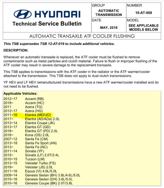

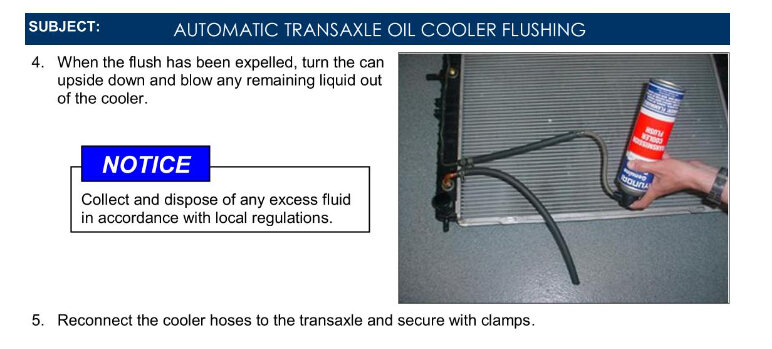

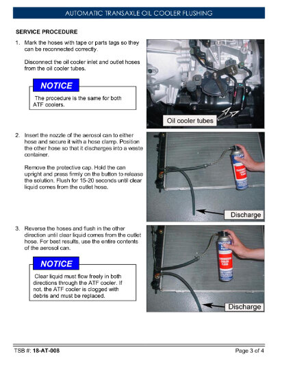

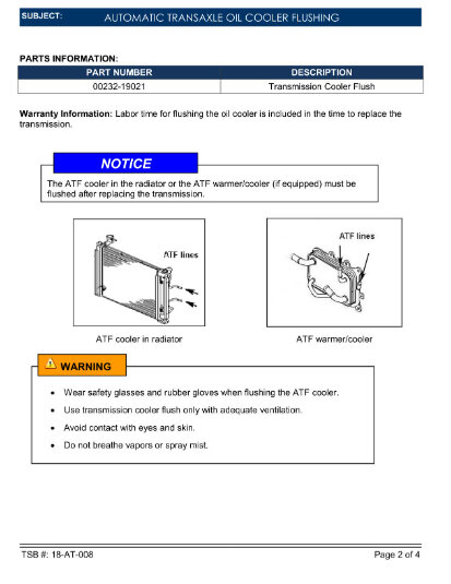

Next, there were problems with the transmission cooler getting plugged and restricting line pressure. Has the transmission ever been serviced? If it was, was the cooler flushed?
Take a look at the service bulletin below.
Let me know your thoughts and as much info as you can think of. For example, is the fluid clean, full, and without a burnt smell?
See pic below.
